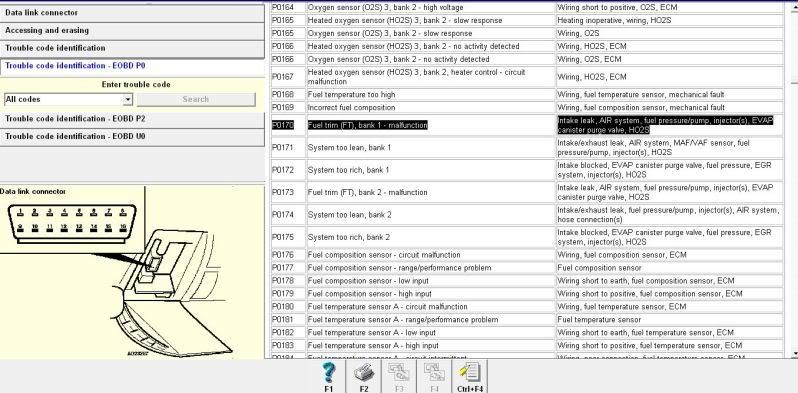

try this it will narrow down your fault code

Thanks for that table mate.
Thinking of taking it into Peugeot as it seems like it could be varied ammount of things. Any idea how much it will cost for them to look at it?
