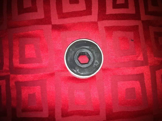

Small update.

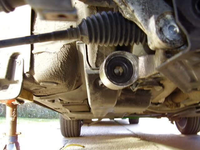

Fitted the new console bushes today, theyre uprated cupra ones and the car feels much tighter and planted now
Pressed in place!

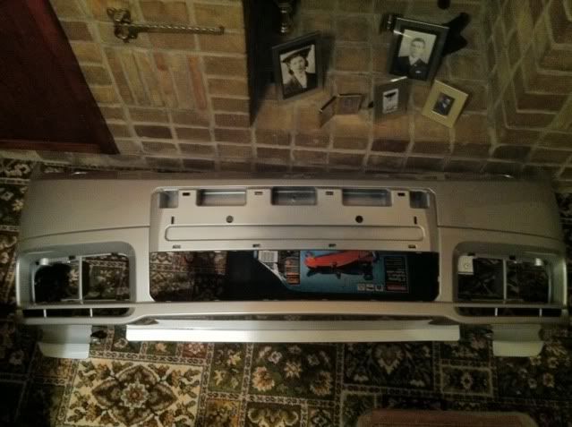

And finally as already mentioned in previous posts, the new front bumper

New front bumper is on! Looks much better without flaking paint etc!

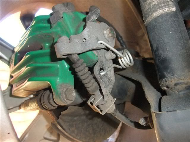

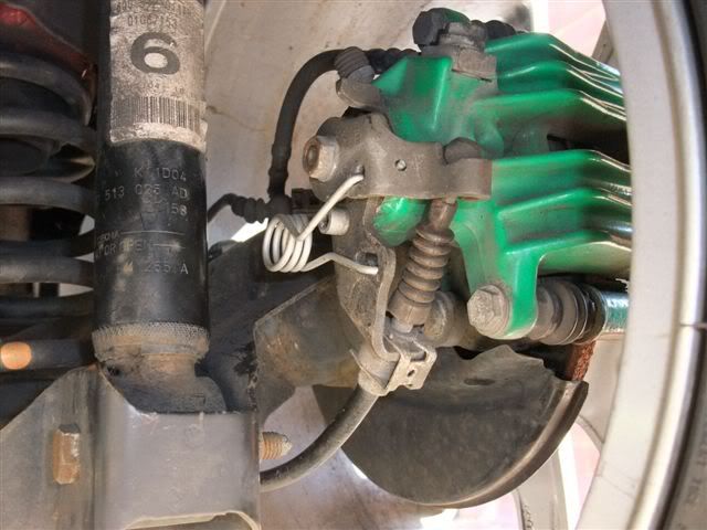

Changed both rear discs and pads as the others were completely shot and have had a few problems with the handbrake dragging.It seems the springs on the actual handbrake cable have become fatigued over time.After a bit of research i came up with the answer.Got hold of some return springs from the Audi S3 to help the handbrake return to its off position correctly.
