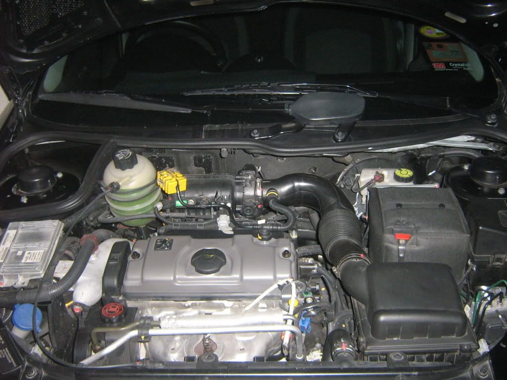

Can you show me on the picture below where you're meaning please:
Are we talking just above the power steering top below the rocker cover seal?

no mate thats your rocker cover gasket, you head gasket is just below the exhaust manifold, you need to take all the head off to replace it.
