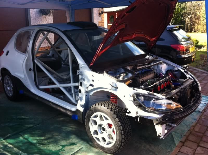

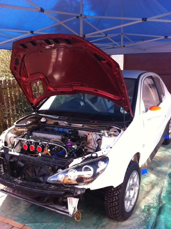

True about the wheels but the grow on you. Plus they are the best in the Market and they sponsor me and they were free Smile
PostPosted: Mon Feb 28, 2011 1:28 pm Up
Posts: 7047
So what radiator are you using? Standard hoses too?
imjeeves
PostPosted: Mon Feb 28, 2011 2:36 pm Up
Posts: 405
Location: Glasgow / Welling
Yes I lowered the radiator and just used the standard one. Samco hoses for the radiator
PostPosted: Mon Feb 28, 2011 3:00 pm Up
Posts: 7047
So is the radiator angled now? Or vertical still? We need pictures.

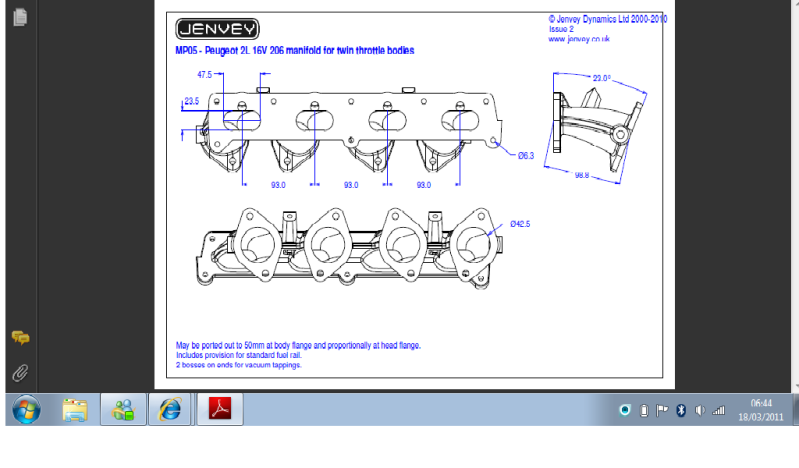

Hi Mate ,could you tell me what inlet manifold you have i got the manifold for mine with the tb kit from mtech but i couldnt fit it with pas pump in place and looking at angle of tb's im not sure i can close the bonnet.I have only started to make up engine looms so will test fit the bonnet next week.
Any help would be appreciated
also have you a connection on manifold for vacuum pipe to brake servo
cheers Brian
206 Rallycar
PostPosted: Fri Mar 18, 2011 1:46 am Up
Posts: 7047
You need the MP05 manifold to clear the PAS pump.
