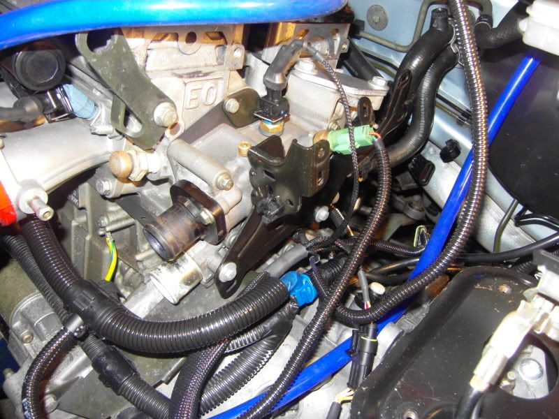

There is a brass bleed screw in the thermostat housing and one on the heater hose where it goes through the bulkhead.

The one on the hose was fine, where is the thermostat one located?

This is the thermostat housing. The copper coloured screw is at the front of it.
PostPosted: Wed Mar 09, 2011 7:54 am Up
Great, thanks!

Whereabout in the engine bay is that thermostat located? Laughing

Where the top radiator hose goes into the thermostat housing.
PostPosted: Tue May 10, 2011 12:01 am Up
Oh ok just needed a rough idea on how to find it so that should help! Thanks.
