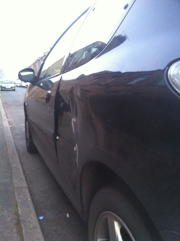

this happened in a pub carpark. the driver did a runner. ne one ne thinking on costs for repair??

that'll be a write off.
But maybe if popped out might be more workable

its a pull job and a skim over, the killer is going to be when trying to blend the paint

How bad is the door shut creased? Basically the side of the lower B pillar where the door catch ect is? It looks like it delves in at that point Sad

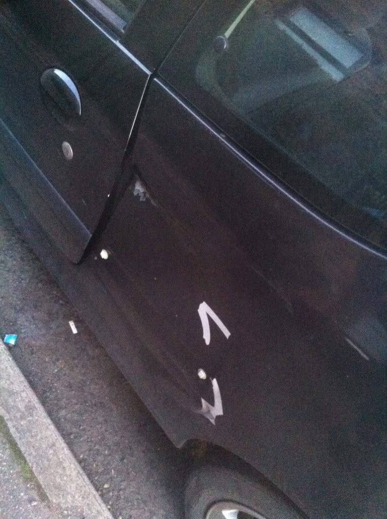

the door is fine but from the start of the door the crease starts
i had one qoute £480 then another £300 not sure what to do

300 is cheap considering the work involve to fix a rear quartor wing

It looks like a new rear quarter is needed as that crease will not be able to be pulled out.
If you go through your insurance they may write it off.

£300 is too cheap. rear quarter can be pulled out and the crease filled. the one that needs checking is the structural integrity of the lower b pillar. if thats buckled in the slightest it will be a write off i'm afraid.
