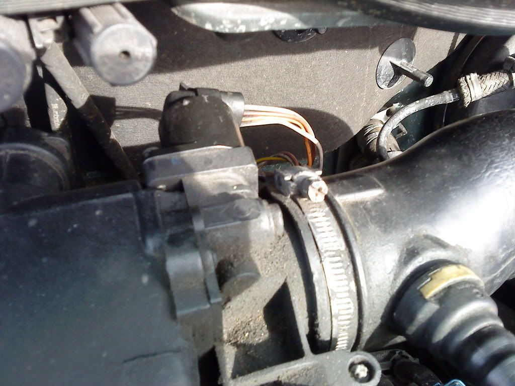

Presuming your engine looks like this, Look at the big black thing at the back of the engine nearest the windscreen (throttle body) See that black bit stuck to the back of it near where the big pipe to the right joins the throttle body? That's the idle control valve.
It looks like that. Unbolt it, get a rag, wipe it off, wipe the hole it came out of off as best you can and then put it back and it should stop stalling. Do that before replacing the coil pack. the coil pack is that thing in front of the throttle body with the grey plug (make a note of the colour of your plug as the motor factor might ask you what colour it is - grey or black)
2 screws either side. undo those. disconnect the plug and lift it out. Labour saved right there. Do the opposite to refit it
pug206lx
PostPosted: Sat Apr 09, 2011 5:53 pm Up
Posts: 838
Found a better picture
That thing is the idle control valve
