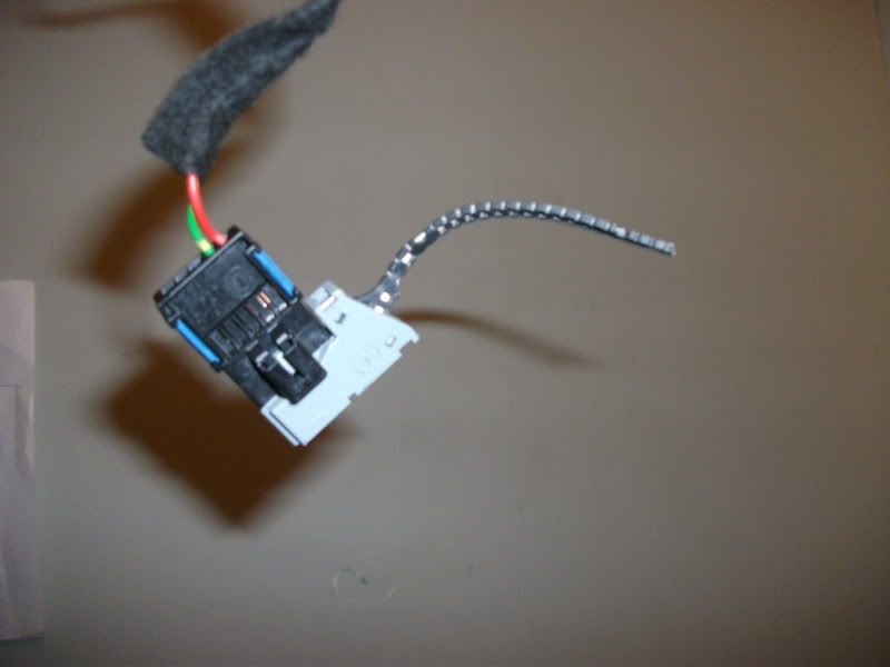

iainlovatt
PostPosted: Tue Apr 12, 2011 5:12 am Reply with quote Up
Posts: 3935
mine looked like this
(My Garage)
devildriverxii
PostPosted: Tue Apr 12, 2011 12:22 pm Reply with quote Up
Joined: Aug 01, 2010
Posts: 607
Those two are different...right?
2002 1.6 5dr Black Edition.
devildriverxii
PostPosted: Wed Apr 13, 2011 5:43 am Reply with quote Up
Posts: 607
Well, after reading your post, I had no idea what you were going on about.
But once I got the fuse box cover off I knew exactly what you meant.
Cheers for this now I have my horn back my car should now pass it's MOT...in November Laughing
