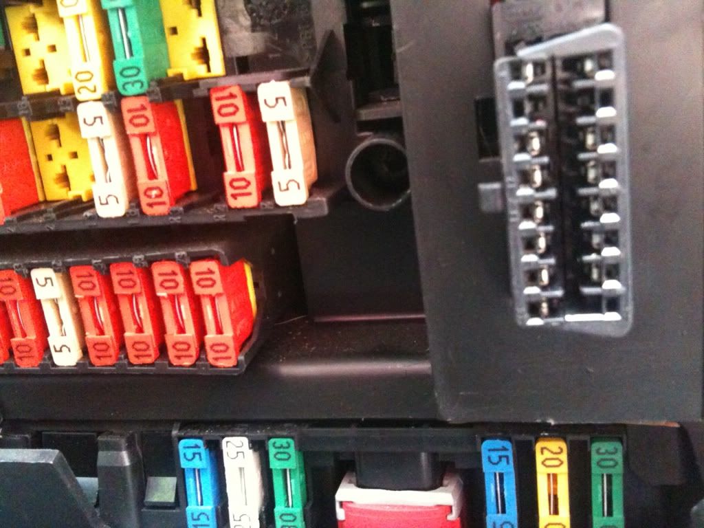

You have pin 2 (Bus+ J1850 Protocol), pin 10 (Bus J1850) & pin 8 (NC) missing. European protocols run on pins 7 & 15 which are pin 7 (K-LINE ISO9141-2) & pin 15 (L-LINE ISO 9141-2)

Hope this helps
