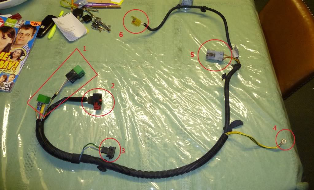

Sorry should have uploaded this before now. This is the wiring i removed from my car, ive labelled it as i understand it.
1. Relays
2. Cooling fan connector
3. Resistor connector
4. Earth
5. Main connector plug
6. Live feed which clicks into the fuse box.
The points that i was refering to was points 4 and 5. The picture on service box doesnt seem to show these. The query i have is would these be points that the wiring would include but not show them on service box or would these have to be added to the new loom.

PostPosted: Wed Apr 27, 2011 3:16 pm Up
Are you replacing the whole loom then?
They more than likely should be included in the loom
Im going to check the wires properly tomorrow, was just getting my options sorted so im not held up by this bank holiday weekend.
