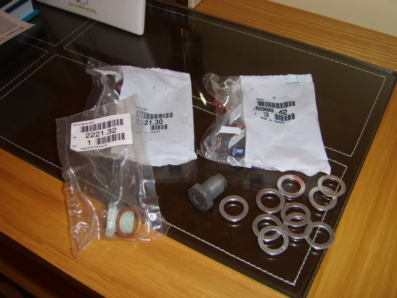

PostPosted: Sun May 01, 2011 6:45 am Up
Posts: 7047
I've replaced both drain and filler plug and the washers on my gearbox. The dealers do sell them and the washers come in packs of 10!
Lovely plugs and washers.
Filler plug.
Drain plug.

Yeah they sell them but none of them hold the stock for some stupid reason?! They are big main dealers too!
I got two copper pug ones from halfords but I think they are for the oil sump all the silver/alloy ones Edward pic shows match whats on my filler plug.
Much better pics tho! thanks.
Halfords do an alloy oil sump plug gasket for a Honda engine that looks the same can i just use a couple of these?
