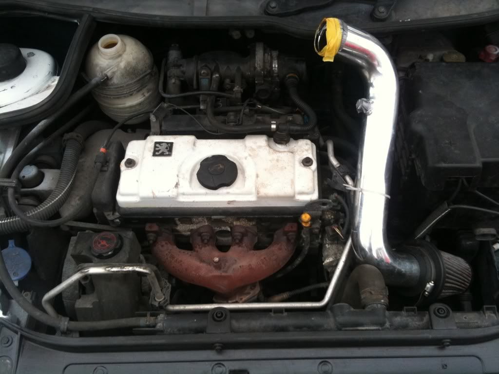

PostPosted: Thu May 05, 2011 10:37 am Up
i believe my car has one fitted?? (well did as there is no engine in car now Laughing )
i225.photobucket.com/a...e35cb0.jpg
