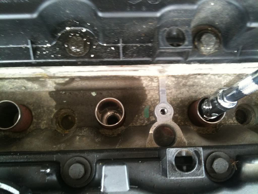

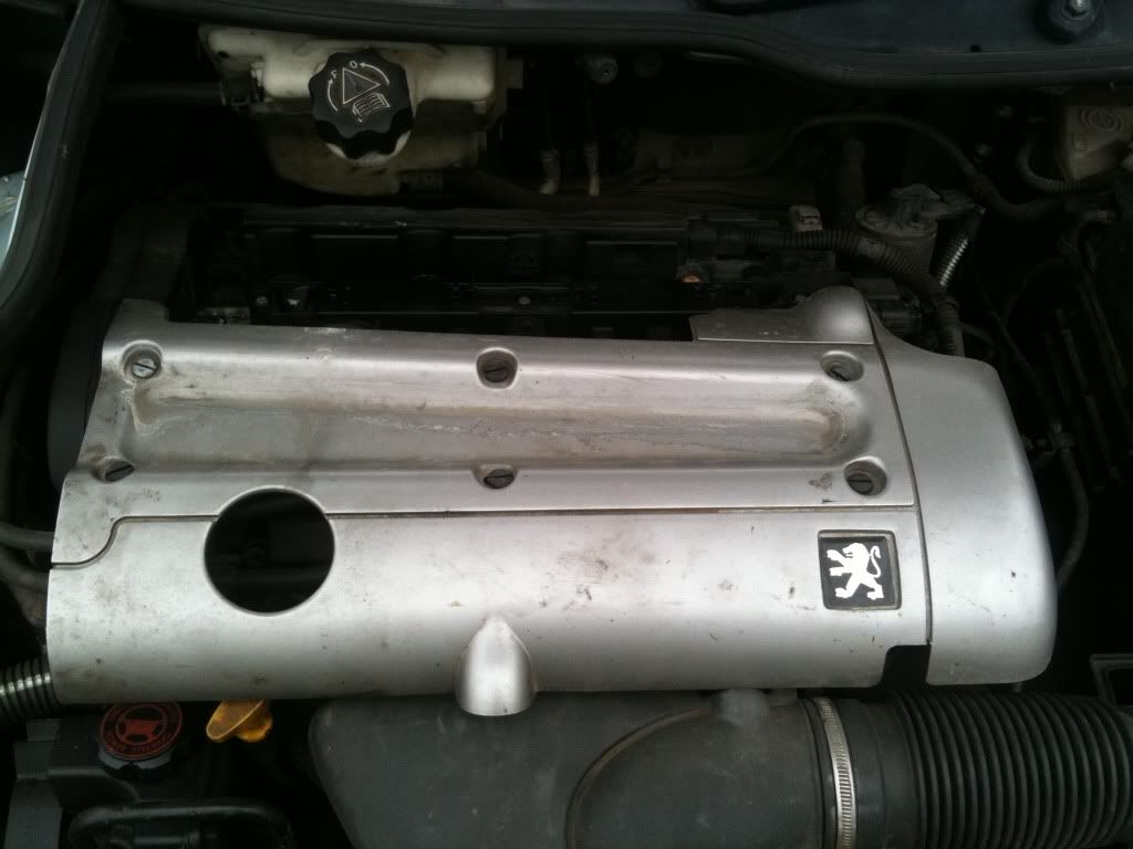

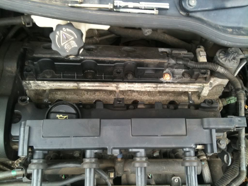

Rocker off (black plastic locks - turn them so the line is horizontal)
Coil pack out (Disconnect on the right hand side - 3x 8mm bolts on top need removing)
Take old sparks out using 10mm Spark Plug remover (Note: this is NOT a standard 10mm fitting), put new ones in with copper grease or engine oil on thread
Do it back up again.
Finish!
