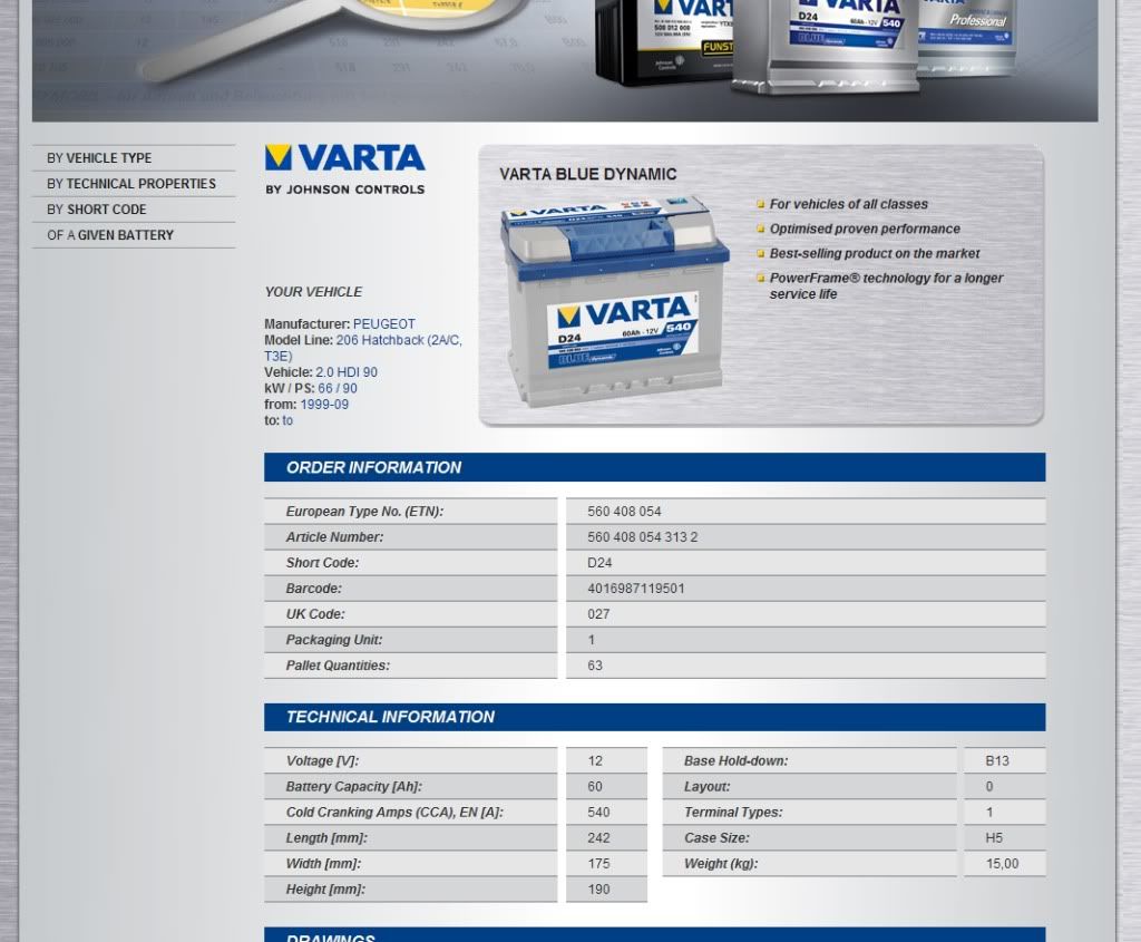

im in the need of a new battery as the car is struggling to start. Ive read a varta battery is the way to go. Which one do i need...56ah, 60ah, 61ah, or 63ah.
The car is a 2:0 hdi
thanks

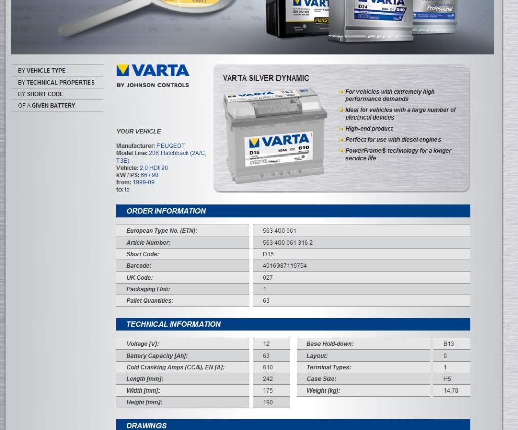

Varta D15 Silver Dynamic is the one you want.
Look out for the Bosch equivalent if its cheaper.
Varta make the batteries for Bosch so there exactly the same under the stickers Wink

why over kill?
diesel need more power to start the engine compare to petrol.
i use the same battery as well (bosch S5)

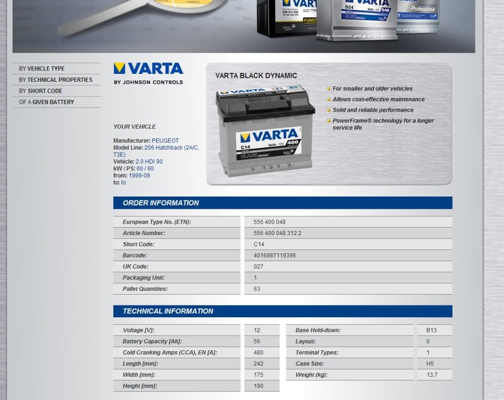

Because I've been running a Black Dynamic for years and never had
the slightest issue even at very low/extremely high temps.
Unless you are using a substantial ICE rig I don't see the point really.
