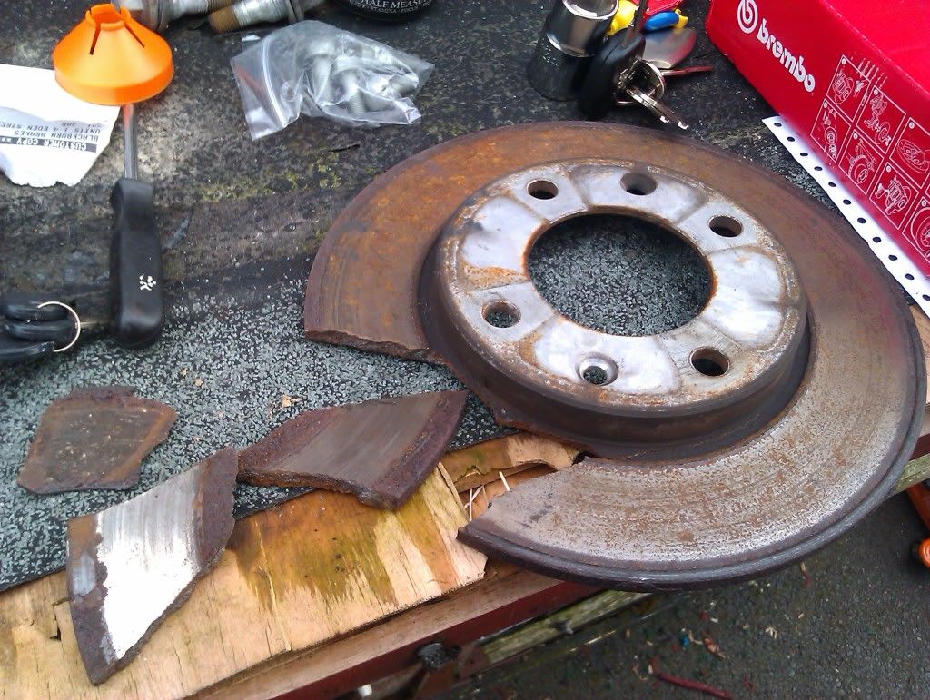

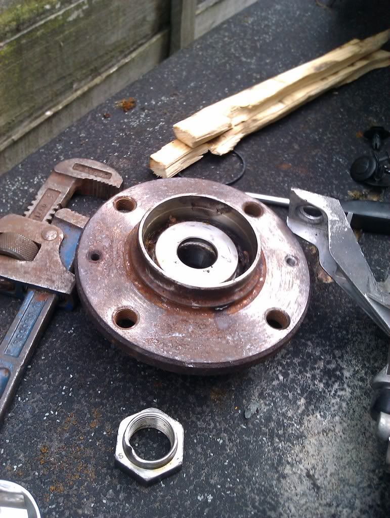

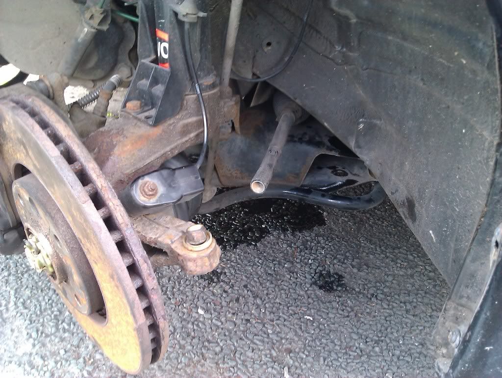

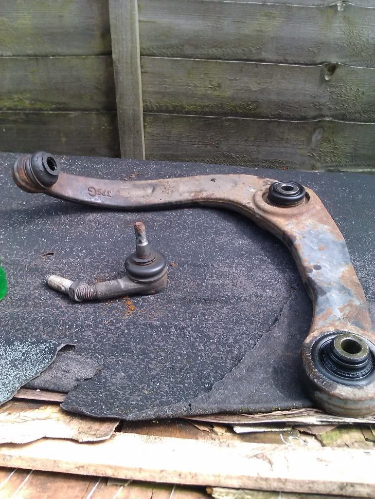

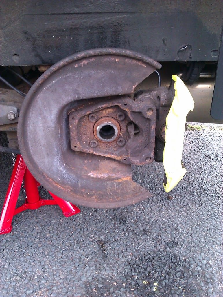

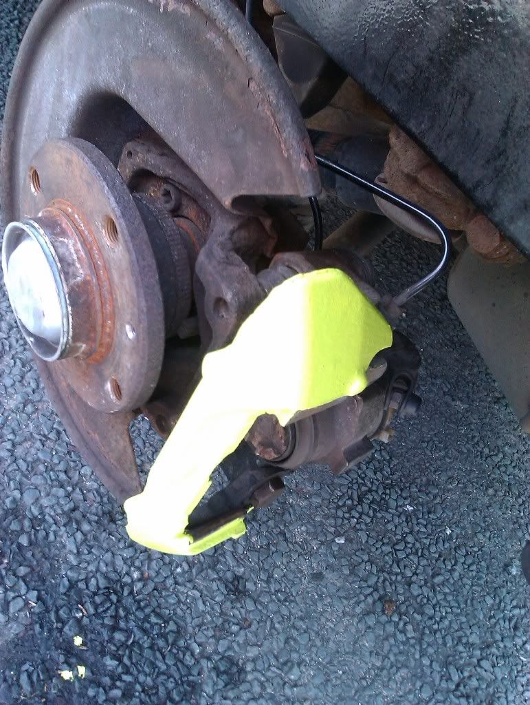

So i have kept this under wraps for like months now ha but i kinda had a crash then been away working in london and only just got round to getting to fix the car only a few people that are on my facebook knew about this and well heres what has been keeping me entertained for the past few days i will let a few pictures do the talking
Before anyone says anything the crash involved only me and was due to my bad driving this thread is not here for you to comment on how i drive but purely to show you what i have been doing if you wanna talk to me bout my driving feel free to pm me Wink thanks for looking

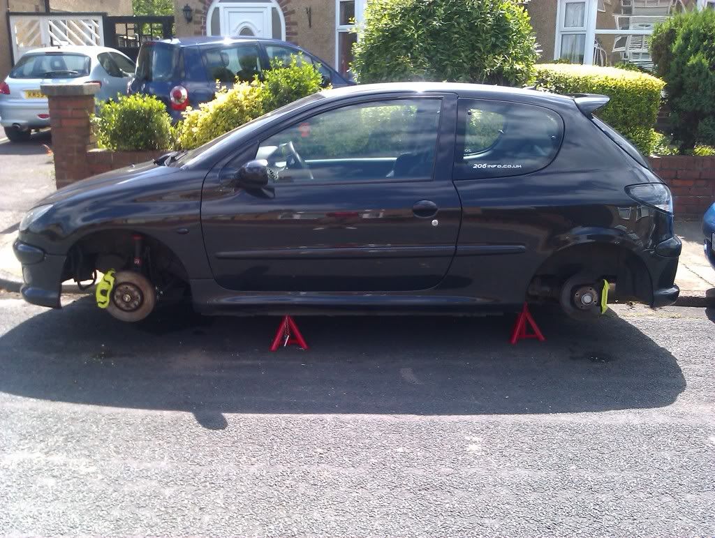

figured the calipers needed a lick of paint while i was at it and i have my eyes on some peugeot aidel alloys and my new stub axle pins is coming tomorrow so i can start rebuilding it
Lesson here dont crash your car!!!!

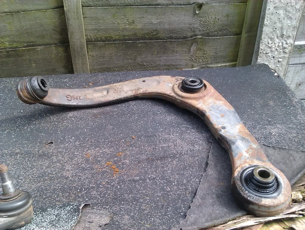

i recognize that shape of a wishbone from experience, only medium-large kerbs make that shape lol.
just a regular kerb mate at a slightly to fast speed sideways Laughing

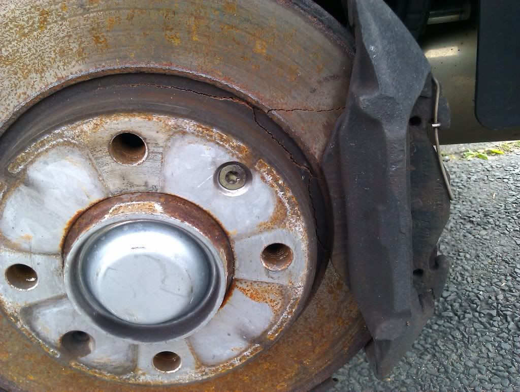

wow that is an achievement to crack disc brake in pieces like that!
glad your ok tho, could of been far worse!

Nice and straight ! The cracked disc how the hell?
drunknmunky
PostPosted: Tue Jul 26, 2011 2:15 pm Up
Joined: Mar 28, 2010
Posts: 1356
The disc cracked cause the pads had pressed on it as it slid into the kerb and there was nothing on my pads either i didnt take a pic but htey were on metal so my own bad Sad

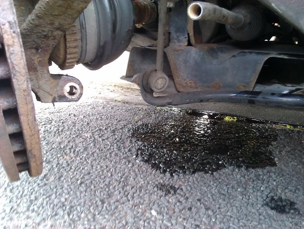

Are you changing the inner tie rod on the steering rack too as that also look's to have copped it ?
had simalar problem on the front when some numpty parked there car up and left the wheels on full lock which met my wheel on the way past Sad
it has a very slight bend to it which im hoping i will get away with as i dont fancy changing it, im told it will track up and be fine Confused
cartoonhead
PostPosted: Tue Jul 26, 2011 2:52 pm Up
Joined: Jun 08, 2010
Posts: 1035
Trade Rating: +17
there only £12.30 from Europarts and are easy to change Wink
