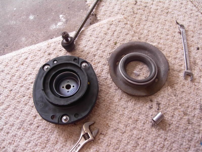

can i just get away with replacing the bearings or have i got to go for the full mount?
as you can see it can mean many precious pennies saved.

it depends on what is damaged on your old stuff....

seems to just be making some unhealthy noises at low speeds. doesnts affect handling or anything. but i guess u cant really tell until u take it all off and have a look.

looks to me the top mount rubber itself.
as the bearing does affect handling
PostPosted: Tue Aug 02, 2011 11:33 am Up
Posts: 7047
Unless it's 10 years old and worn out.

ha yeah ill probz just get the mount and be done with it
2001, 206 1.4 lx first car Very Happy
PostPosted: Tue Aug 02, 2011 11:35 am Up
Posts: 7047
Do the bearings too.
comes with bearings no?
www.eurocarparts.com/e...amp;000346
PostPosted: Tue Aug 02, 2011 11:42 am Up
Posts: 7047
Those are the bearings in the picture yes.
Yes, the smaller part is your bearing,under that the upper spring seat.The rubber part is your upper mount in plate.

So I'm guessing that it's a case of replace the bearing in the spring seat. Then placing the upper mount plate onto. As I'm guessing those 3 bolts are the ones I can see under the bonnet. And in this picture it's upside down.
