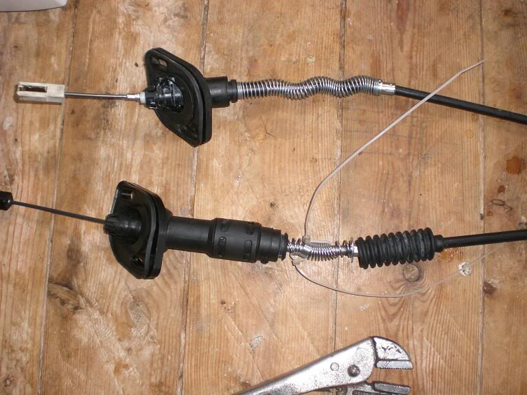

I can't promise this will work for you as I've only been investigating the mechanism this morning out of morbid curiosity but you can pull back the waterproof cover to gain access to the spring.
Old cable above, newer cable below with waterproof cover pulled down
With a strong hand and couple of tie wraps you can compress and hold up the spring, I put two on here, doing it in stages. This is doing the same job as the absolutely super plastic spring retainer of course Very Happy
This will take the tension off the vice like crab pincer which actually grips the inner cable. See the black kind of one way lock that grips onto the cable? What a crack pot design, you want a free running cable so let's clamp a vice onto the inner cable!
Now you may be able to pull the inner cable at the clutch end which will slide the vice up the cable to get the free play you need. Don't go taking it all apart like I did just to see what's in there
Of course, once it's all fitted then cutting off the tie wraps would be the same as breaking off the high quality, super designed retainer
Like I said though, it's all theory and I can't promise for how that will work in practise. It's easier with the cable off the car but trying to do that in situ would be a nightmare
