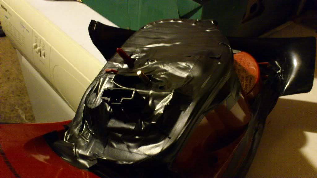

Hmm well i seem to have screwed up refurbing the glass of my headlights i have in fact made them more clouded rather than less, there not completely screwed as when wet or have glass cleaner there crystal clear but then it dries and they look terrible Sad Looks like i need a couple of higher grades of sand paper. I'll get some pics up in tomorrow or in a few days and see what you guys think i need to do to save them (i've lost my phone charger meaning i can't take photos since my supposed super high tech phone can't hold enough power to last more than 2 days...curse me for leaving the wifi on constantly Confused ).

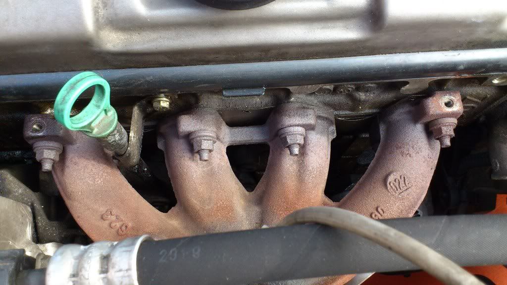

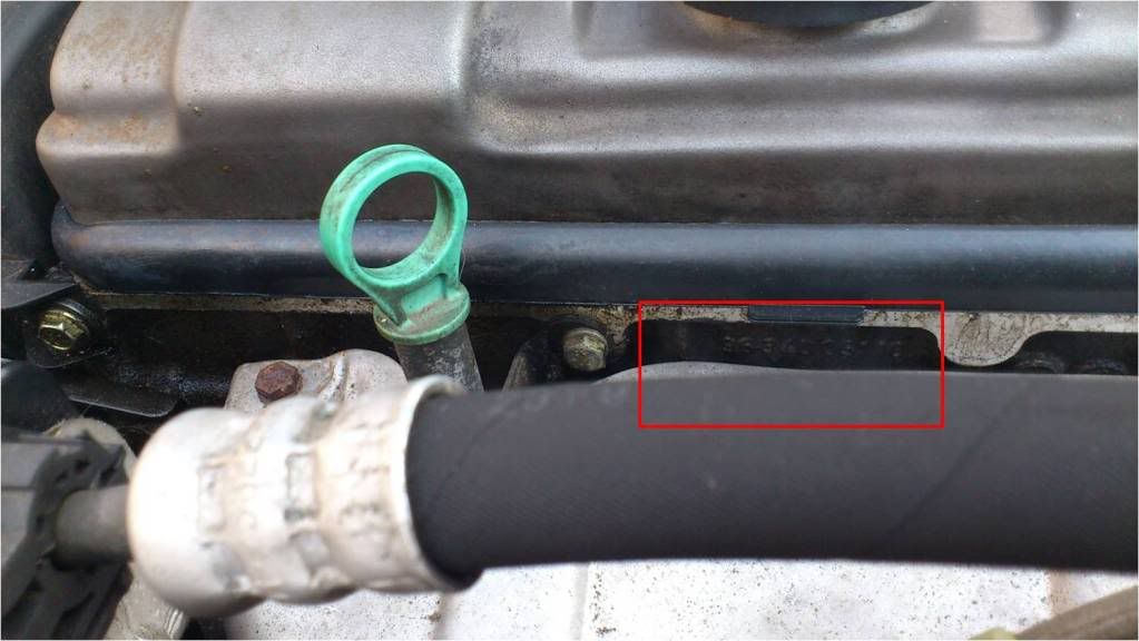

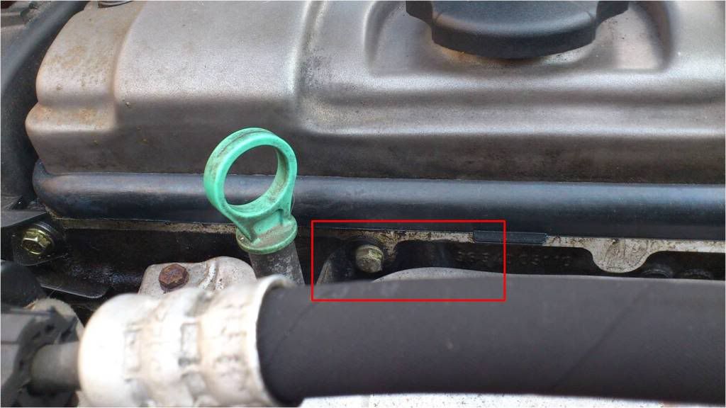

Second Problem!: My car seems to have developed an exhaust leak, so after starting it up, everything was fine (still very very quiet, i was expecting it to run a little rough for the first minute or so, so this was a nice surprise) until the engine came up to operating tempreture i noticed white smoke coming from the engine, at first i thought it might be water but i gave it a sniff and it smells oddly like exhaust. DOH!!! Now i'm having some issues locating the leak, it seemed to be coming from the 1st lambda (blow the smoke away it appears first there, and at the back where it bolts to the engine), since smokes hard to find there's a few pics below of the same thing to point out where its coming from on the engine side;
So anyway i went to tighten the lambda only to find it was already tight (got my dad to try too and he found it tight), so i went about looking for another leak, now this is where you guys come in does anything look out of place in this pic below?
Now a few notes on this issue, the heat coming off the exhaust is different in different places, on the lefthand side the heat coming off is hotter than the right (now i'm thinking this maybe because of the dipstick), also i thought it might have been the oil from the old leak which i fixed but also when i think about it, it wasn't doing this last time i started it so i don't think it is the old oil. Oh and you can't see the smoke very well once the heat guard is off by eye so the phone was definatly not going to pick it up (i'm guessing the heat guard was acting as a dam, building it up until it escaped out the sides.

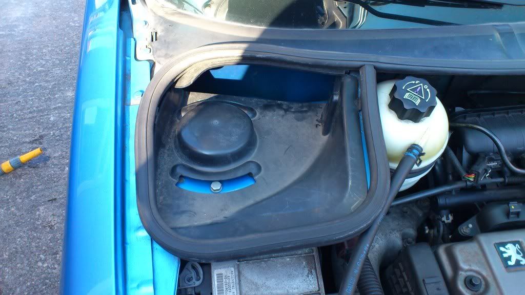

some better news though, i finally figured out what was wrong with my rear washer, after getting the third brake light off with a bit of brute force Wall Bang i found there was a kink in the tailgate (why do french cars play up in areas you can't physically reach?), it's now working well and it's one more thing ticked off my to do list.
Also while checking the pump i found i have new brake pads on the car (shame the standard brakes fitted to this are pants, maybe they need bleeding, but they didn't really feel spongy or anything).

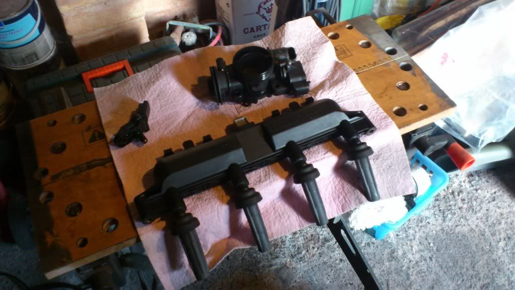

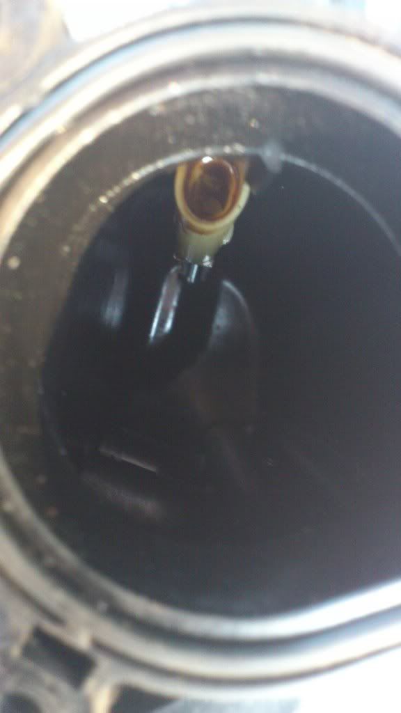

So on fridays post i mentioned the throttlebody being caked in oil, see below;

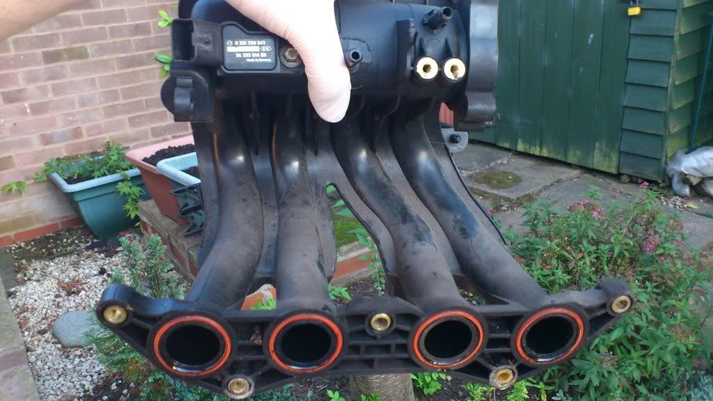

So anyway i decided to go about cleaning it, after about an hours worth of undoing, tugging, finding something else connected at the last minute i finally got the inlet off to find behind it 10 years of grime... I guess i should clean this up before i put the mani back on..
And heres the filthy thing Thumb Down :
Now it doesn't look that bad on the outside, apart from the oil around the rubber gaskets but when you take a look on the inside it's caked in oil and general dust which the filter didn't stop (sorry it's hard to get a decent pic with something like this);
So on with the cleaning, the tools of choice? a hose pipe, engine degreaser (spray can style) and wd40, 10 mins later and look at the water Confused ;
Now i was abit stuck on how to get it dry, i was already planning on just leaving it a day but i decided to give it a helping hand by using my paint equipment..
Final Fase of operation inlet clean, all the sensors and throttlebody was cleaned (along with the coilpack since it had to come out to get the manifold off;

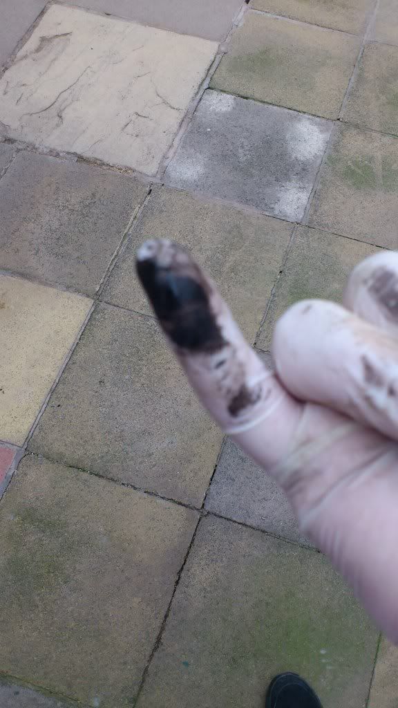

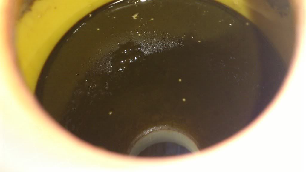

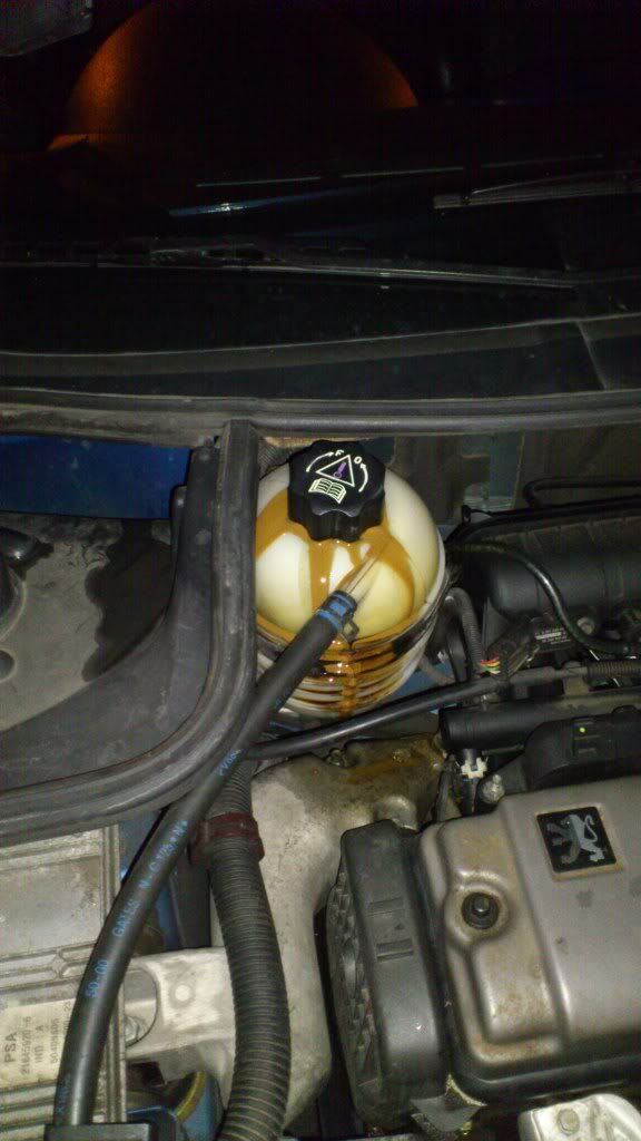

Now some bad news, i'm praying this isn't what i think it is but look whats in my coolant reservoir.. Evil or Very Mad
It's a really dark and murky, but it doesn't exactly look like oil either, are there any other things this could be other than the headgasket? The only other thing i've heard is when 2 different types of coolant get mixed together, dunno how true that is though.

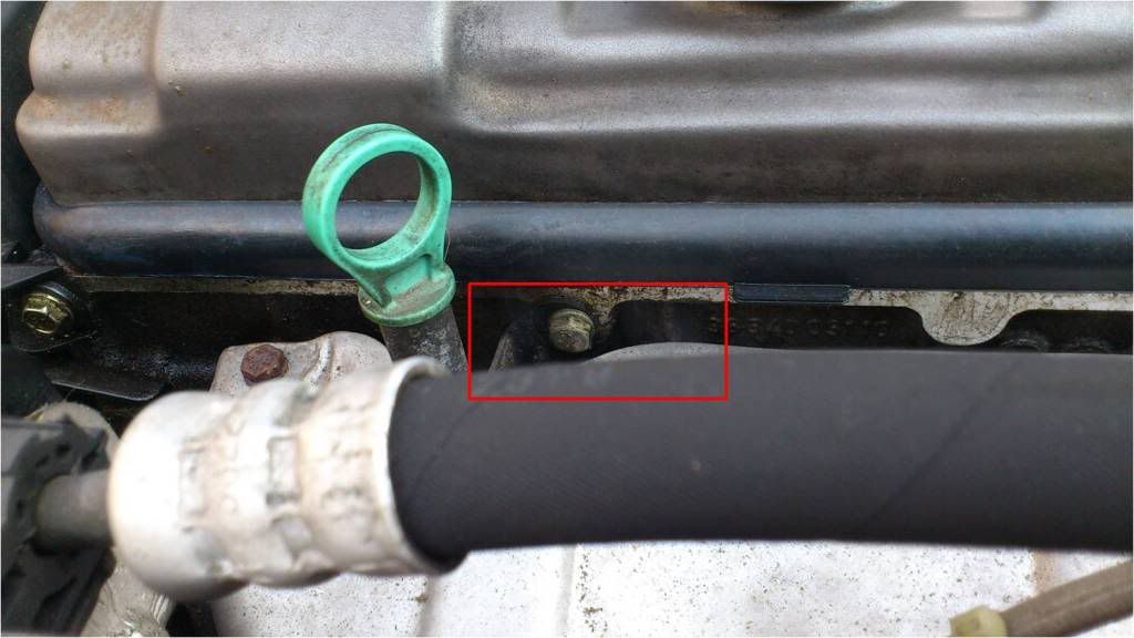

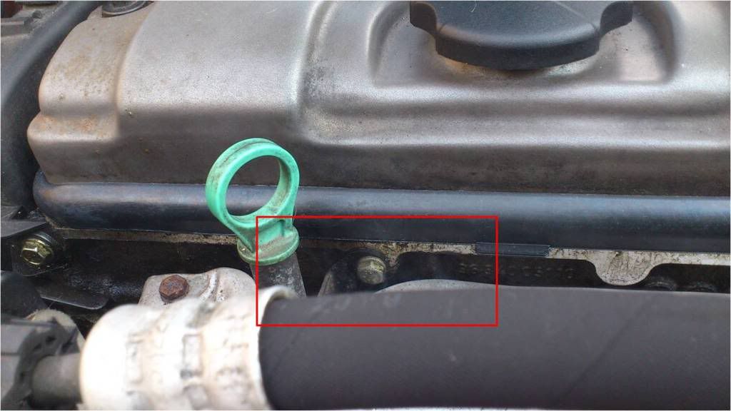

Oh and one last thing, how do you remove this part of the induction piping?

Is it the box you are trying to remove? Look to the right and it will be secured onto a bracket which the box clips onto at the top. I don't have this air box system but that is how mine is, you just push the clip and pull upwards.
If not, you may want to get the passenger arch liner off and try from there, as with this box setup they have an air feed duct going to the arch liner
I shall give that a try tomorrow, thanks for the advice.

So after discovering the oil in my already sludgey coolant, i decided to be proactive and try some of the wonderful Holts Radweld;
Now this stuff worked miracles on the Clio Sporting, when that was drinking a litre of water a day i decided to give this a try and it stopped the leak completely, and this was after we took it to a garage who couldn't find a leak even with there ramps leaving it running, the headgasket was checked and that came back fine so that was a total mystery (although my dads new renault is doing it too, so i dumped some in that too).
Unfortunatly it's too early to tell if it's stopped the leak as my coolant system needs some serious cleaning (more on that later).

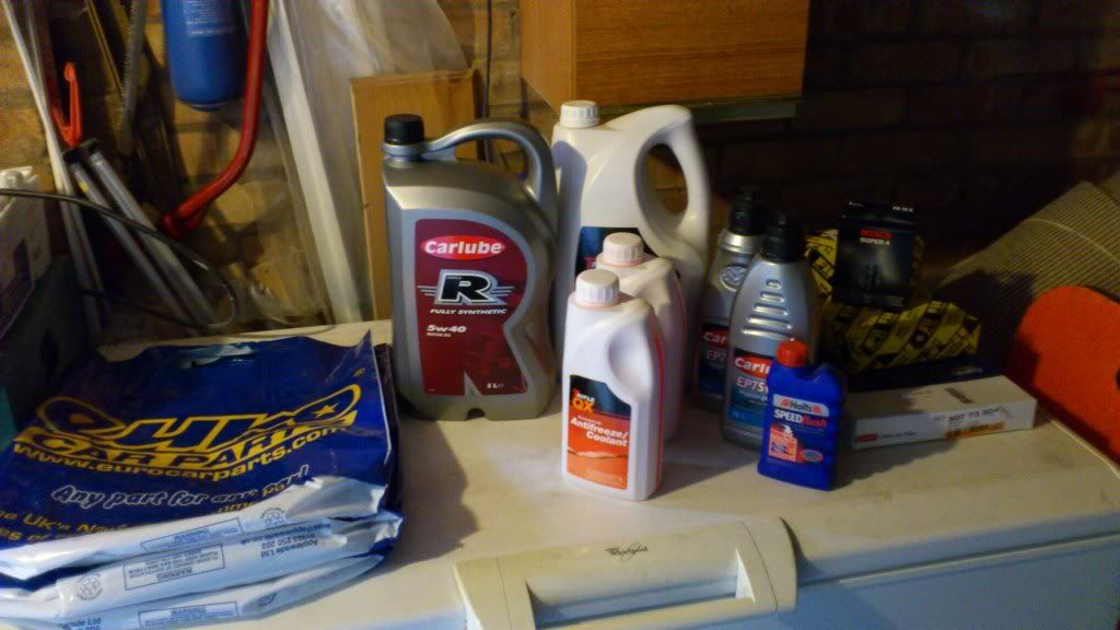

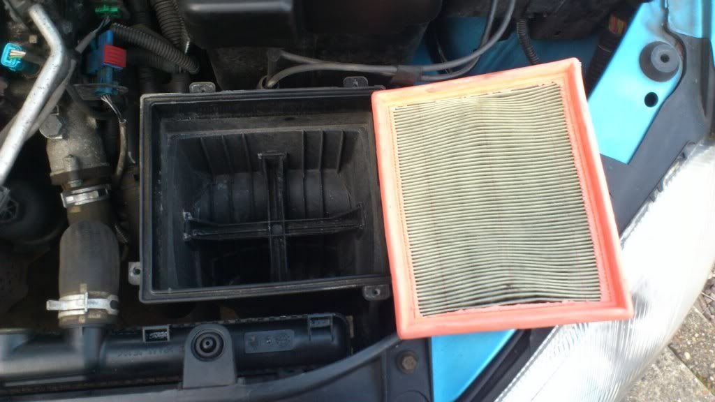

So i decided to get my servicing gear and service the little pug, today is a good day to be fair student finance comes in and eurocarparts have 25% off at the moment (code crazy25 i think, click engine parts and the banner tells you), i decided to pick up the stuff and my god tamworth customer service is slooooooow, they only had 1 person on the desk and when it was my turn they didn't have the parts ready for me like they said they did, but hey ho i only paid £99 for something that should have cost me around £120-130;
So what do we have here?
- Guttmann Oil and Air Filter
- Bosch Super 4 Spark plugs
- Denso Pollen Filter
- Carlube Triple R 5w40 Fully Synth 5L
- Triple QX Red Antifreeze and coolant 5L & 2* 1L (turns out it's not premixed though so i have enough to do 2 changes, perfect! explained later)
- Carlube Gearbox Oil 2L
- Holts Speedflush
- Top Tech 12v Digital tyre pump/light
So nothing really much to say about the majority of things, the pollen filter was pitch black on one side (guessing it never got changed, but the burning smells gone now), the oil filter was left unchanged (couldn't get the plastic black housing off without breaking it, need a bigger socket to fit over the top, it's too tight to undo by hand), thats about it in terms of regular stuff.

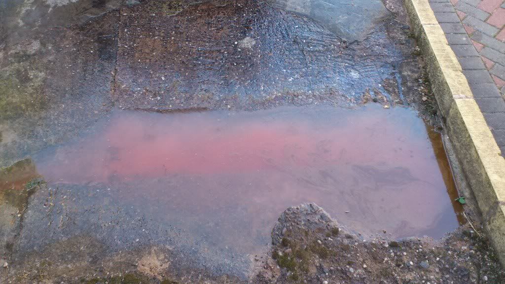

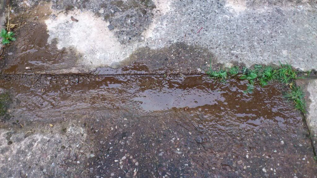

Now when it came to changing the coolant, my god er you should just see the pic instead and no that isn't dirt in the pool of water/coolant...
Lots and lots of brown sludge, now i must not have done this properly, i heated the engine up to operating temp, heater on hot, fans on, took the bottom rad hose off and then push clean water through the reservoir. Refilled the system (weirdly it only took 1.5 litres of water and about 2 litres of coolant so i cant have got it all out), bled the system on the 2 points i could see, took it for a drive and there is more brown sludge but i plan to dump the speedflush in on thursday, go to uni come back and redo the coolant.
I do have to say though that even with the coolant still iffy, now that my car is fully serviced it pulls even better and i thought it pulled well before, damn Kwik Fit overfilling the oil.

- Drivers Suspension Strut Cover (to stop water build up on the strut on the 206's flawed design!)

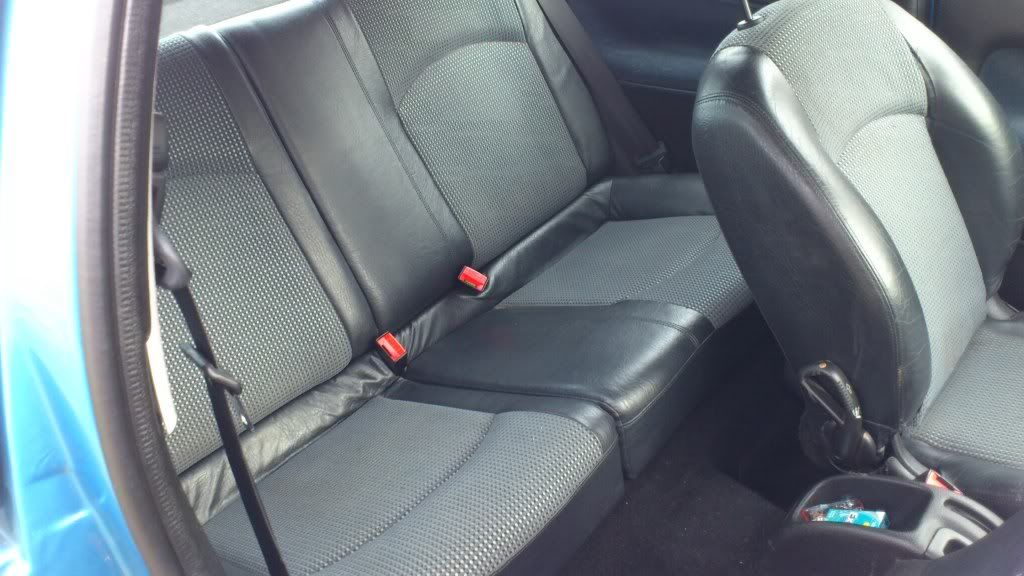

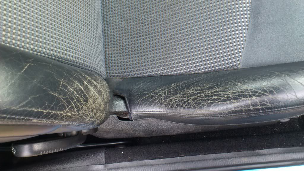

So heres a small update, for the bargain price of £72 i have won myself some Leather/suede seats from a Gran Turisme thats been broken not a GTi so thats a nice surprise considering i already got calipers off a GT. So here they are:
There pretty much perfect except for the cracking in the leather as seen below (on both front seats):
Now i did win the door cards, and glovebox to match the seats but i decided against it since the blue ones match the actual car rather than the grey ones (they'll be up for sale on ebay soon along with the old seats if anyones interested in them, there pretty much perfect, only need a clean. And the old seats the drivers one has a slight tear, i can email pics to anyone interested).

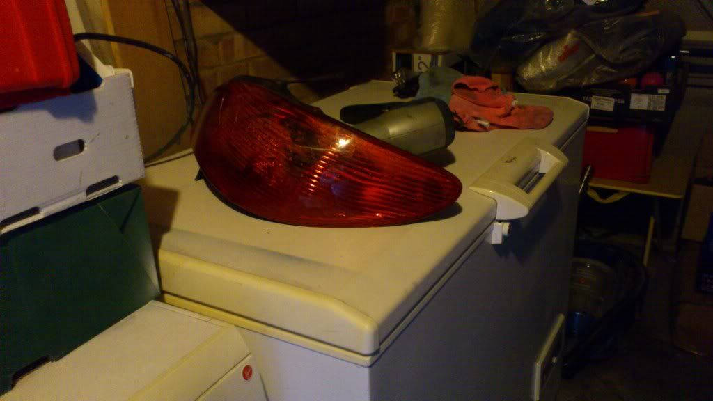

My new rear lights arrived which i won on ebay to replace the older style rear lights (or what i like to call, 106 lights made to fit the 206, same horrible style).
Old:
Halfway through:
Done:
Only problem with them is i lost the plastic screw which holds one of them on down the hole below it...

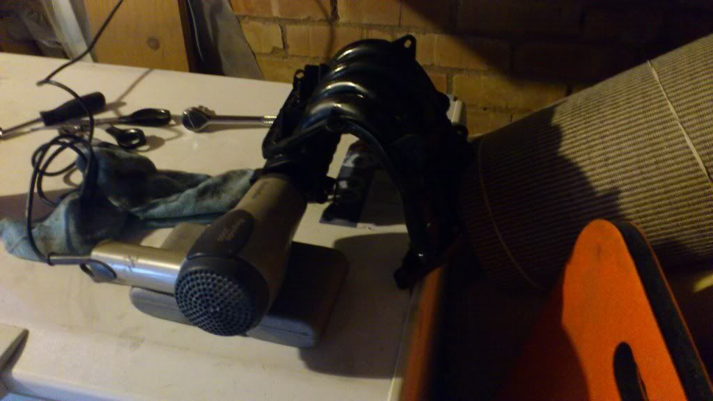

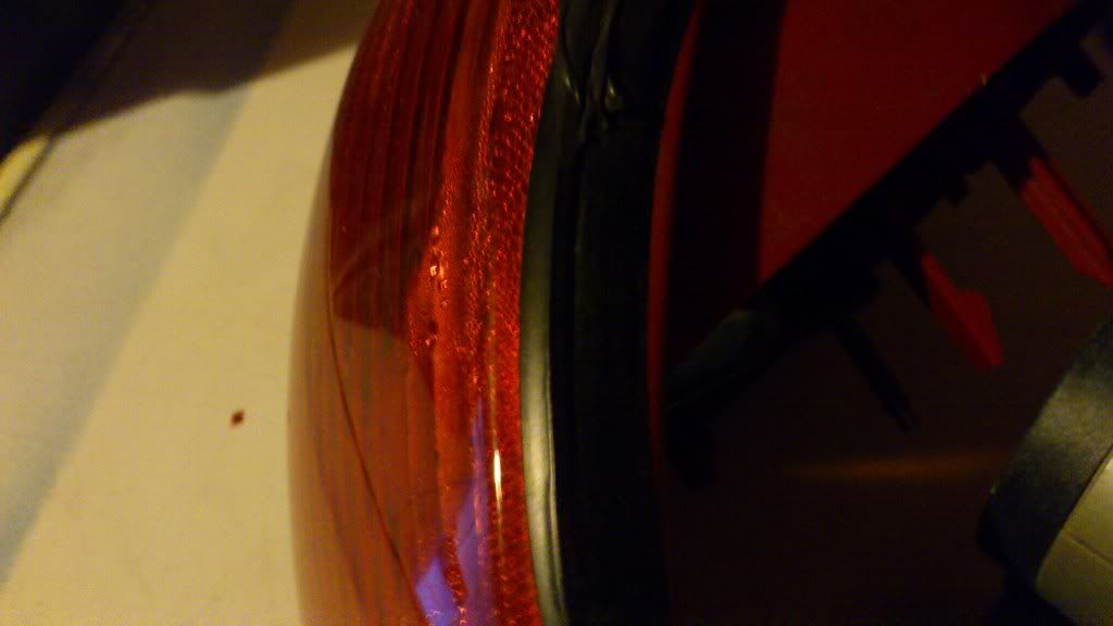

First off my rear lights have developed a problem well one of them, condensation won't stop building up, see below; Confused
It's taken a good 4 hours with a hair drier blowing air into it to dry it out, once it was dry i got abit drastic with electrical tape
Yeh that should stop the condensation right? Laughing

Went to check my oil while i was waiting for my friend to get here and unlock the door to her new house and look what i find (it wasn't quite this bad when i opened the bonnet, this was after i opened it slightly only to find it starting to overflow, never done that before even when the engine was hot)...
Thought great do i have enough oil to get home since this is clearly my headgasket gone? Pulled it out fine, wipe, go to push it back in only to find it wont go back in (granted its abit of a pain with the way it is anyway but it always went in fine before), eventually with a bit of wiggling it went in, pull out to check and look... Evil or Very Mad
It's snapped clean.
So now i'm left with a choice since the cars now officially off the road till january, i can either have the head gasket done, swap my engine out for a newer 1.4 with less mileage (i'm assuming multi-plex engines are the same except the wiring?) or since my friend is getting some money soon and buying a new car i can always buy the clio sporting off her since she's only going to part-ex it anyway.

Anyway so i left it with the head gasket blown, well i had that fixed back in December for £425 and thats for everything labour, new gaskets, new cambelt, oil, coolant new dipstick and a 500 mile checkup which it passed with flying colours. but during the 500miles to the check i broke down 1..2..3..4, yes 4 times in the space of a week, twice the RAC had to be called out, so the list of problems that happened are below.
- Got the car back on a friday
- Got halfway to uni on monday and the EML started flashing and running like a dog (engine shaking crazily like an engine mount failure), fault codes read and it came up with an intake temp sensor failure and a suspicious single/multiple misfire. Turned out to be the coilpack.
- Tuesday...halfway to uni and the STOP light started flashing, looked at the temp gauge and it was showing 120c, got out felt a pipe and it was cold, turned engine back on to find it sitting at 60c (bear in mind this was only 2-3mins after the warning light)
- Wednesday...driving around i notice my car was sitting constantly at 60c, taking 20-30mins from 60c to get up to 80c only to have it drop straight away as soon as moving, thought my thermostat was stuck, go to fit a new one and whats this? THERE IS NO THERMOSTAT, I'VE BEEN CONNED!
- Thursday... driving home from uni and i lose all power, open the bonnet and what oh what could it be boys and girls? Petrol sprayed all over my wonderfully clean engine, the fuel line that connects to the rail had popped off, pop it back on, try and wash off as much petrol as i can with the little water i had in the car and set off again, lose all power again, check engine to find its popped off again resulting in another call to the RAC, after about 30mins of him trying he eventually got it to stick on properly (aparently it's a 2 click system, 1 seal, 2 lock, i only did 1 click).
Yer 2011 has been a bad year for me...

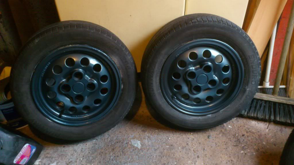

Anyway roll on 2012 and it's that time of year, time for the dreaded MOT but surprisingly it looks like times are looking up dropped it off, came to check up on how it went and it passed with only 2 advisories and there really petty considering this time last year my 106 failed with over 10 advisories. The 2 advisories were Rear wiper blade split (FIXED), and rust on drivers front suspension (surface rust, nothing bad). OH and the the new mot certificate is cheap and tacky, i could remake it in word and it would look legit on a piece of cheap asda a4 paper.
Anyway with only 1 advisory left to fix i figured that now would be a great excuse to get some goodies, so i managed to pick up some Apex 35mm lowering springs with shock absorbers from an 03 206 for £30 (springs have only done 2k, and the shocks are in good condition so chances are there going on the car and the old ones are being sold).

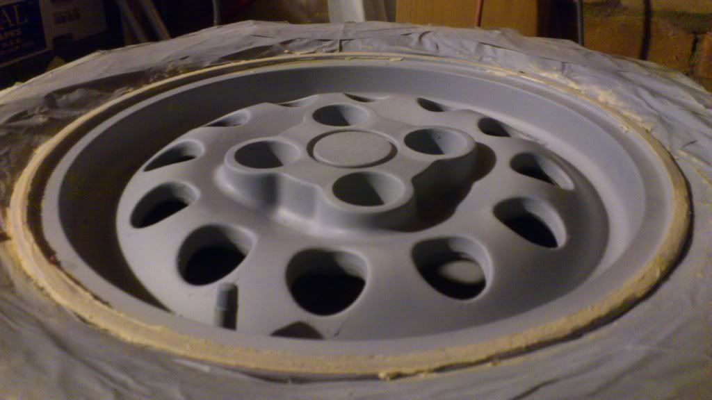

Now i know what your thinking, whats the point in lowering when you have those aweful tacky trims, well i treated the car to new shoes too, welcome some 205 Speedline SL201 also known as pepperpots, got them for £50 with 4 good tyres (2 new);

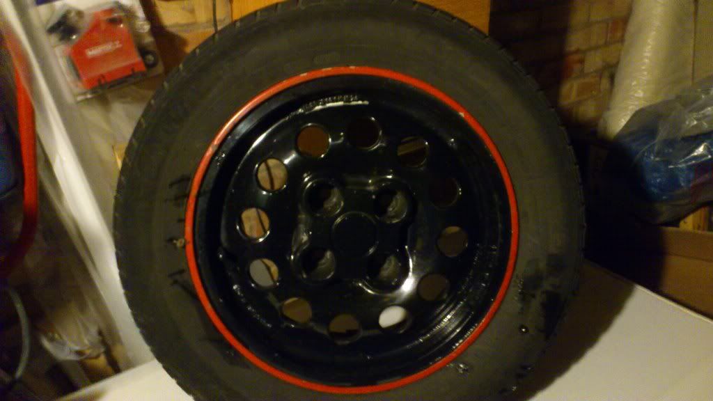

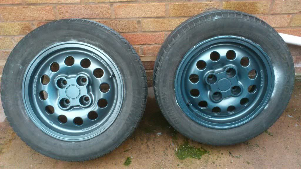

The paints flaking off them but structurally there is nothing wrong with them, not even curbing, the next few pics are of the refurb stage (only done 2 of them at the min and i may respray, i'm unsure at the min i'll explain later), so pic number 1 is 20 mins after jet washing i didn't think it would work but it worked surprisingly well;
The rest of the paint refused to come off with hand sanding using 400grit paper so i resorted to my new toy a Dremel 4000, now i bought this for modifying my new computer case ready for the new computer i'm building but i have found many other uses for it, the only problem with using this it seem that the alloys arent hard enough to cope with 35,000 rpm, and started leaving marks on the center so i decided it was good enough but it was too late the alloys put up a fight and melted my extension cable
Anyway next up was the priming stage, one of the wheels i've done had a chemical reaction on the rim and no mater how much resanding, it kept coming back (looked like it was cracked), in the end i cheated with filler...
After saiding that down and reprimering the rim, i finally moved onto the paint stage, but what colour? Ford Graphite Grey with a hint of Bleu Tivoli (aka colour coded paint), now the pictures below don't really do the colour justice i think it's the lighting that throws it off as they look greenish in the images for some reason, but there more blue, i'm unsure anyway i'm thinking of going over it with grey to return it to Graphite Grey (when i can be bothered to do the other wheels i'll do a side by side comparison.
Inside
Outside
By the Car (please excuse it, it's filthy)
As i say i'm unsure on the colour, at times i like it and at times i'm unsure. Oh and one other thing i don't suppose you guys know what bolts these take? Everywhere i've looked/asked people have said flat seated bolts (same as the 205 1.9 speedlines) but the holes on the inside are flat but in the center where the hole for the bolt itself is it seems they require a taper so i'm unsure and i sure ain't buying 2 sets of bolts considering there £30-40 for a set.
Think thats about it, all that i can think of anyway, cya.
