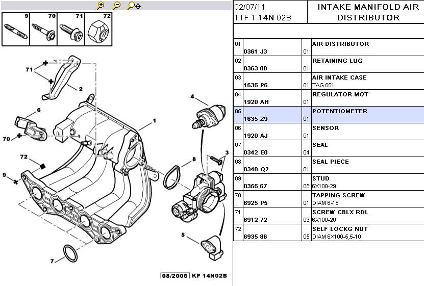

Stepper motor is around the back side of the inlet control valve. Find where the throttle cable attaches to the ICV and then look around the back of that. It's just held in with two bolts. Remove it and clean the valve end
Look on eBay for stepper motor picture so you know what you are looking for
Sign up to Peugeot Servicebox, (google it) it's free and will give you lots of diagrams and component locations specifically for your car

Don't take the ICV off, the stepper motor is just an attachment, a small part of the ICV assembly.
Item 4. Just two bolts and it's out
