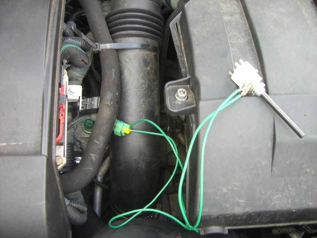

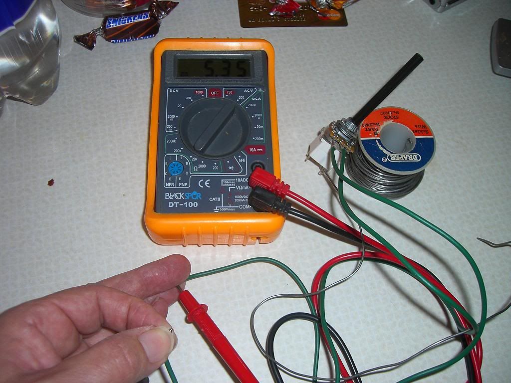

You can easily make an ETS simulator with a variable resistor with a range from 0 to 20k ohms. With this you can simulate all engine temperatures and test whether your rad fan turns on at the right temperature without taking your engine to high temps
20k variable resistor with wires attached. Just play about with it until you get the feel of how much to turn the variable resistance pot get the resistance range you want. You can buy these at Maplins or online for £1
With the resistance set at ambient temperature (use chart below) Then install your simulator in place of the ETS ( pic isn't a Peugeot)
Here's a typical temp v resistance chart for an ETS
