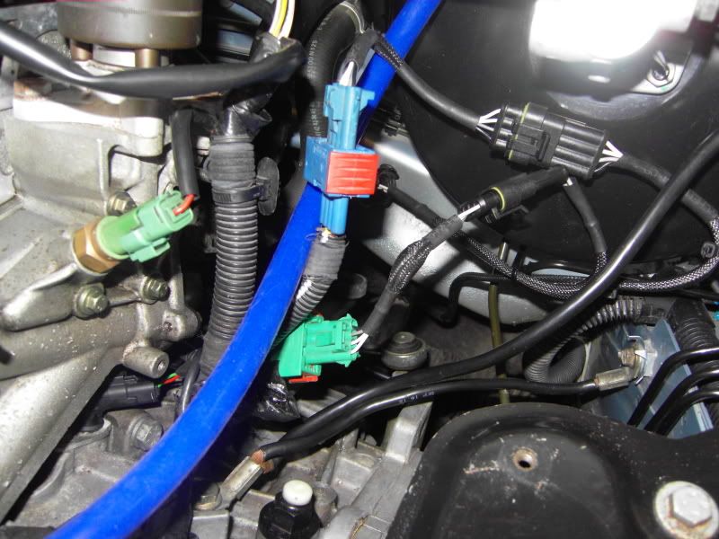

The crank sensor is on top of the gearbox but buried under the thermostat housing. You'll need to take the battery and box out to see it.
Looks like this.
See the green coolant temp sensor on the left? Directly below that is the crank sensor.

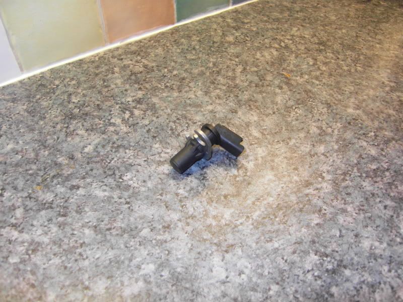

PostPosted: Sat Aug 27, 2011 11:44 am Up
Posts: 21
Location: DONCASTER
thanks guys
found the little critter.
when i changed the clutch a few months back i only unclipped the wires not taken out the sensor.
looks like i damaged it putting the gearbox back on. Embarassed
cheers
