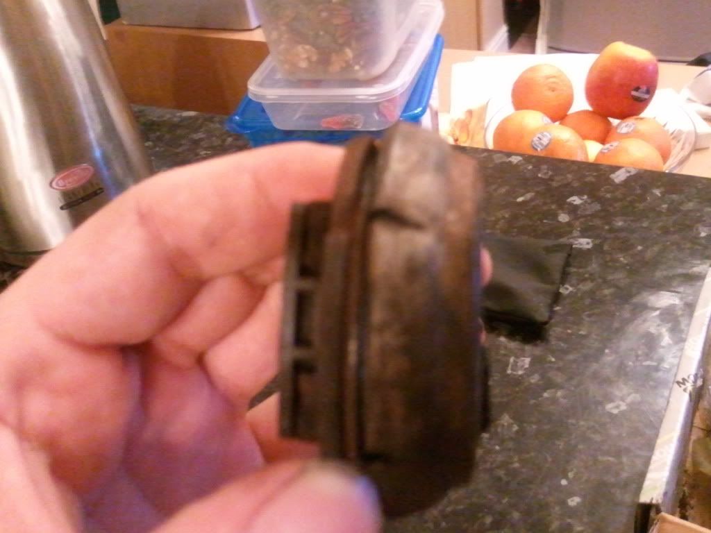

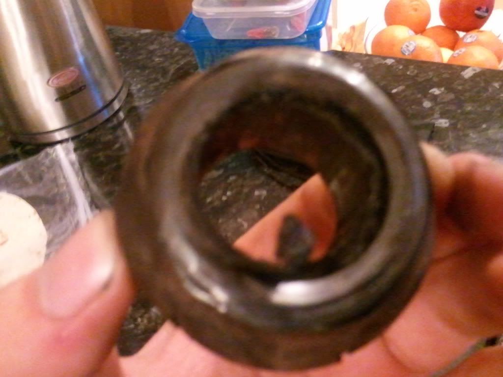

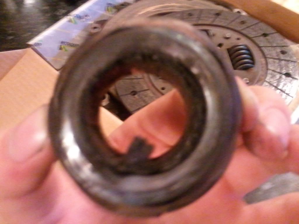

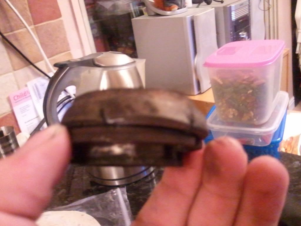

my 180 clutch was making a horrible hissing and whirling nosie i took it to a garage and this is the pics of what happened

PostPosted: Wed Oct 19, 2011 4:06 am Up
Posts: 7047
That's the sort of thing that comes from sitting at traffic lights etc with the clutch on the floor.
LilLew
PostPosted: Wed Oct 19, 2011 5:14 am Up
Joined: Jul 01, 2010
Posts: 560
this was after about 2 months of me buying the car lol and that is when all of the problems started with my lovely gti 180 and they are still on going
