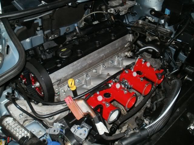

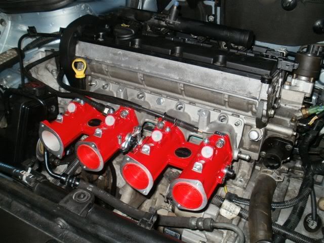

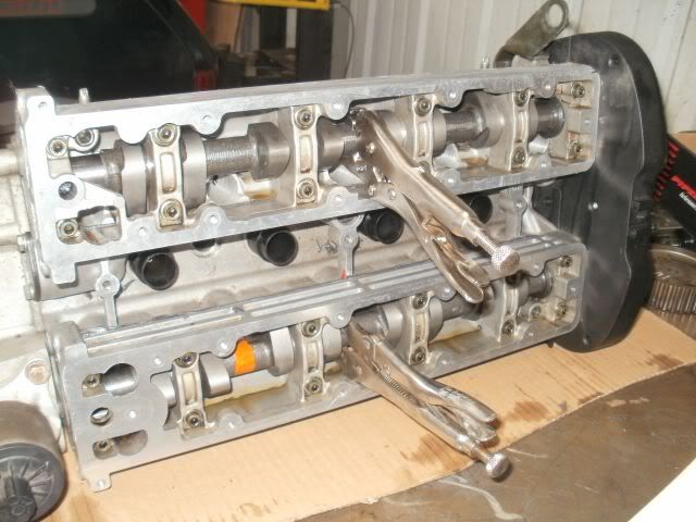

Anyway a few pictures have arrived from Ecosse...It's not finished and from the pictures it's evident there is still all the wiring to do, cambelt needs fitting, the camshafts need timing, airbox needs fitting, throttle linkage needs fitting...mapping...a lot of still to go work. What's been done so far looks good though. I like the vernier pulleys. Should the cambelt covers be cut so the pulleys are on view all the time?

Keep the pulleys on show Cool

jesus wots with using vise grips on the shiney new cams??!!
I cringed at the grips on cams too Sad

PostPosted: Fri Mar 12, 2010 2:34 am Up
They are only used on the shafts not the cam lobes so won't do any harm.
These cams don't appear to have anywhere for spanners to sit so maybe the grips are the only option.
this is the same as the gti 180 cat cams.
on standed cams there a 24mm nut apart of camshaft so can turn camshaft on the cat ones there's nufin so cant turn it unless you molegrips or put bolt in end.

looking good ed, my pullys are on show,↲Did you not opt for a oil catch tank? As when you open it up it could get a bit messy in the air box if thats were there feeding the breather pipe to.

It's safer to have the cam covers on i suppose. How would you cut the cover Paul?
PostPosted: Fri Mar 12, 2010 8:49 am Up
There are little circles already moulded into the cover. I'd just cut them out.
