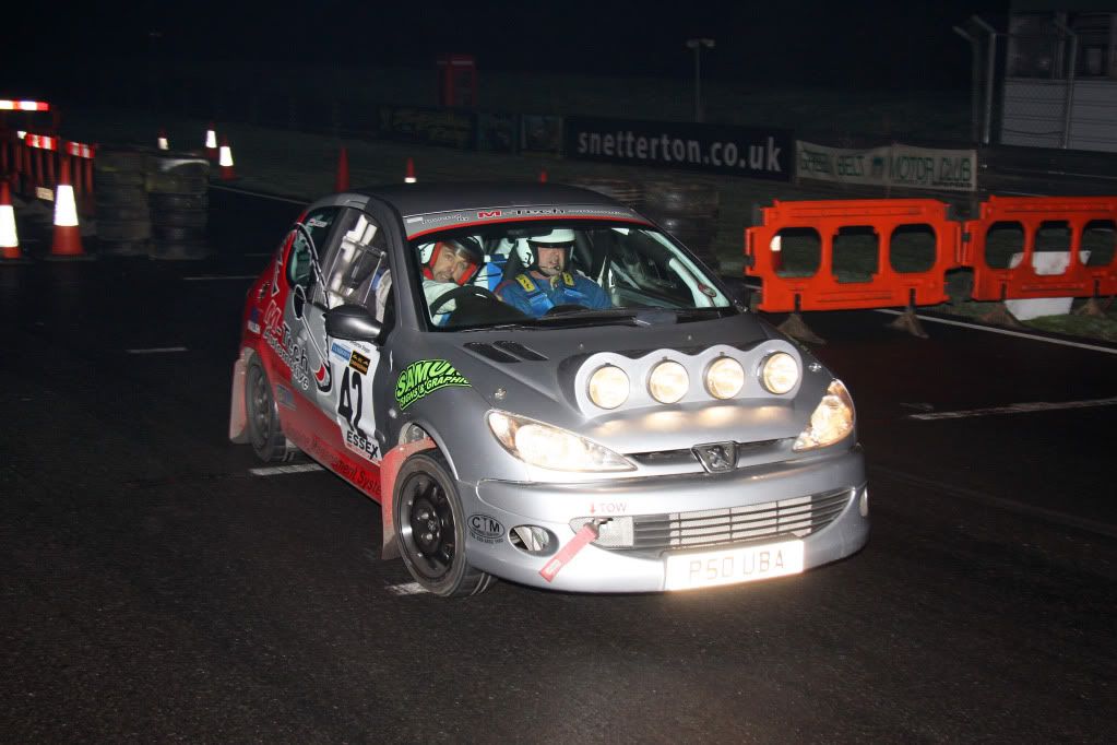

bugger .... I have NGK ones Smile with the lights ... its the front ones i'm thinking of, both the TT and Leon have xenons and these seem a little dim, and i'm not one for aftermarket conversions, i'd rather stick a brace of lights across the front WRC style Smile
try these

PostPosted: Sun Jan 29, 2012 12:27 pm Up
Joined: Jan 23, 2012
Posts: 140
Location: Stamford
Ha ha, I did google them but ones with 4 xenons and made from carbon fibre were double what I paid for the car Smile
