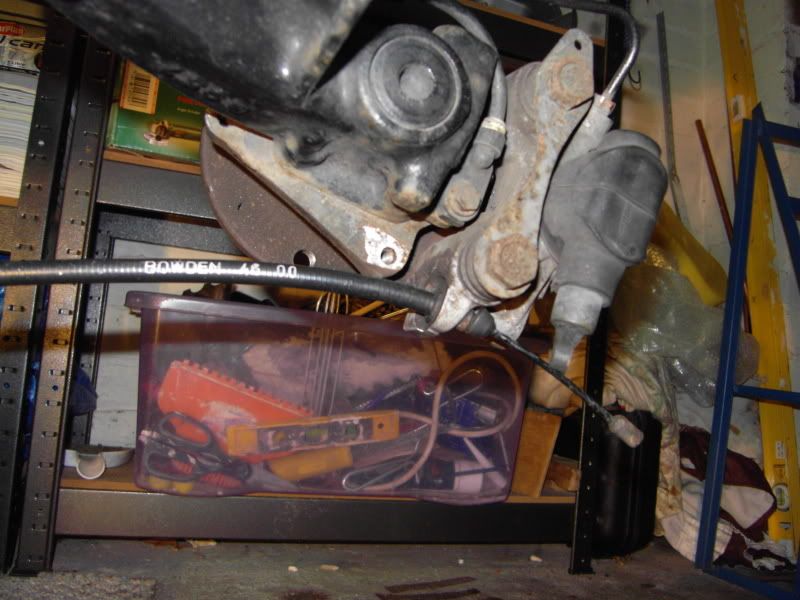

Does anybody know how the handbrake cables are removed from the rear brake calipers?
I've disconnected mine from the lever, pulled them through from inside the car but they are stuck in the caliper. Where the cable slots in the caliper there seems to be a little sleeve on the outer cable. Has anybody managed to remove it? Otherwise how do the cables come out? I don't want to damage them as they are getting refitted.

They just pull out.
PostPosted: Sun Feb 12, 2012 2:34 pm Up
Mine don't. Pull them so hard they stretch...
PostPosted: Sun Feb 12, 2012 2:37 pm Up
Tried putting a small screw driver in to prise it out? They have just pulled out on the ones I've done before.

Mine were really difficuly to get out too!
I soaked them in maintenance spray and hour later came out easy

they do just pull but they can be really difficult to do

Right I've ordered some Plus Gas to help shift them. I don't need to remove them but I'd like the out of the way when the calipers and axle get removed.
It will also help shift the torsion bars which are a little tight despite being covered in copper grease but they've been in there over 7 years.
