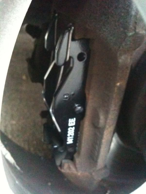

Anti rattle pins aren't visible in photo?! Think that point is some oddity caused by takin a photo with a mobile and a torch. Will takes better pictures tomorrow but won't be whipping any wheels off until Saturday.

better pic

They don't look right to me ... if they push in from the left as you look at this last pic, what is holding them in?
The anti-rattle springs are pushing on the caliper which surely is just going to lift them out again?
Either the pads are wrong for the calipers or the caliper is missing something.
On our 206CC, there is a small metal bar that locks the pads in place, then spring clips stop the bar from coming out. There doesn't appear to be anything actually holding them on you car ... Confused

Small L-shaped metal bar is down the bottom of the pads and secured using the wire clip. Anti-rattles are secured using the caliper. They won't come off the brake pads unless the pads is removed from the caliper
