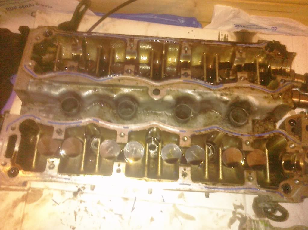

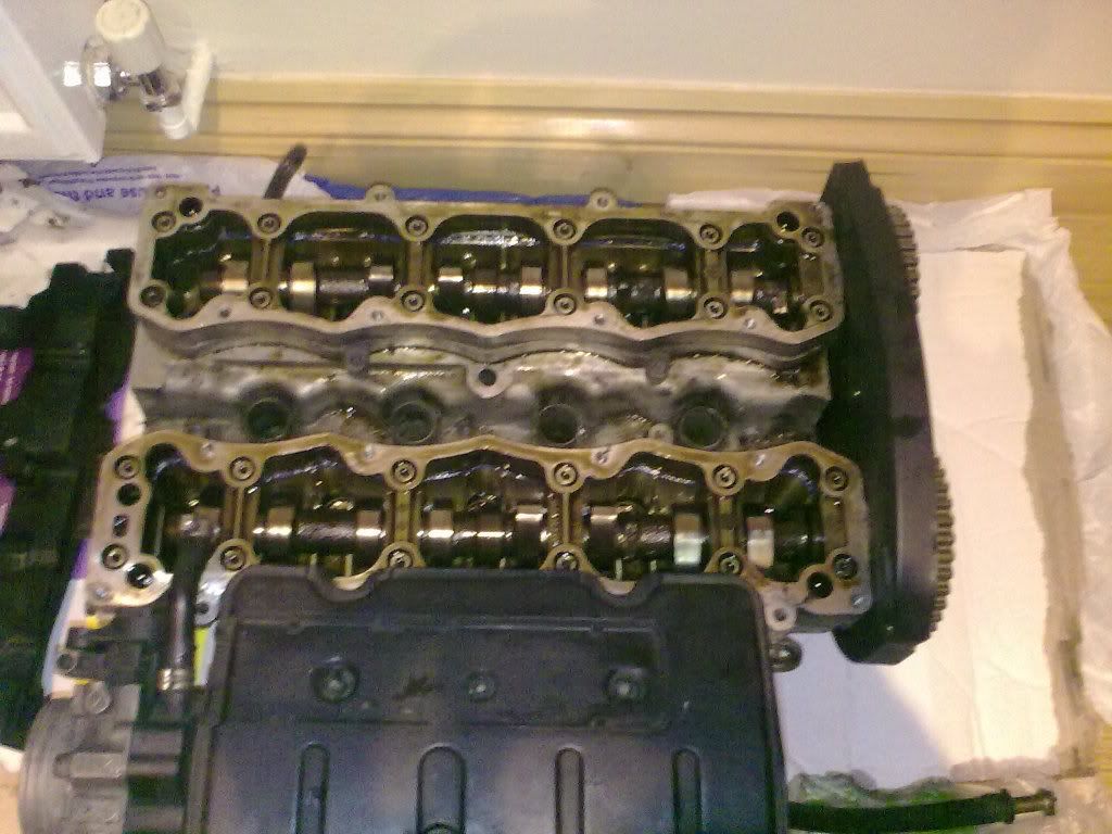

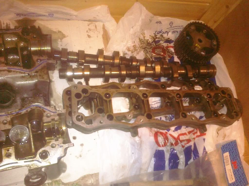

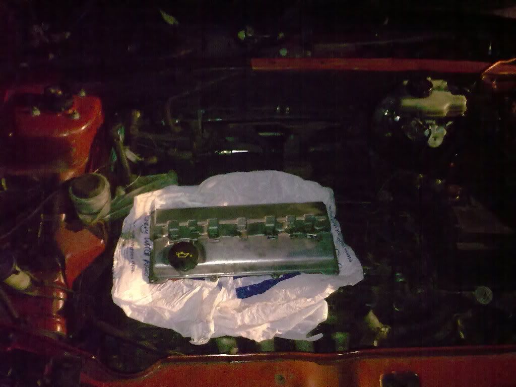

well i got bored this evening being in so me and tom started stripping my head, we didnt mean to, it just sort of happened lol first of all the inlet mani came off, then the pulleys, cambelt cover, cam ladders and then lastly removed the cams
just need to remove the valves and tappets tomorrow and shes ready to be skimmed

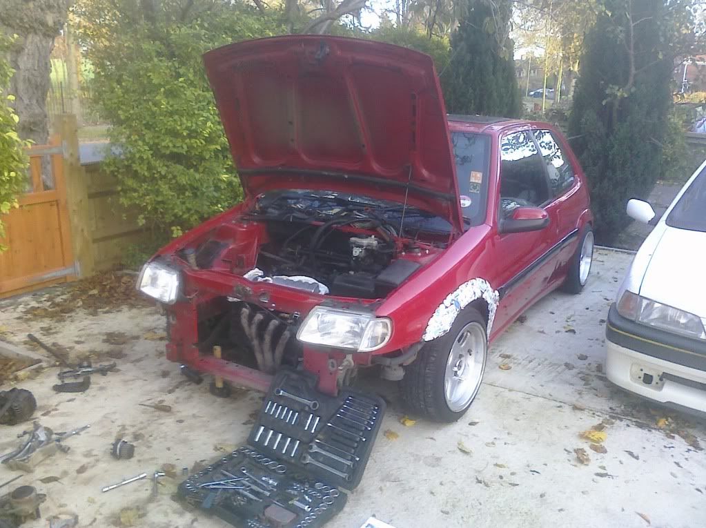

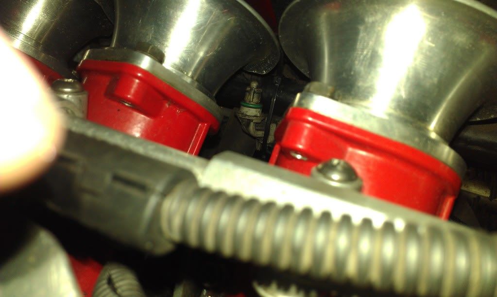

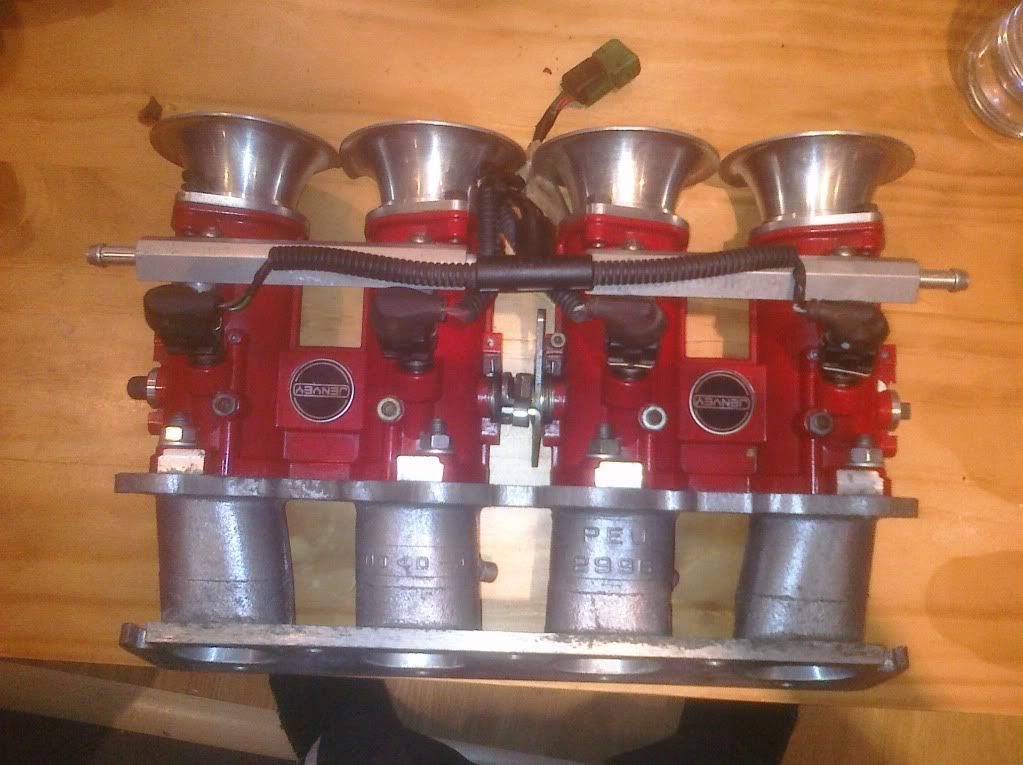

all I did today was remove the injectors and wiring from the old inlet and fit them to the throttle bodies just because im eager lol

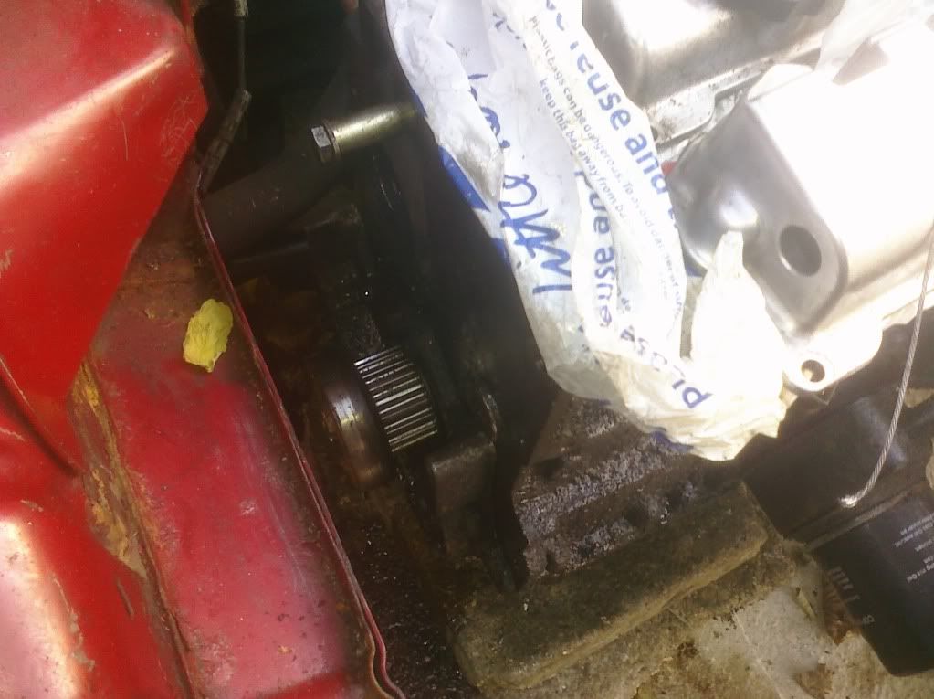

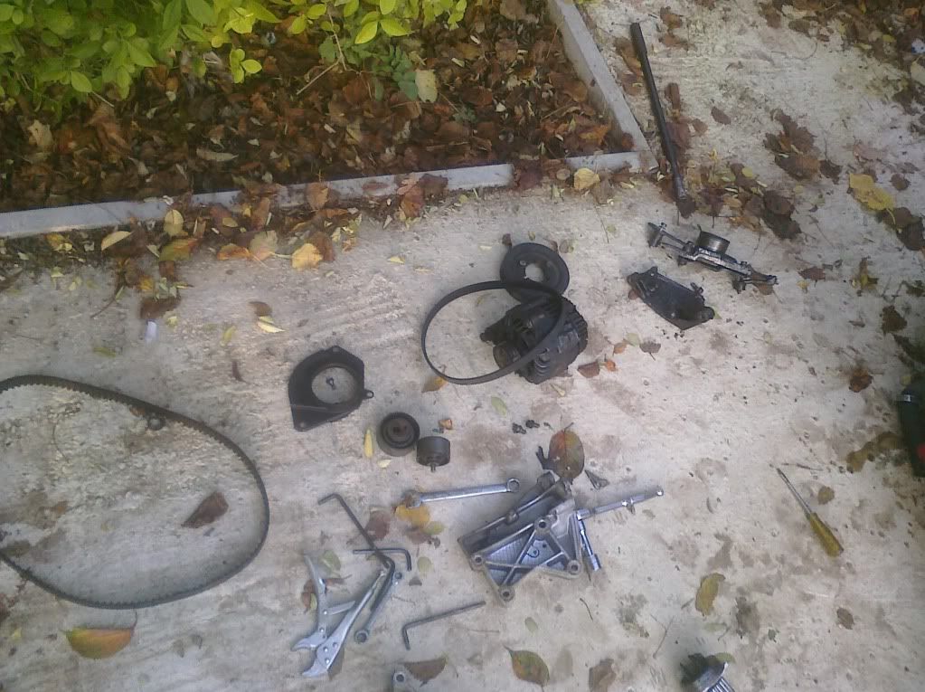

bit more strippage today, i removed the alternator, aux belt, pulley, tensioner and all the brackets. As well as the cambelt, water pump, idler, tensioner and the engine mount. all will be cleaned up or replaced where applicable.

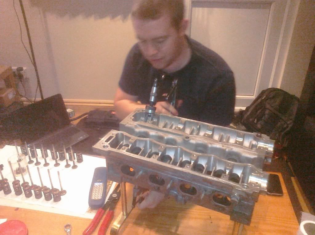

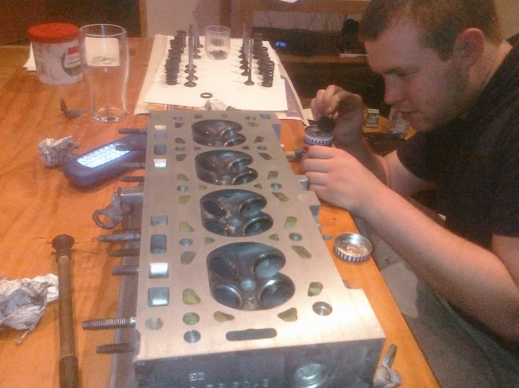

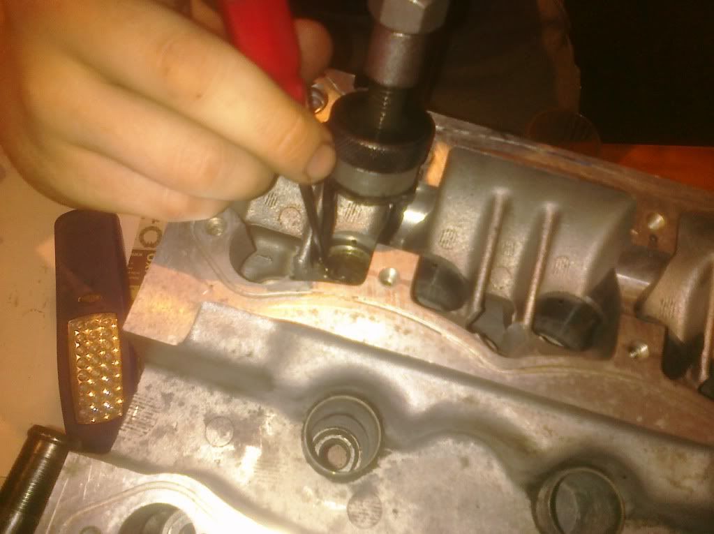

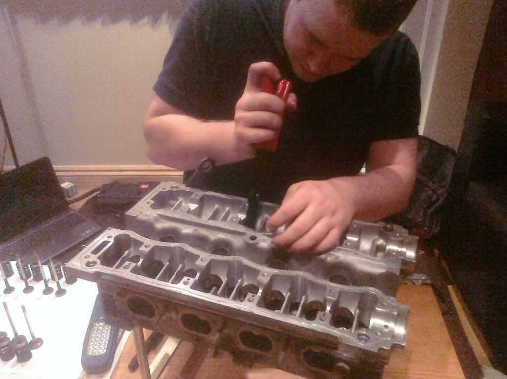

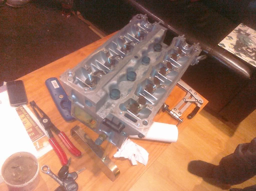

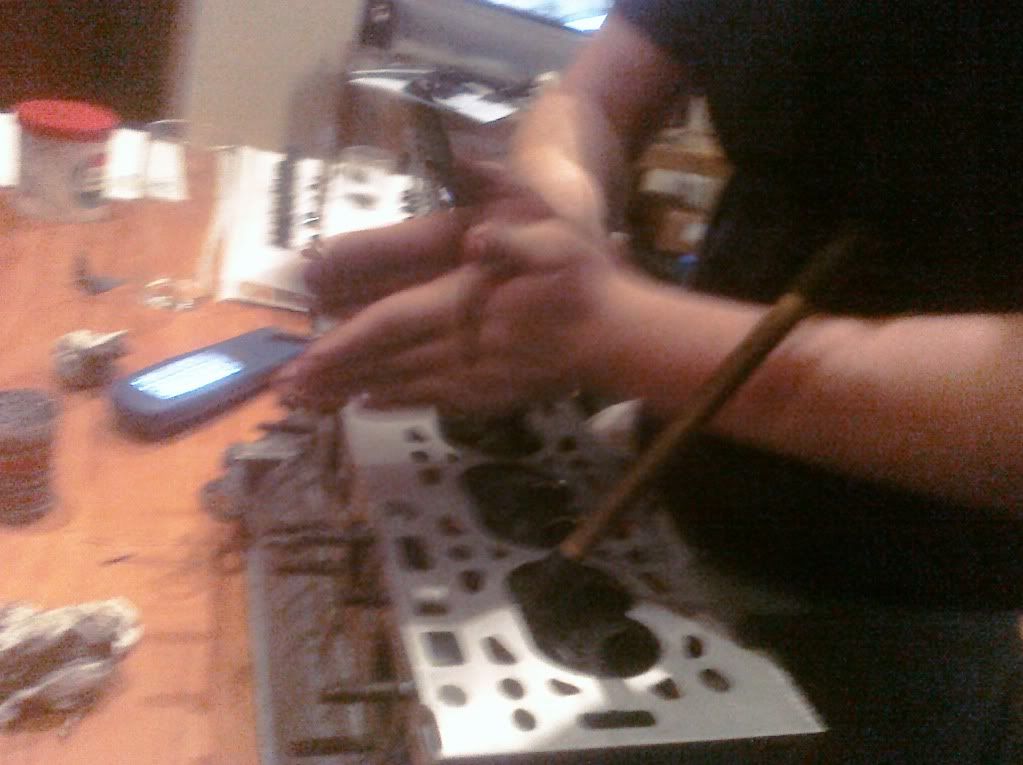

well i picked the head up yesterday from being skimmed, adn i dropped my cam ladders off at the local garage to have two snapped bolts extracted, but we made a start on refurbishing the head

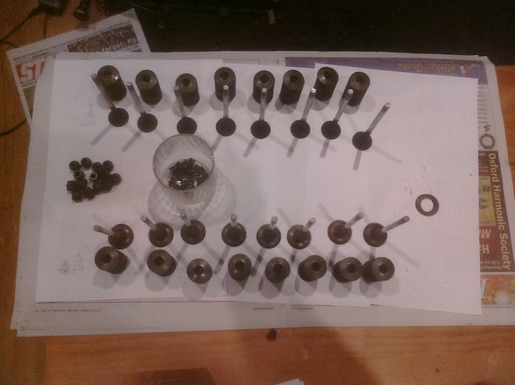

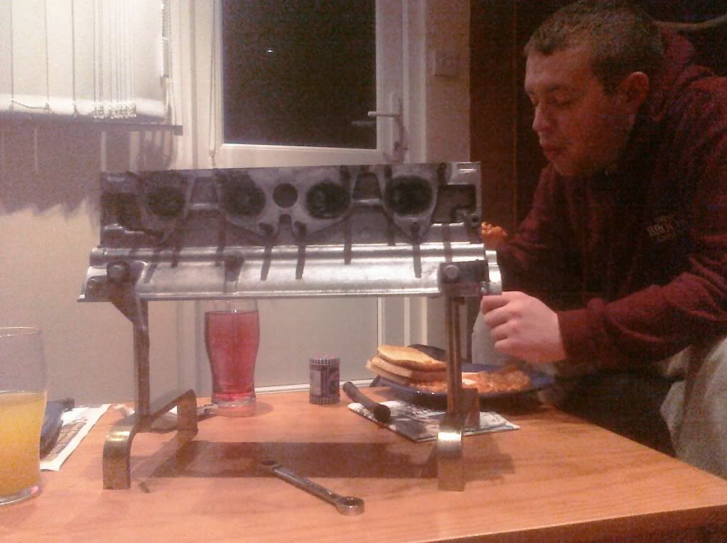

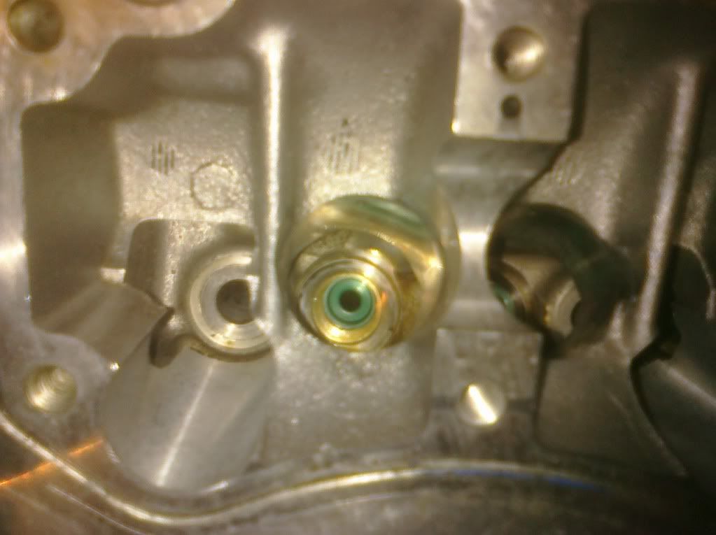

first of all we put the head in to a stand and we removed the valves, springs, caps, collets and stem seals
and then we started grinding the valves and seats
tom having some well deserved dinner! (or tea, sorry tom)
once the valves were reground we fitted new stem seals
refitting the valves and springs
trying to carefully get the collets back in
then at 1am last night we finally had the head as complete as we could get it with all the valves put back in and the hydraulic lifters (which had been drained of oil)

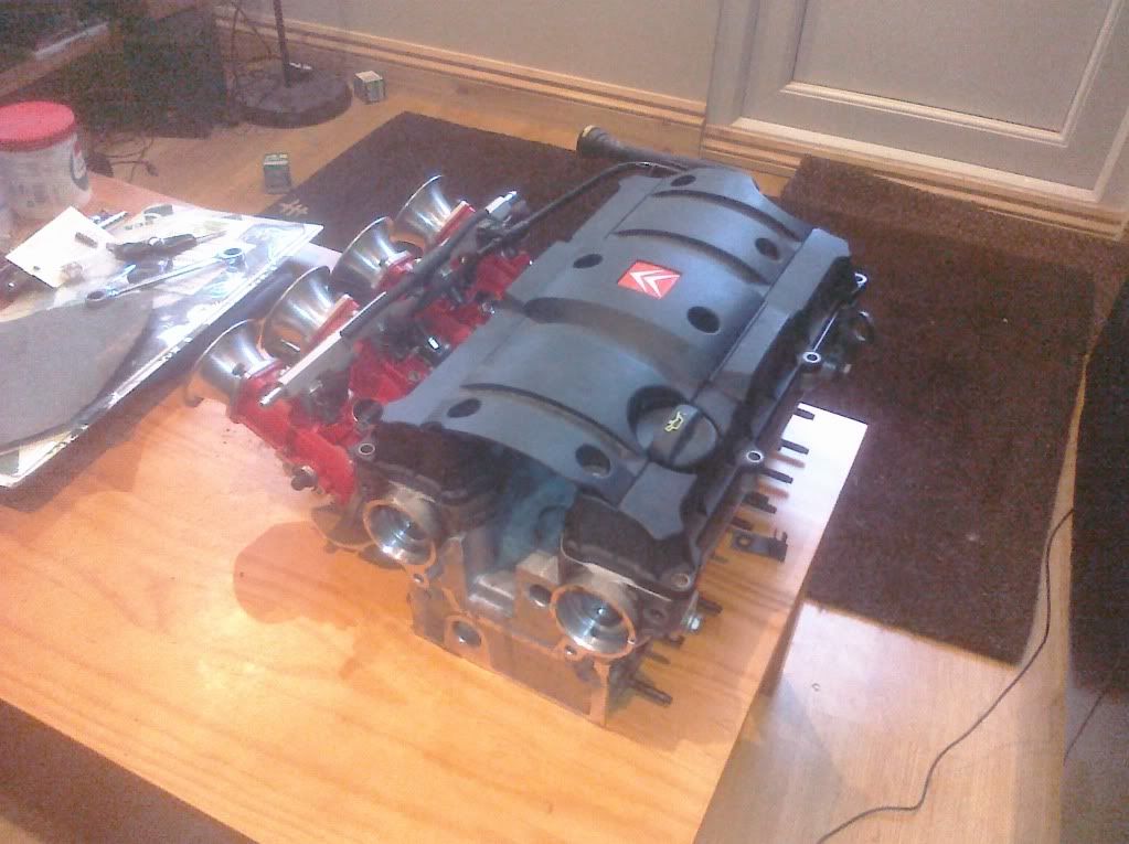

Today i picked the cam ladders up from the garage so later on this evening we will fit the cams with new cam seals and bolt the cam ladders down, ready to re fit the head tomorrow :y:
took a few pics Razz

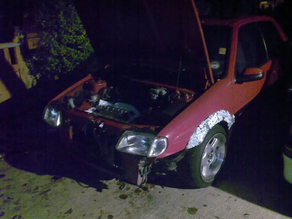

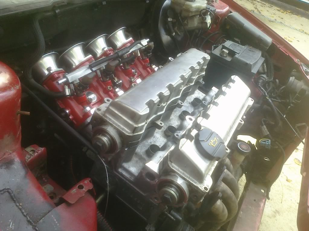

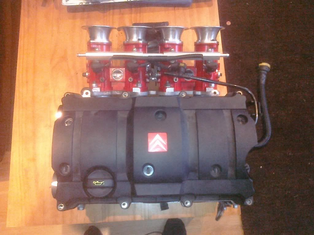

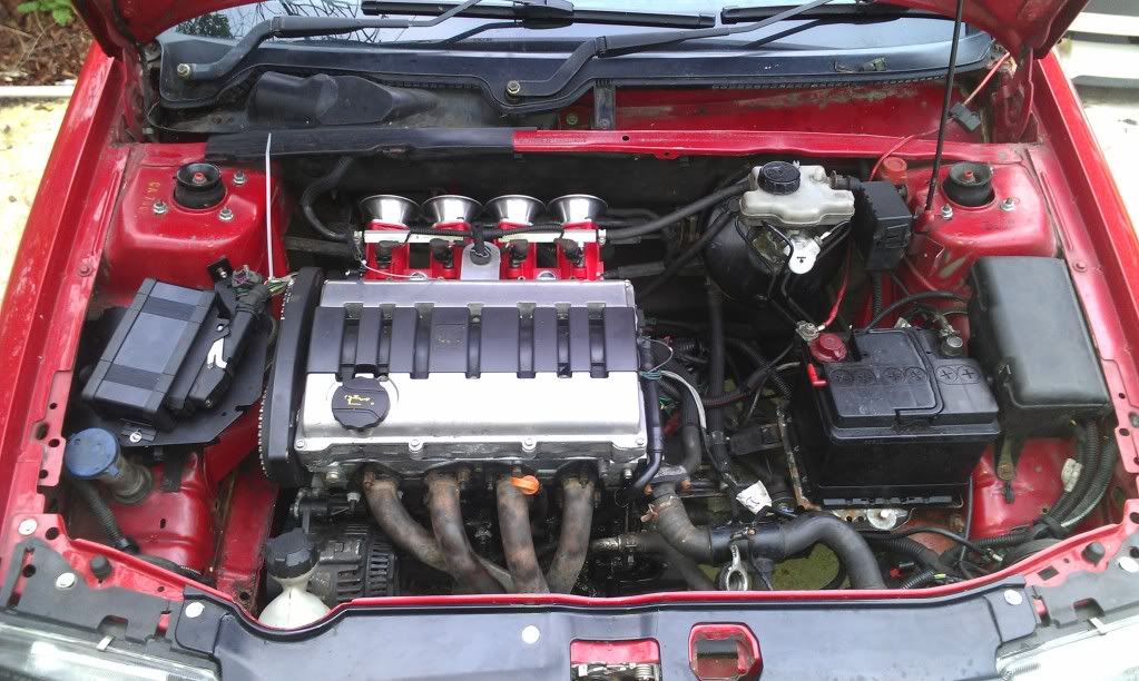

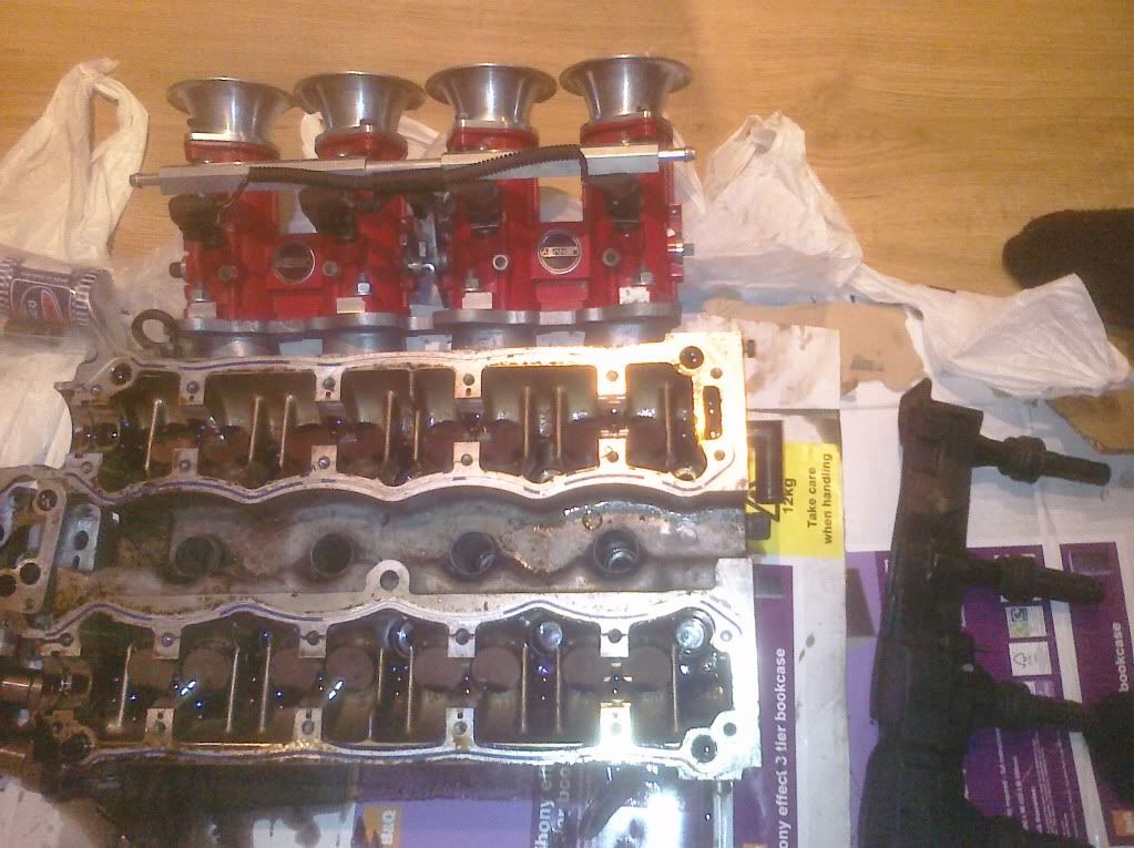

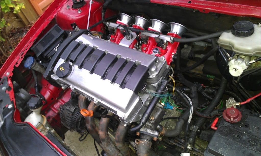

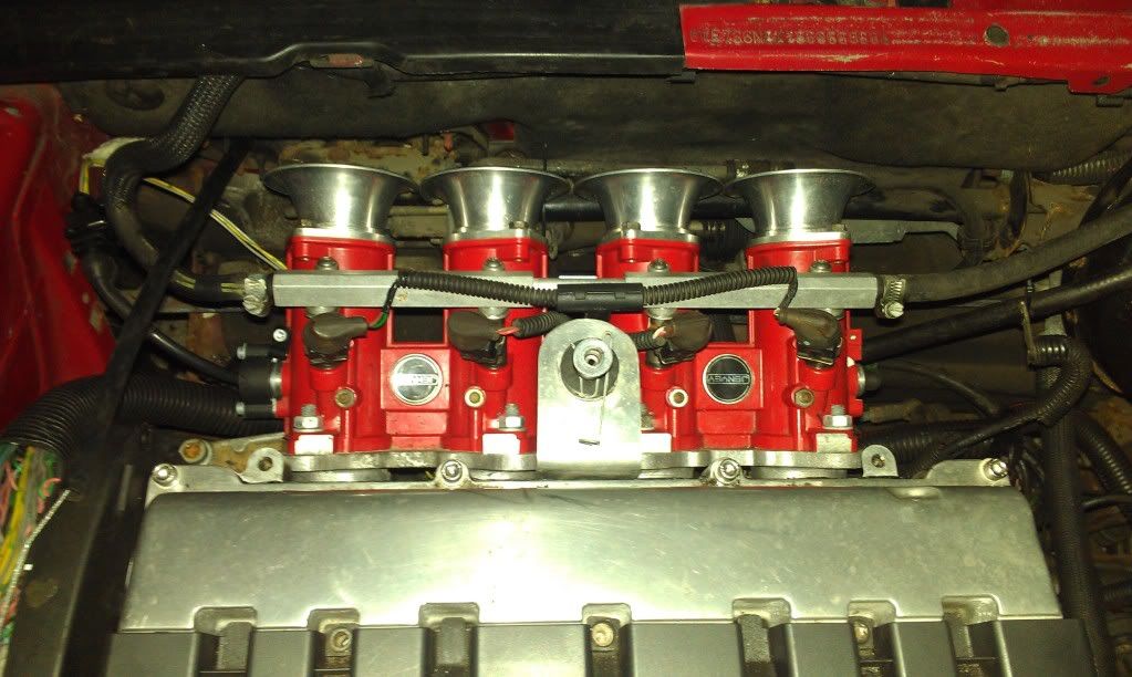

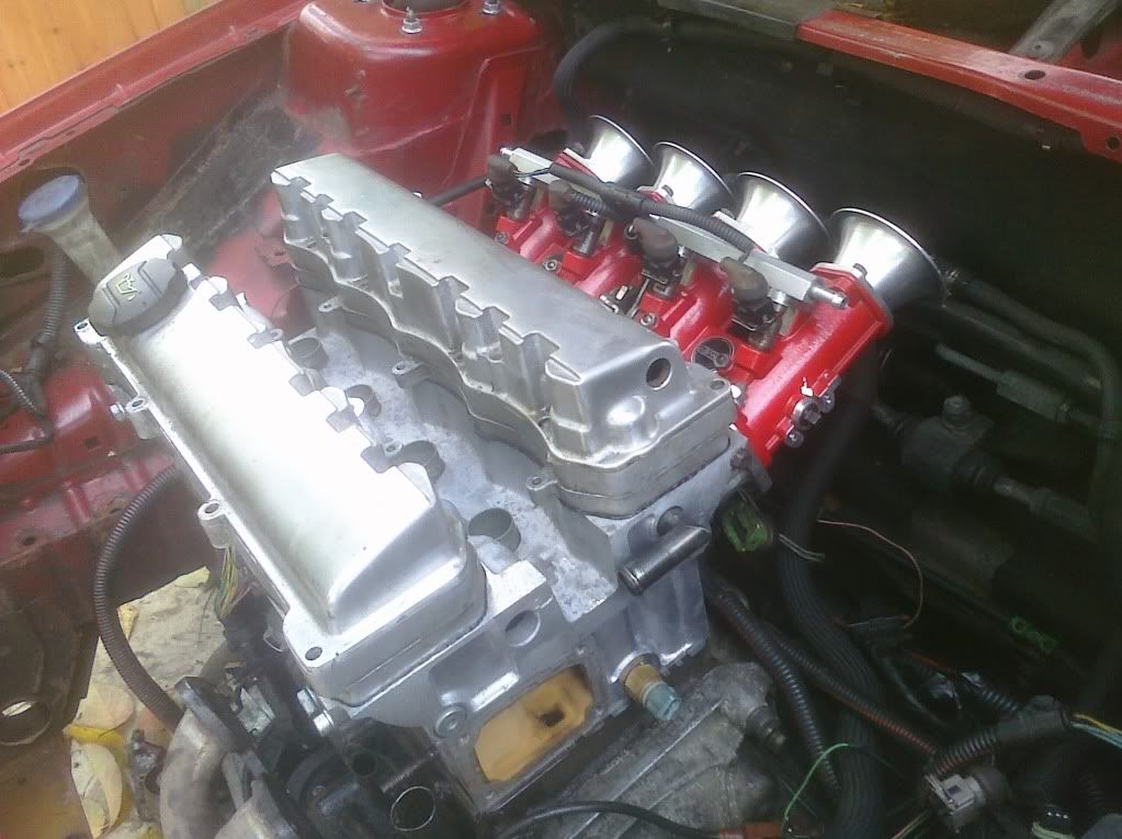

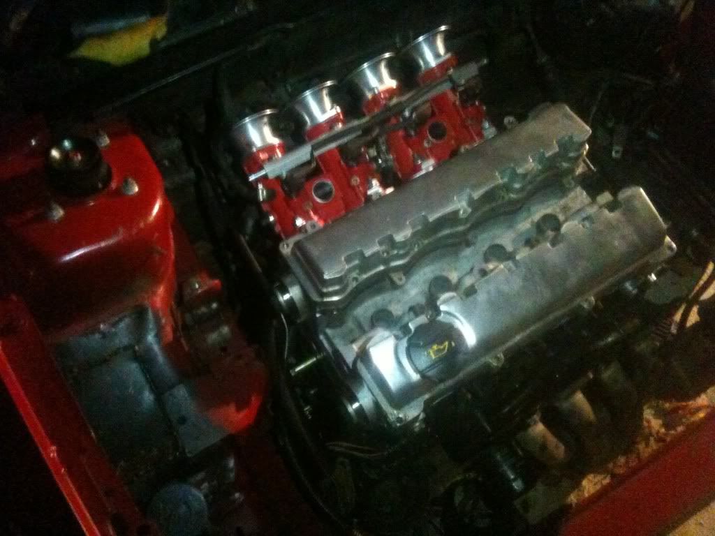

well the cylinder head is bolted on and i put the bodies on loosely as i was eager to see what it all looked like, can i finally say i have a cammed, bodied engine? lol
couple more day time pics, obviously a lot of cleaning a tidying up needs to be done but you get the idea lol

well cars almost there! jenveys are fitted properly, engine mount is on, cam covers back on, fitted radiator and hoses, just need to cable tie the iat sensor, wire up the tps and connect throttle cable, and then its just fit the cambelt and alternator and we should be able to start her up! so one more full day on it should see it ready to be mapped

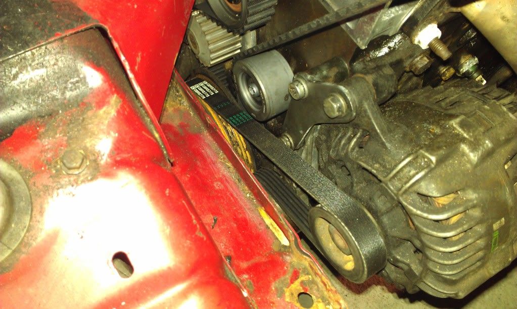

Been nearly 6 weeks since the last update, got back to my uni house earlier today, made some more progress me and tom got the alternator, brackets pulley and belt on
Slowly but surely getting there, tomorrow I'm doing an oil change, mounting the throtle cable bracket, fit outtercambelt cover, mount Iat sensor and splice the tps sensor then that's everything bar mapping!

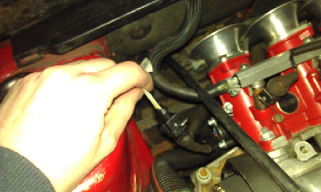

Fitted the throttle cable backet
Wired the tps in
And cable tied the iat sensor up

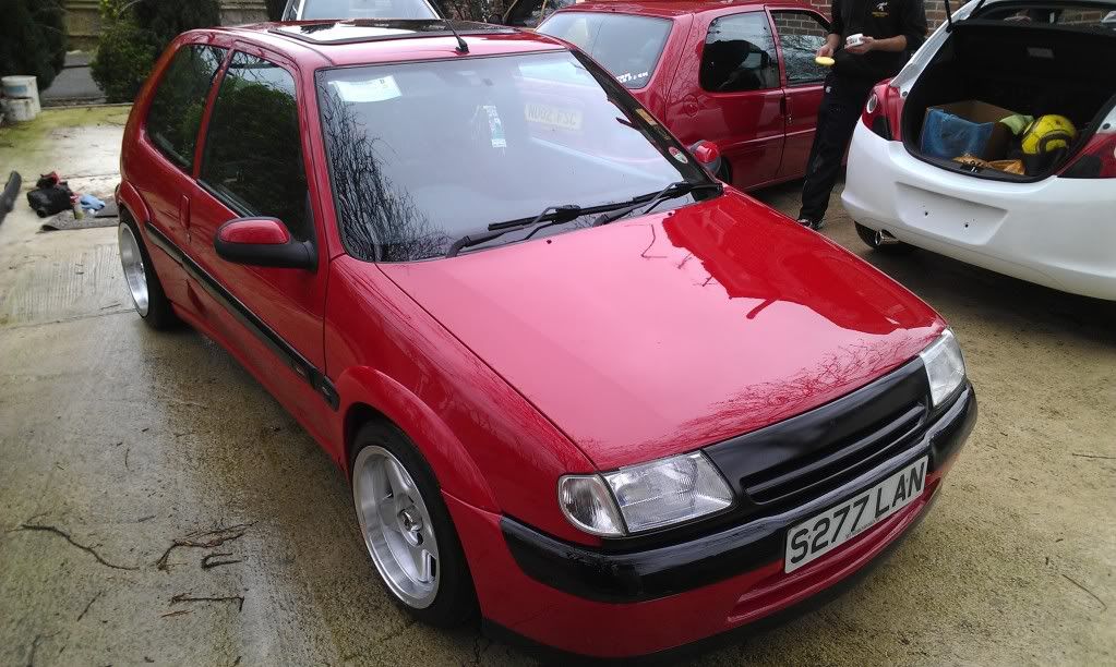

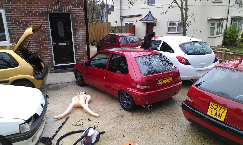

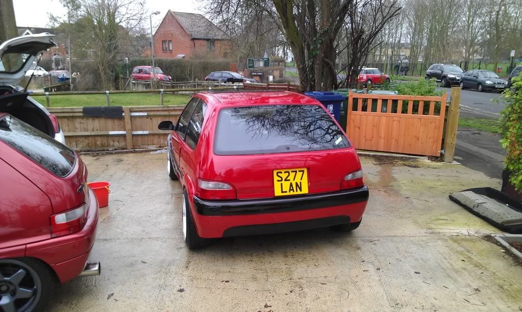

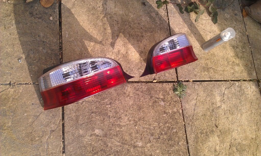

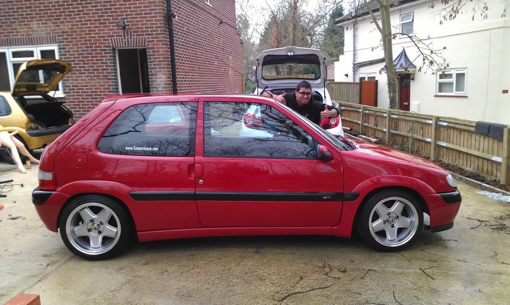

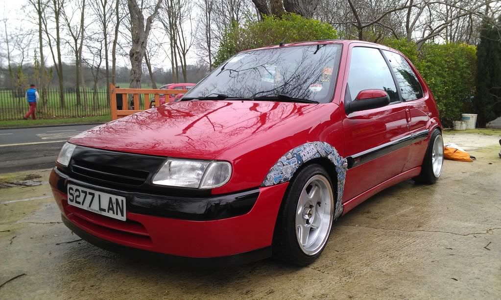

no real update as im still waiting on my starter motor but i thought id pull the car out on the drive and give it a wash and polish as tom and my other mate were doing there's, i also re-tinted the rear lights as they were fading and i fitted the mk2 lights off my vtr on to it to see what it looked like and me and tom seem to think ti looks better, anyways im going to lacquer the lights to tomorrow to stop them fading and refit them and post up a pic and see which ones look better

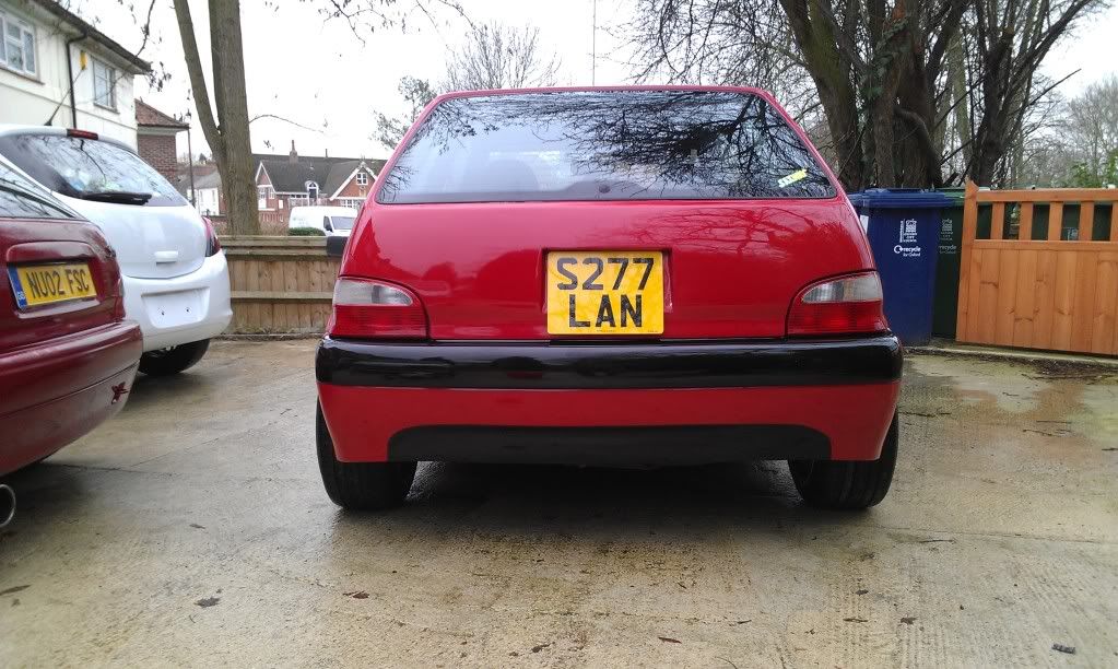

quick pic of our french drive lol up until a few days ago we also had my gti on there!
been a busy boy today

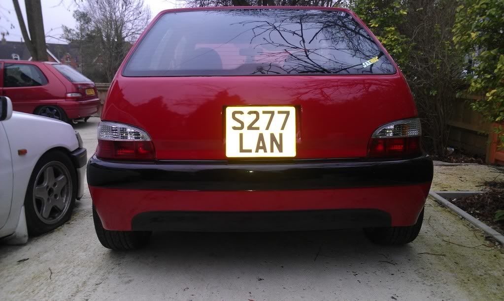

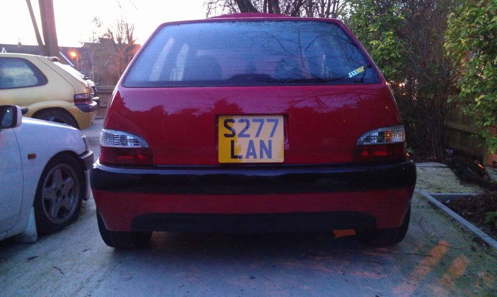

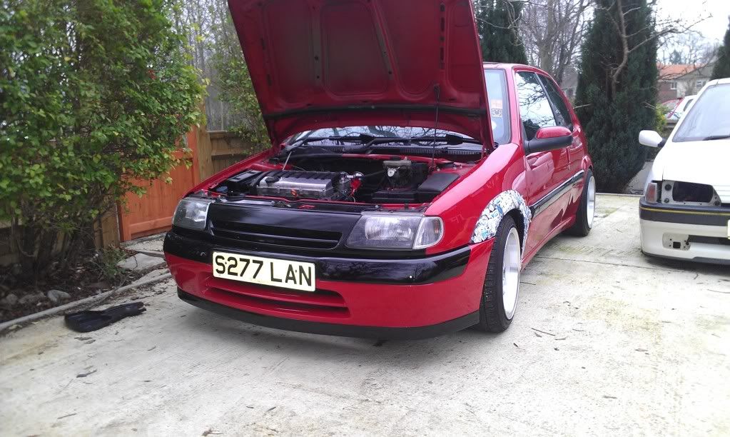

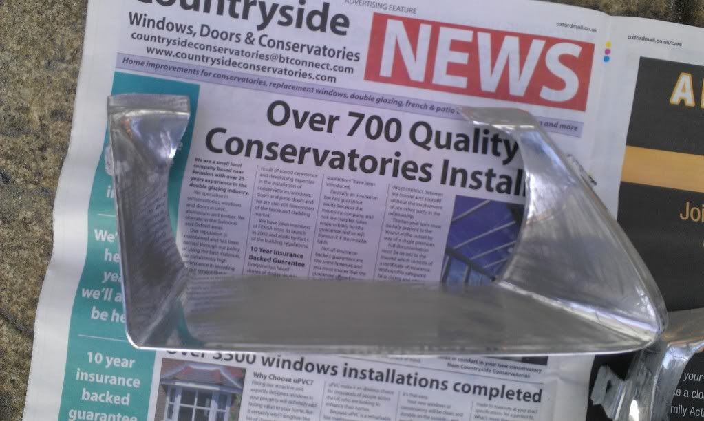

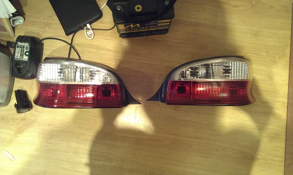

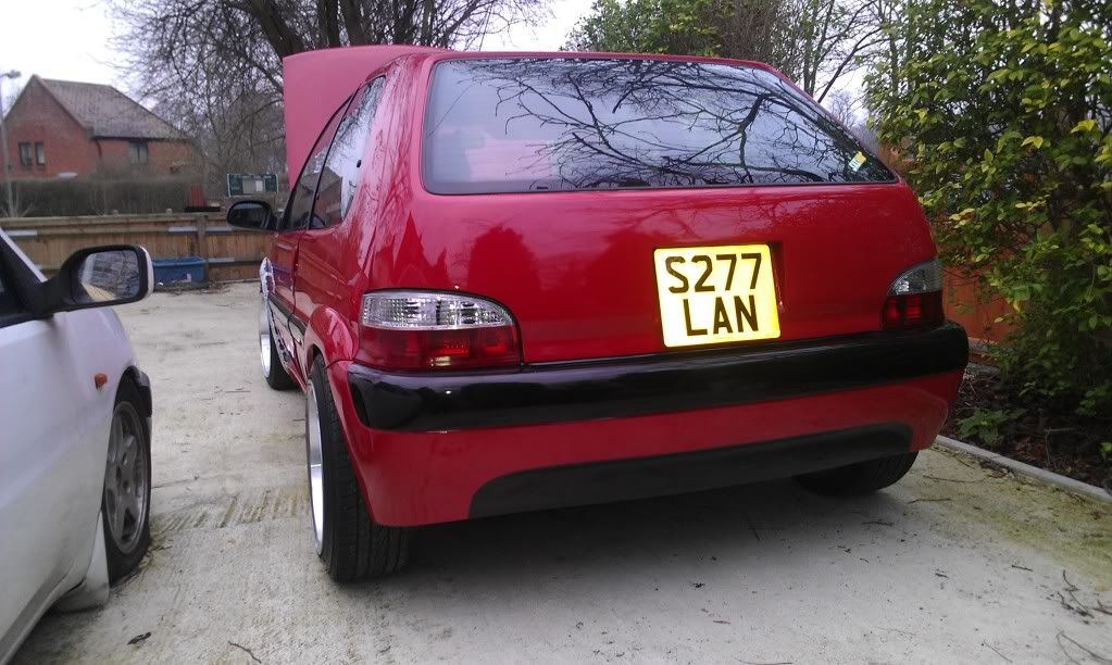

firstly i lacquered my rear lights to stop them fading, fitted them and took a pic, what do people prefer the oem mk2 lights or the jewels?

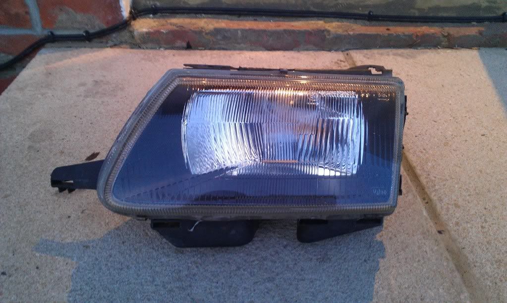

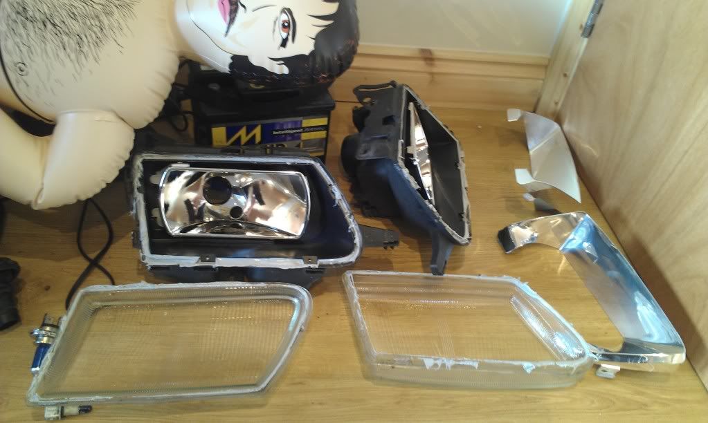

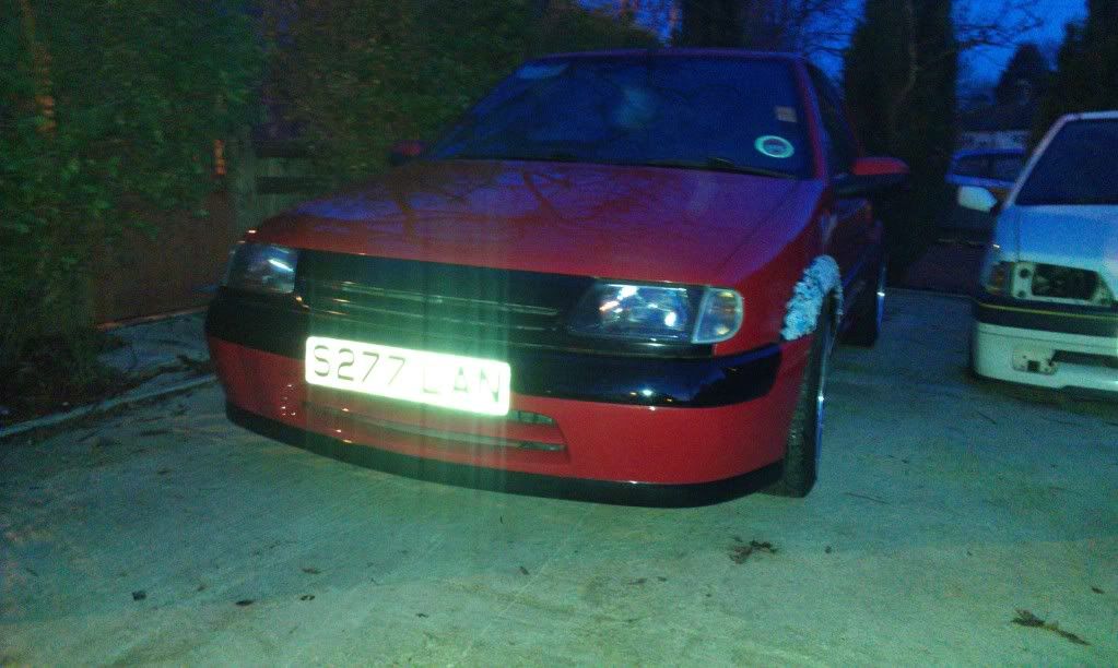

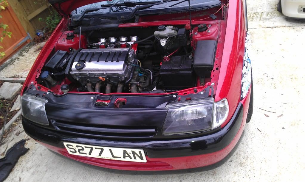

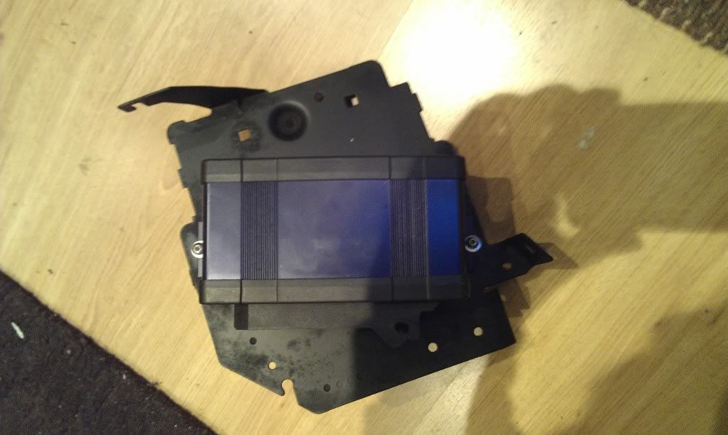

also i decided to tint my head lights Smile and sprayed the ecu bracket black, love them just need to buy some smoked indicators, will put up a better pic tomorrow
also got some shiny new bolts for my coilpack, cam belt covers and ecu bracket

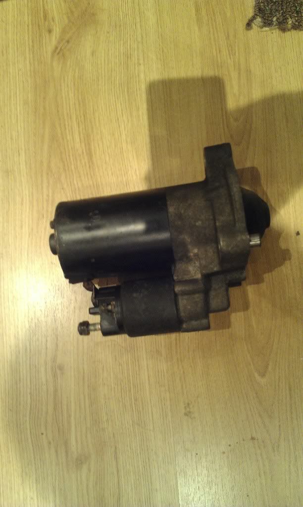

and my starter motor turned up, this will be fitted tomorrow and the battery will be charged, outer cambelt cover and ecu bracket will be fitted then ill connect the loom up and hopefully get it started!
well the car is in a state to be started up... well it turns over but not firing so im waiting for andy to get back to me so he can remotely connect to the predator and put the proper map on it and see whats going on, only real thing left to do is connect the throttle cable some how :s but not essential to start the car, then get the cams timed in properly and mapped, once that is done im buying a new loom for it and making it look nice and tidy and taking out any sensors that arent being used

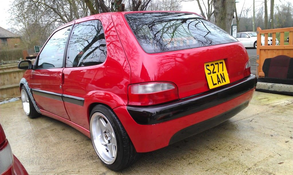

anyway here are a few pics showing the front lights, rear lights and engine bay in better quality/brighter photos than the previous lot

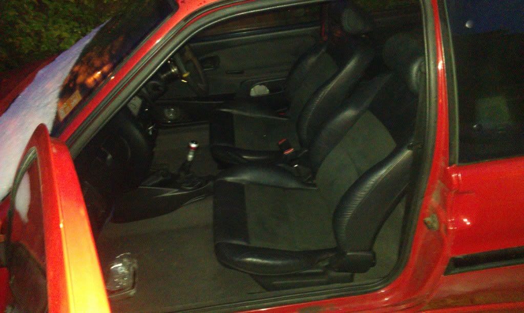

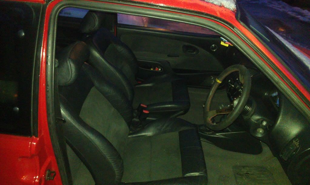

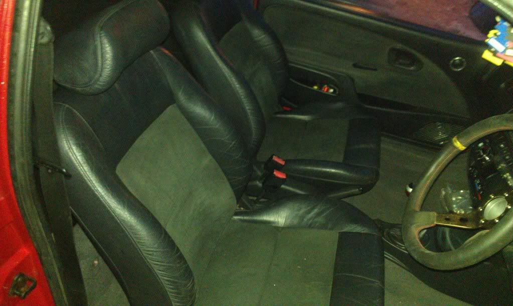

well i picked some 106 leathers yesterday were a bit dirty, but good condition for the price of only £60!
bought some products today
clean and protected them and then fitted them, pics are a bit s**t makes everything look green and a dirty will get some better pics tomorrow Smile

if you wanted some good masked lights for show try getting a cheap set of chav halos with clear lenses and put the clear ones on the masked originals that looks good if your spraying in the lights is upto a good standard

also put some insulation tape around the wires in the bay to tidy it up and protect the wires a bit more from moisture
