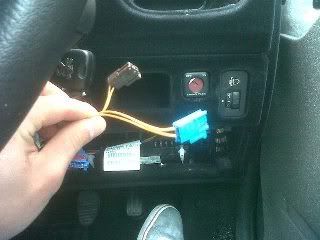

put the dash back in and im pretty sure every thing has gone back how it should be, but im left with two plugs just behind the steering wheel can anybody identify them thanks

hi, could they be loom plugs for LHD passenger airbag? look similar to air bag plugs, if they are might not need to be connected on RHD. Dave

hi, could they be loom plugs for LHD passenger airbag? look similar to air bag plugs Dave
Oooo maybe, like I say I'm pretty sure every thing has gone back in I'm not the type of person to forget about two blugs lol but mistakes happen thanks for the input

See what number codes are printed on the wires, that will give us a clue to what there for.

They are for the comms unit. Coincidently the ones that only run 4 volts in my car for unknown reasons. Take the cover off the comms unit and plug them in. They go in oposite corners at the back.
