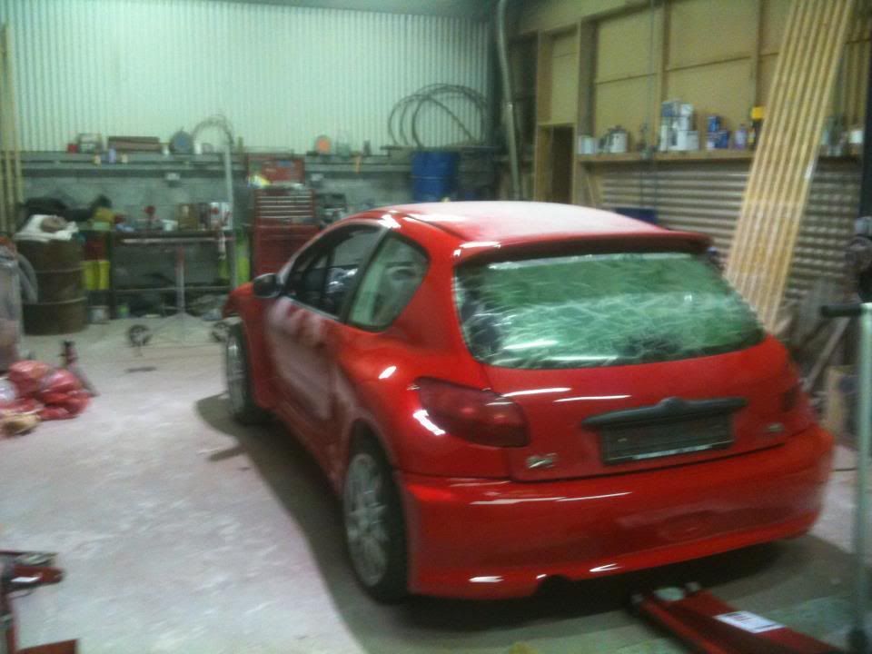

Few pics of bumper & doors refitted roof is a bit dirty but will clean it up later in week Very Happy
finally its starting to look like i might eventually get it finished Laughing
again apoligies for poor quality pics i will take decent pics when i clean it up n polish it

Can I suggest to you please us PH2 taillight and bootstrip. =)

Looks amazing mate hats off for the time and hard work you've spent on this project

briant wrote:
i am thinking of changing bootstrip,is it a direct fit?
if i pick up PH2 lights at good price ill upgrade at later time
Yes. It's direct fit. Are you planning install WRC spoiler on your car ? And any picture from your front bumper ?

Schumi wrote:
not fitting a WRC spoiler just the spoiler thats on it,no front pics yet as havent the front bumper moulded yet and want to make a fiberglass bonnet so be few weeks before thats done

usher wrote:
top work with the kit
im planning this in the long run but ITB's first
how bad was the kit to fit as i think you got it from the website im looking at/the only one to sell the kit
love the colour nice and shiney
TBH the kit wasnt great i had to modify every part of it except the front bumper.had no brackets nothing
dont get me wrong its not an expensive kit but a lot of work ,i had to modify side skirts and wings so much they would have fell to pieces so i moulded them when i got the fit correct and made new wings & skirts.
if you can do bodywork yourself then you may not be so bad but id estimate i spent near 100hrs on bodywork alone & its no show car would need a lot more work to be up to that standard as a rallycar its fine Wink
i will be able to make exact copies of my wings,skirts & bumpers but didnt make mould of rear 1/4's
if you want any close up pics of brackets etc let me know

thanks for the info i am not good at bodywork/have no experiance really
also i dont have 100hrs etc as its my daily drive
might have to give the kit some thinking before i dive in

briant wrote:
Please post any picture can you show us. Smile Including brackets. Thank you. Smile

what would you charge for the copies hypathetically
could be some money to be made lol

Schumi wrote:
briant wrote:
ill take better close up pics of brackets etc. when im up at garage next week
