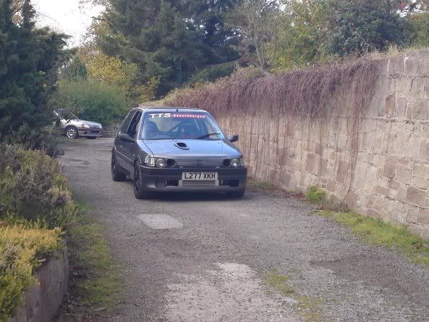

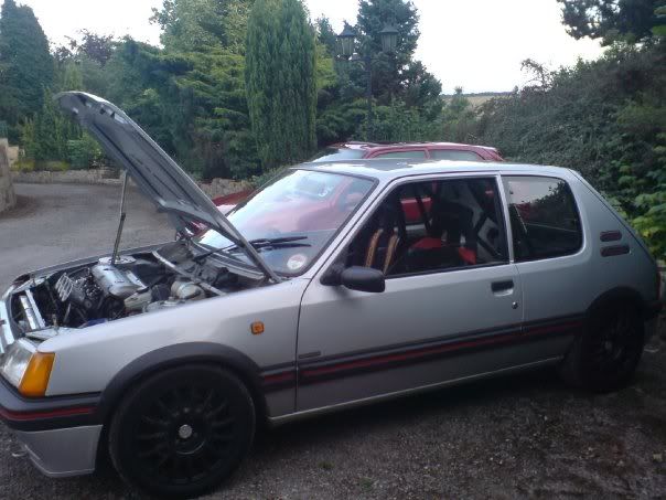

Hi guys. I know this isn't a 206 but since i joined this forum i have had a fair bit of interest in the car, also the development of it.
To cut a long story short, me and a mate originally built this in 2005. It was owned by him, i already had my own 106 track car.
My mate managed to find a fully track prepped 205 shell that only needed an engine. He didn't want to go down the old mi/gti-6 route because he wanted something different. In the end he decided on a 206 GTI 180 (EW10J4S) engine and found 1 that had covered only 500 miles when lifted from the 206. Im fairly certain it was the first 205 with this engine fitted, we contacted various peugeot tuning companies for info and all said it couldn't be done. To start with we had it running on the standard ecu and multiplex wiring which wasn't ideal. We then ditched that and ran it on a omex 100 and carbs (yes thats an engine with variable valve timing and carbs Shocked ) It produced a healthy 197 bhp and 155lb/ft, we were over the moon. The smiles soon wore off so its back in the garage for cams, TB's and omex 500. This next setup made 202bhp and 167 lb/ft, not much gain for the money spent but it drove so much better and idled like a standard car.
After a couple of years and plenty of trackdays my mate decided it was time for a house. So much of my own time and effort went into the car i couldn't resist buying it. I was half way through supercharging my 106 at the time and kept at it for another year. Having such a good all round track car i always had doubts in my mind wether the 106 could be a match for the 205, deep down i knew it wouldn't so i decided to break the 106.
My old supercharged 106
The 205

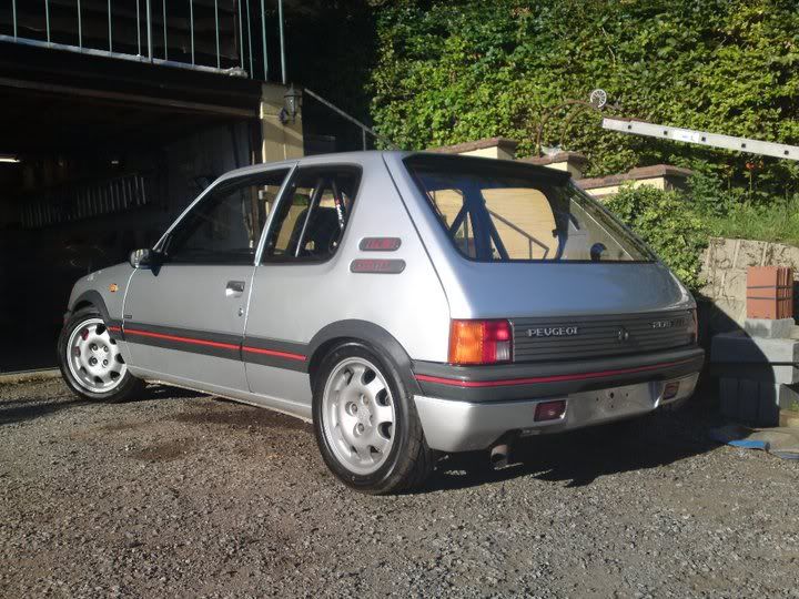

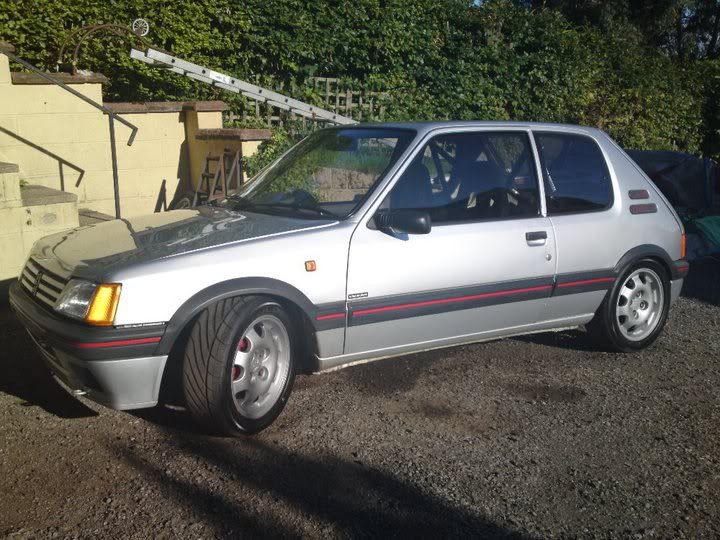

In the past years i have owned the car its had a full respray, a few extra sets off wheels and just general tidy up. It may be a track car but its my aim to keep it mint, the shell was dry stored for a number of years be for my mate bought it so not single bit of rust any where.
How it looked after the respray

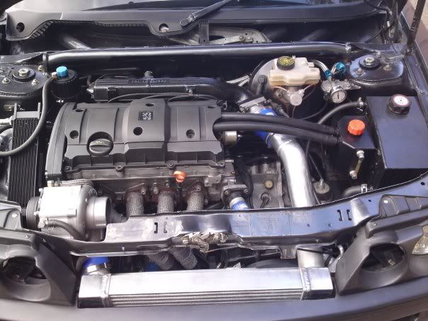

At the end of summer 2011 i decided to strip the car down and rebuild everything. That included fitting a few goodies that i kept from breaking the 106.
New parts are...
Rotrex c30 94 supercharger
Custom Bracket
Custom Inlet and rail
Omex 600
Omex race loom
Cobra suzuka pro buckets
Sabelt 6 point harnesses
FSE adjustable FPR
Siemans 660cc injectors
Forge alloy rad
Forge intercooler
Forge recirc
Mocal oil cooler
Weber AFR gauge
205 with Supercharged GTI 180 lump 374 bhp...soon to be 400+

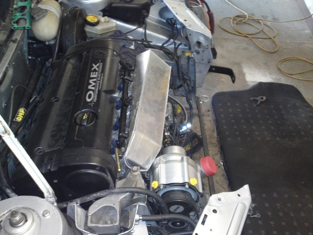

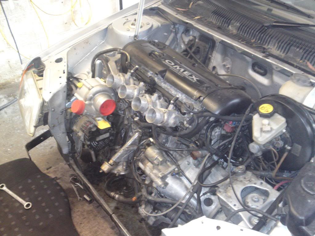

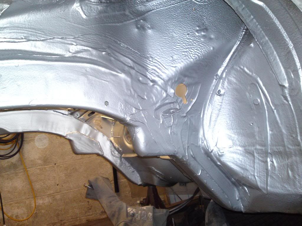

Stripping the car down and mounting the S/C
Making the new Inlet plenum

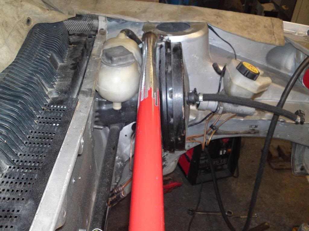

Custom (removable) strut brace

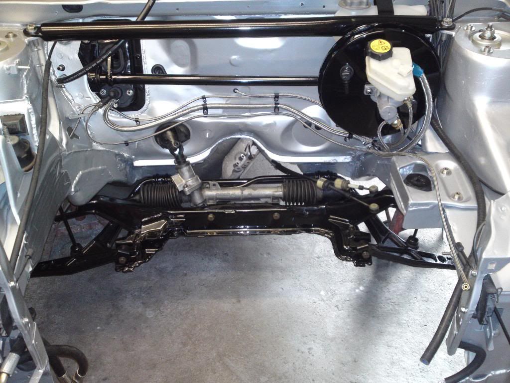

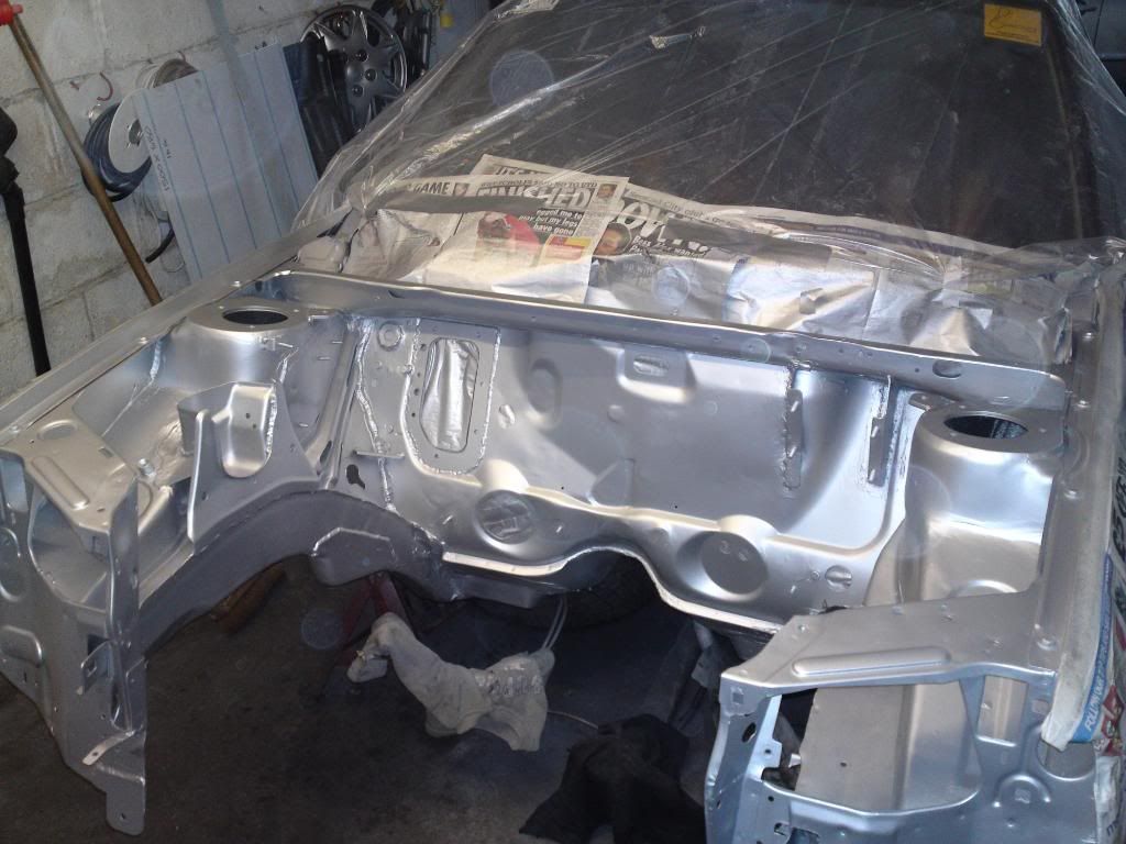

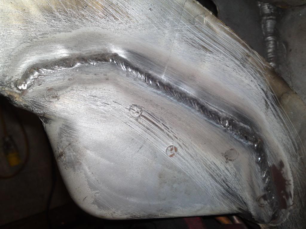

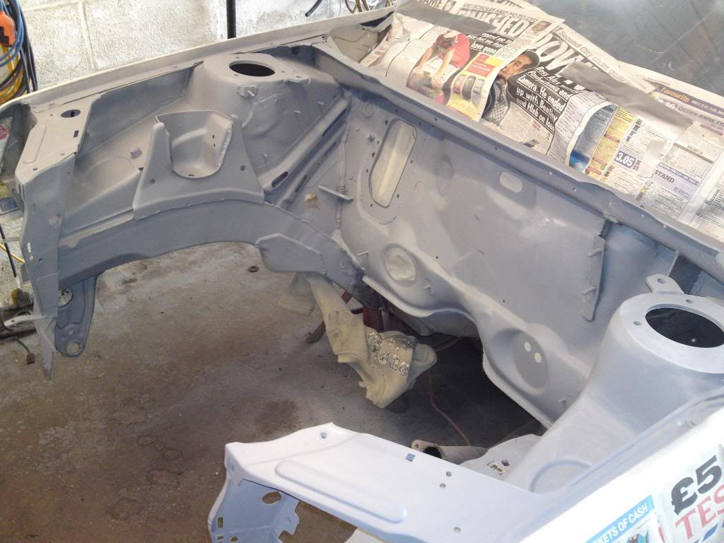

Once happy with how everything fitted i removed the engine and stripped it down, seam welded the bay and filled all the unused holes in the bulkhead
Primed
Painted and clear coat
Inner arches Razz

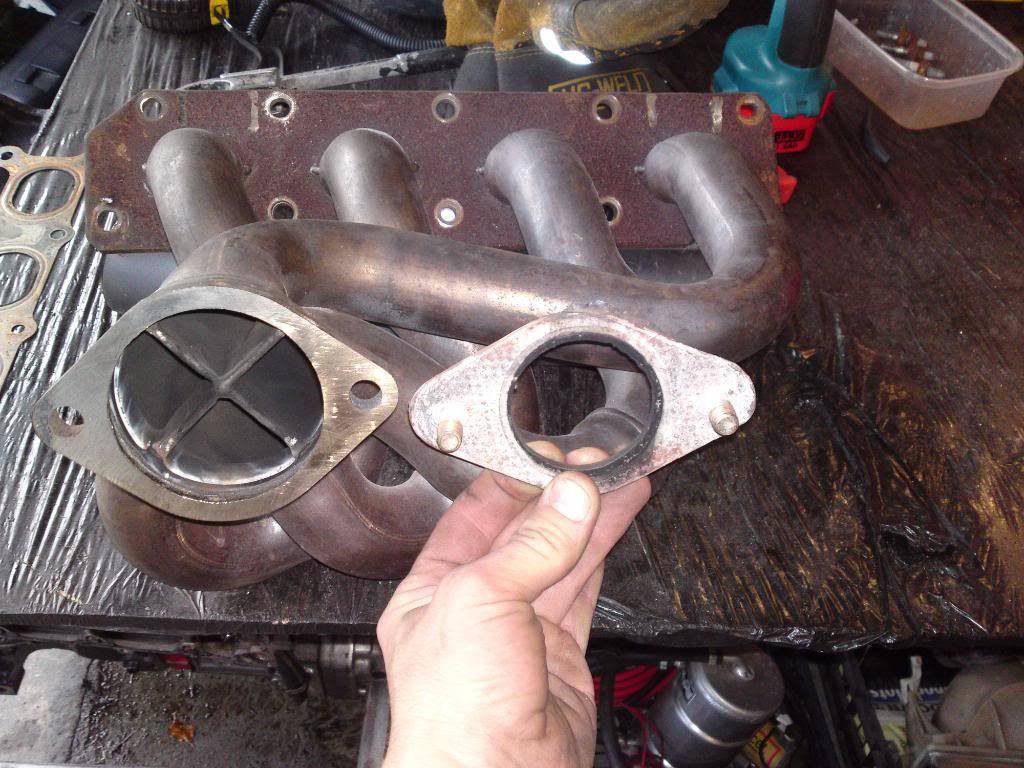

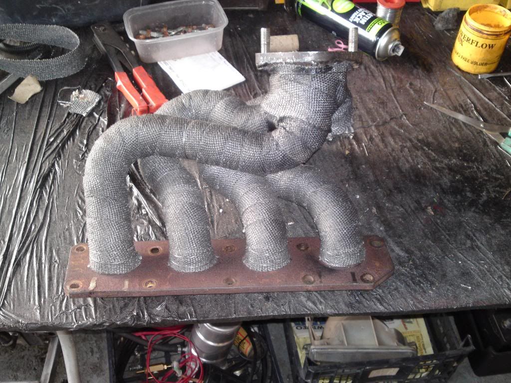

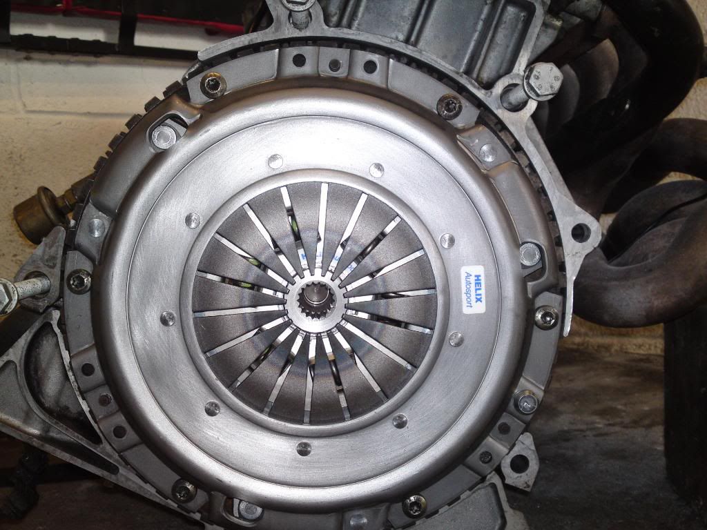

While i was busy with all the fabrication and bodywork i sent everything away to be blasted and poweder coated. All parts have been re-fitted using stainless bolts Thumbs Up
The 206 Gti 180 exhaust manifold is a work of art standard. When we first did the conversion it was running a 2.25" exhaust so thats what size flange we used. Im now changing that for a 2.75" so off with the old and on with the new...
Wrapped

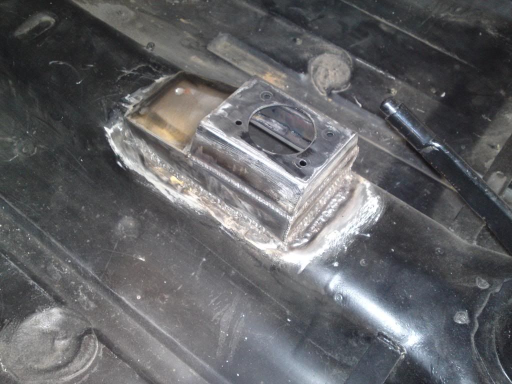

When we first did the engine conversion i fabricated a small box to hold the gear selctor box. The selector boxes are pretty bulky and i needed more room in the tunnel for the new 2.75" exhaust so raised it up as high as possible

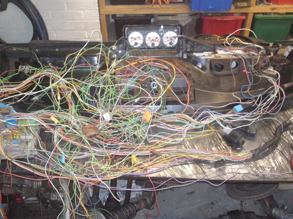

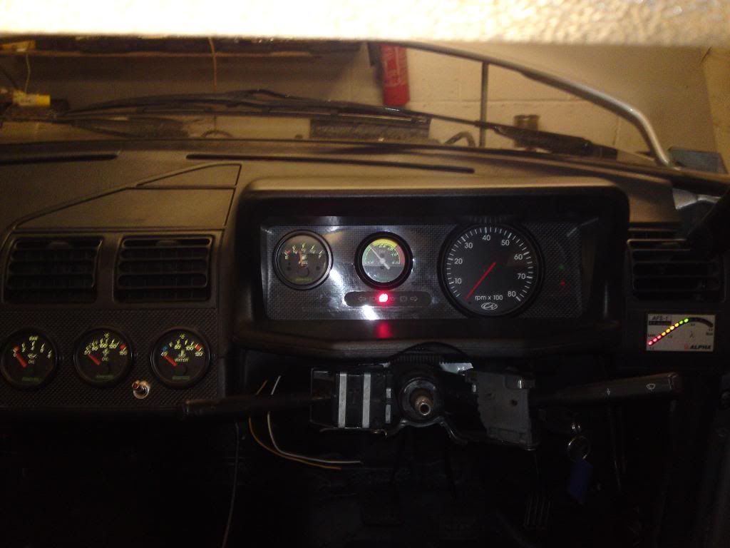

The car doesn't run any of the original instruments so i ripped apart the loom and cut it down to the bare minimum. Managed to fill 2 shopping bags of excess wiring so a good bit a weight off
