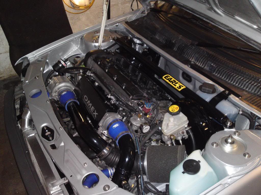

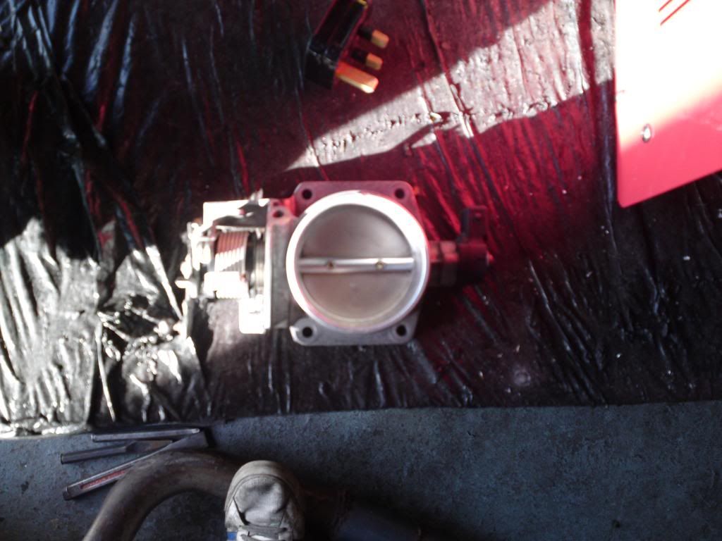

Here's the 75mm TB im using, its from a 3 series bimmer. Had to trim a few bits down and also modify the spindle to accept a vauxhall yoke. I like the vauxhall cable because it has a push on ball fitting instead of the bike brake type end. Also a vauxhall vectra cable was perfect length. I cut the top part of the vectra pedal off and welded it too the 205 pedal for a OE fit

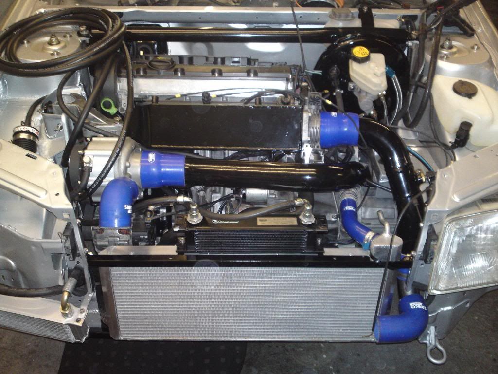

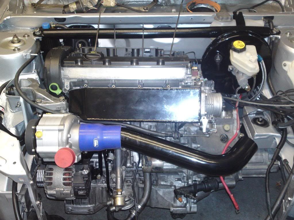

Engine back in
When i was happy with all the wireing i fitted the rad, oil coolers, boost pipes and all other parts.

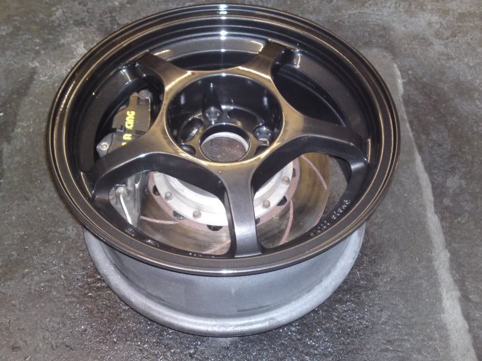

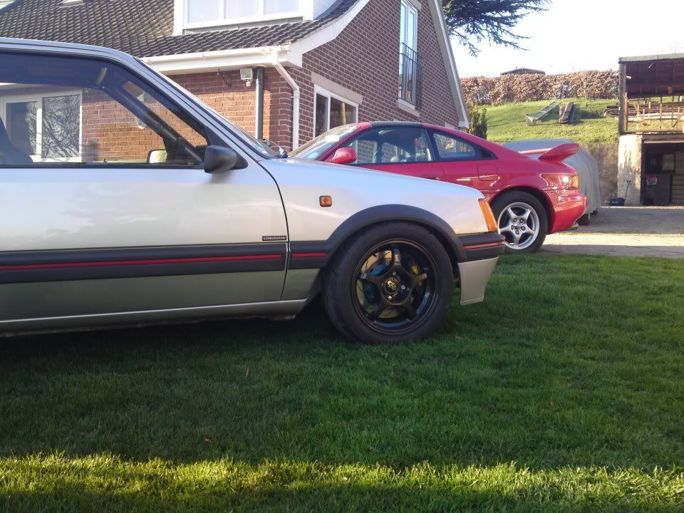

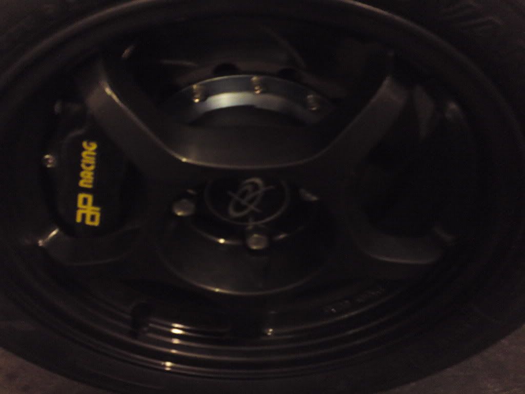

Decided on a graphite grey colour for the wheels, they needed a refurb so did that be for fitted the new tyres. Also tried my new AP's for size behind the wheel to check clearance.....tight!!!

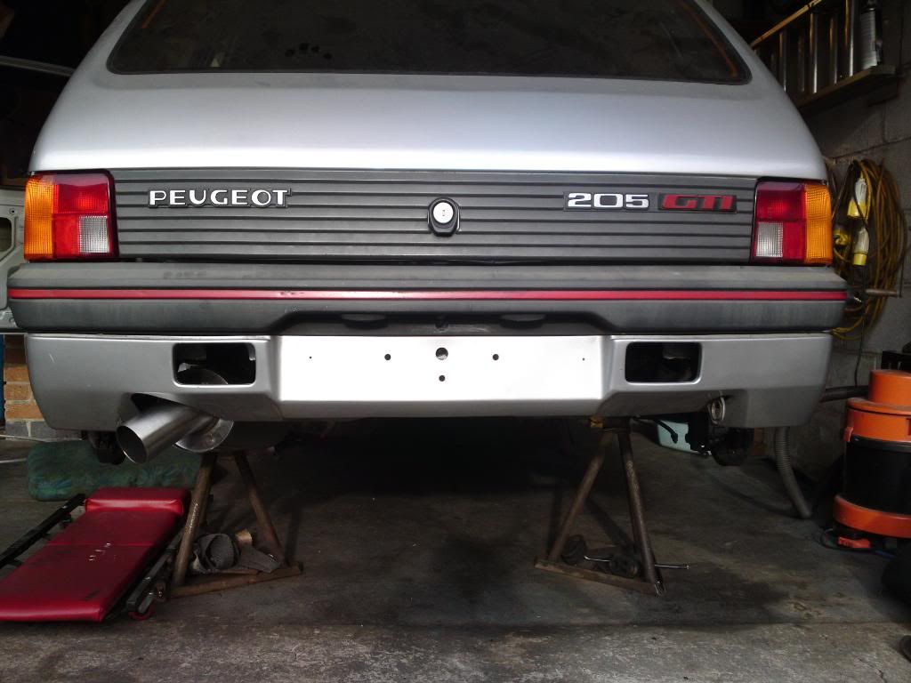

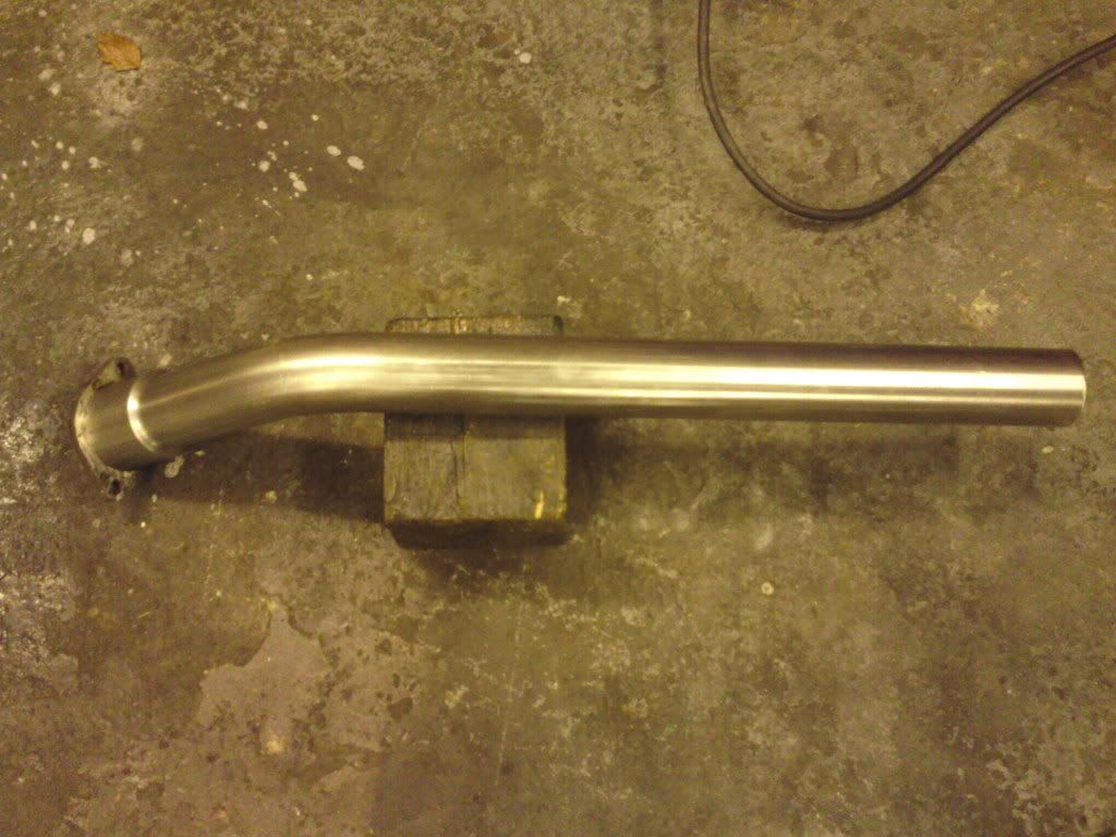

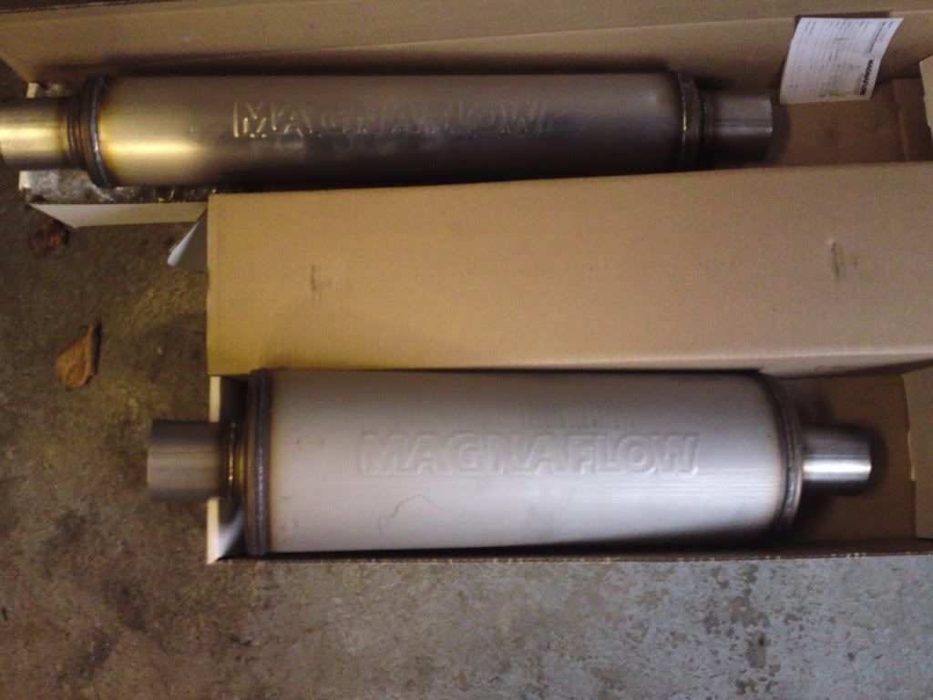

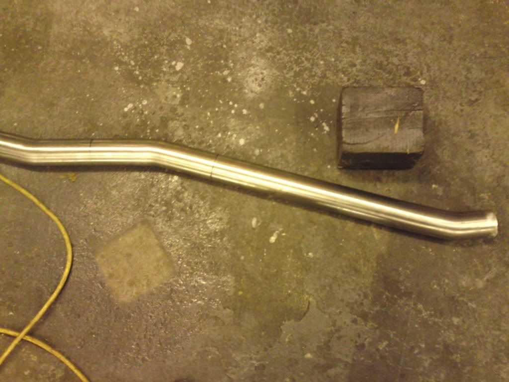

The first exhaust i made was too loud. I could of altered it but decided to start again from scratch using top quality silencers and mandrel bends.
