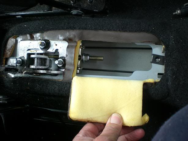

"Do I have to turn the nut at the right hand side to slacken?"
This is a handbrake cable adjuster.

the above picture is the cable adjuster, it will hardly make your handbrake better just use less clicks to pull up
there is a adjustable rod that goes between your 2 shoes and turn the nut one way to spread the shoes slightly which will adjust your handbrake up and better
For the side thats tight, first id make sure the wheel cylinder is ok, that the pistons push back into it and come out freely, because the drum shouldnt be tight to get off, this is the squeeky problem.
if it all seems ok then slacken off the adjuster on this side.
You need to slacken it in order to get maximum freeplay on the shoes to make it easy to get the drums off and back on again. That's the problem Jaeger was experiencing. The more worn the drums then the more slack you need because of the ridge created by wear. Forcing the drums off can do major damage to shoes and retaining springs when all that was needed was to back off handbrake cable adjuster
Once the drums are off then you can back off the self adjuster rod between the shoes if necessary. Once everything is reassembled and the self adjusters have been allowed to ratchet up again then you retighten the handbrake adjuster to get the right amount of handbrake movement
