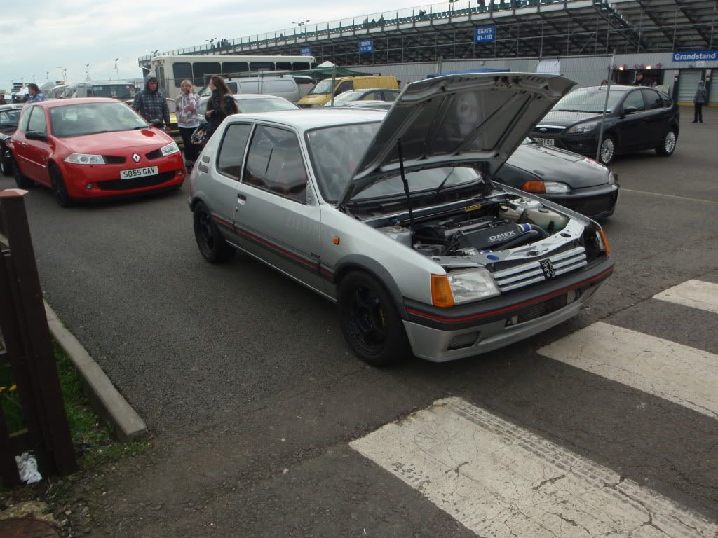

Here's a few pics and vids from the cars first proper test day at Santa Pod. I managed to pull some good times, was averaging low 13s but my best was a 12.7 @ 117mph.

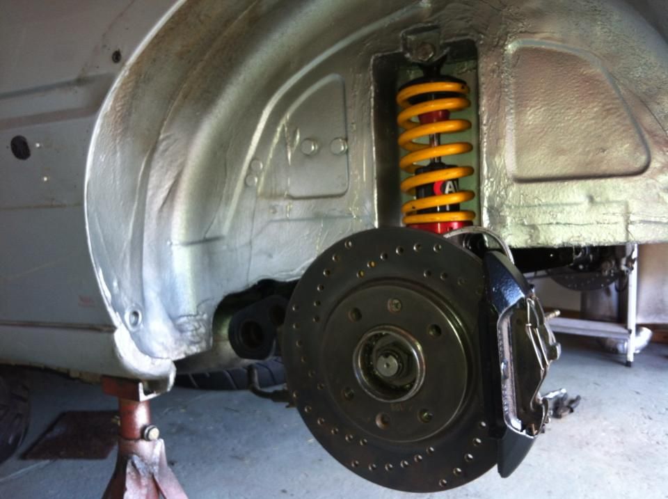

The car was running 320 bhp when mapped but had the potential to make a lot more!. With the engine internally standard this was always going to be a test to see how far i could push it. I decided to up the boost and rev limit and it made 374bhp at 12psi (got to love high comp and boost Laughing )
Next up is a rear coilover conversion. Many benefits over torsion bars, easy ride height adjustment, options of spring rates, 1-1 damper ratio and save a lot of weight!!

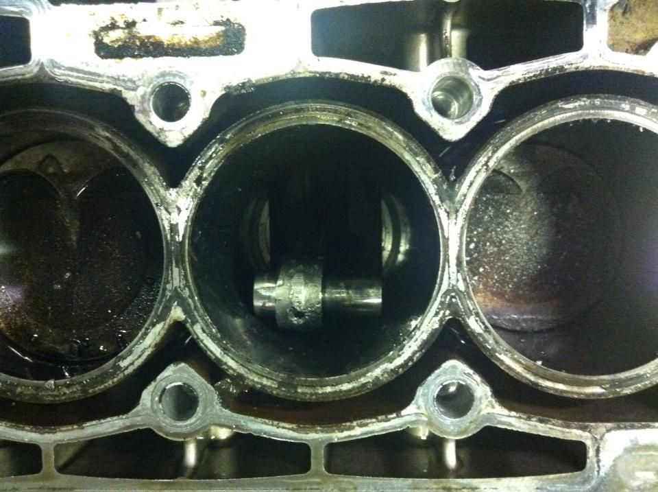

On my last trackday the engine started missing and ran very rough. After checking all electrics etc i did a compression test and found no comp on cyl 1. At first i thought it was the head gasket because i put a camera down the spark plug hole and all looked fine. After pulling the head off i found 1 slightly bent inlet valve??. I can only put that down to high revs and unreliable hydraulic lifters and vvt system.
The recent problem has helped make my decision on which direction i want to go on a new forged engine. Original plans were to build a forged bottom end with standard head as they do flow well. I'm now going down the route of fixed cams (remove vvt) solid lifters, stainless valves etc.
