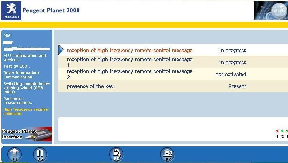

Thanks... my problem is that I'm also not sure that the car side is OK: live data in PP shows no RF signal is recognized while I was pressing buttons from different remotes, not even as not identified signal. So just to test it, £67.14 seems a lot...
<<-- click on thumbnail to view the original size picture
Thanks everybody for all answers so far. Do you know if it is any way to test if the car is OK, before buying a virgin fob?

To check if the car is receiving and capable of receiving signal
You need to go into the com 2000 screen- look at the tree on the left in the pic here to find your way there
When you press a remote button- either lock or unlock- then the description should change from "not activated" to " in progress" for a few seconds whilst it's being interrogated, even if the key doing the asking is totally the wrong key. If you see that happen then you know the receiver is working and getting a signal which is what you're after
If nothing on screen happens then it could of course be either the remote not putting out or the car not able to receive but as your car has decided the remote battery is good then it is receiving a good strength signal

Thanks for the hint!
I was in this menu but I presumed that "activation of reception" is a setting, not a status:
I'll try again to press on a remote button while being in this menu to check what's going on.
Thanks !
