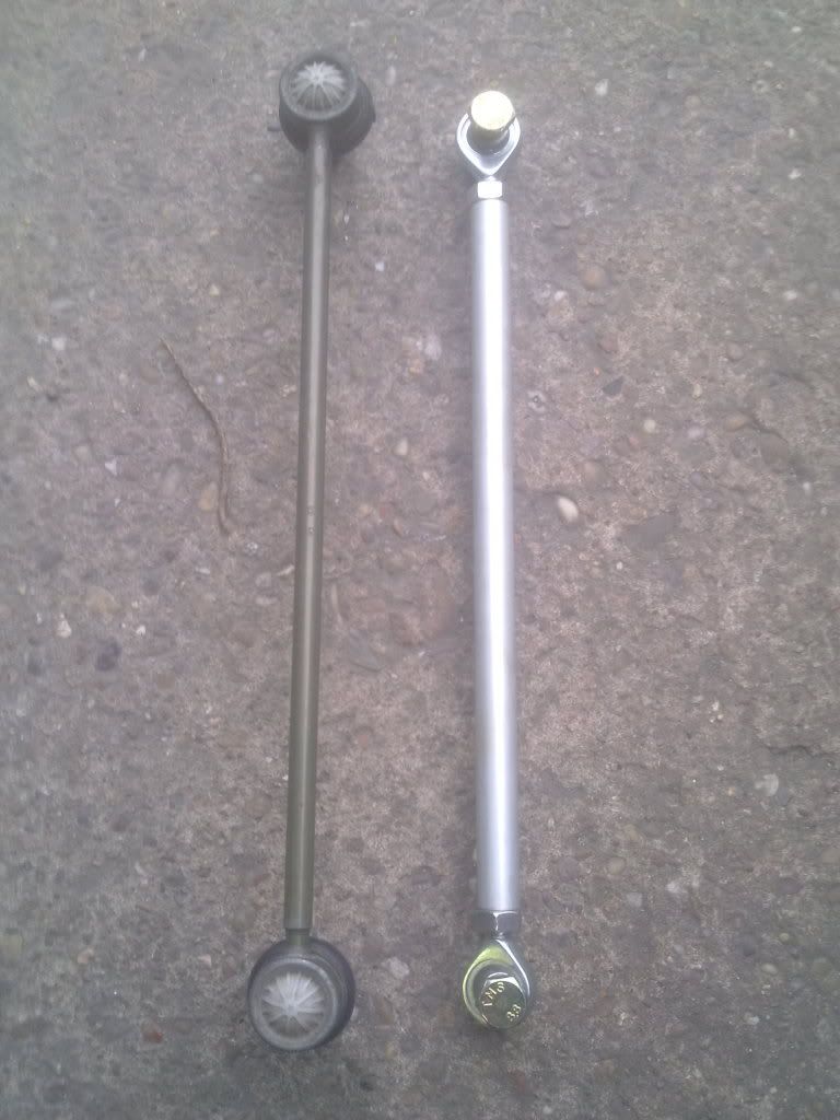

Anyone know of any other manufacturer of adjustable drop links other than Whiteline? Not too bad at £130, but I am sure some of that is just for the name...

PostPosted: Tue Jun 05, 2012 5:28 am Up
thread rod+rose joint is the answer Laughing
just get the measure from the old drop link then here we go
sometimes the simpliest of ideas are staring you right in the face... Laughing
Cheers seabook

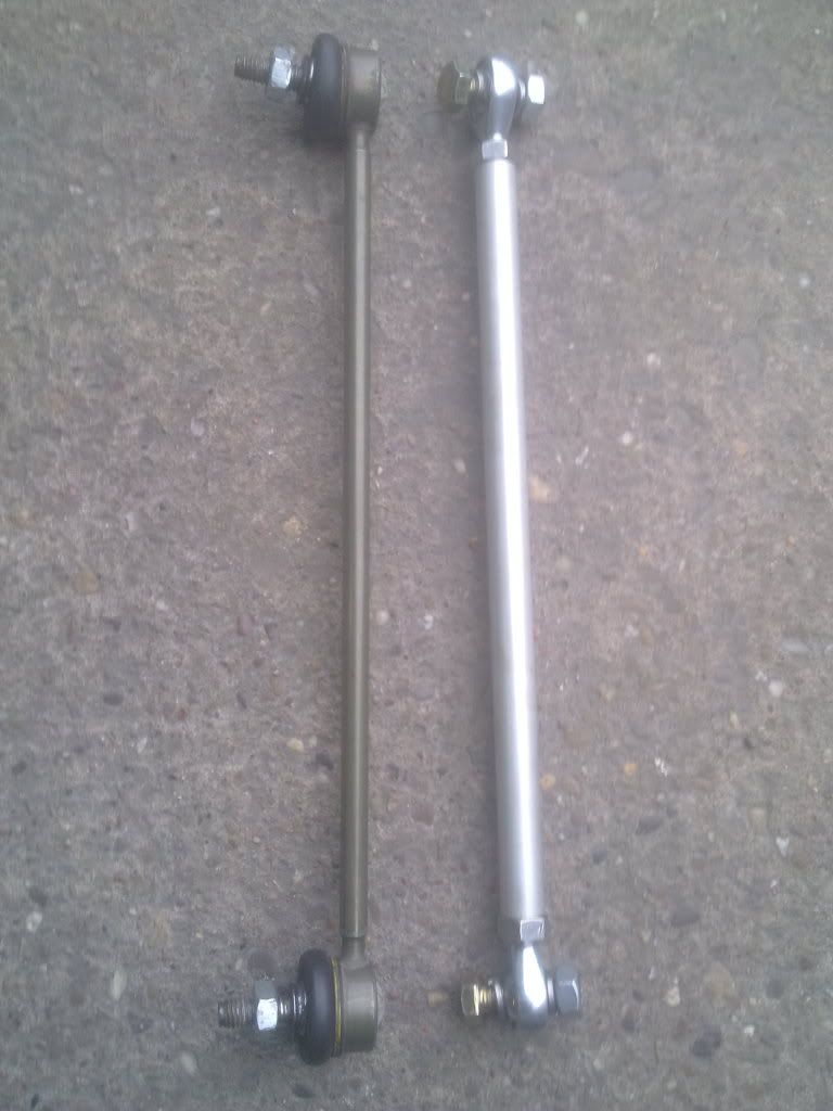

I made my own rose jointed drop links like seabook said. I’ve got some pictures if you want.
Sure thing... would be good. I have got a bearings compnay on my doorstep here in Ashford, so I may pay them a visit tomorrow. Need to find some end threaded rods rather than a full threaded rod. The rose joints dont seem to be a problem.
Sure as hell not paying £130 anymore.. Sorry whiteline Smile

simpsonrc
PostPosted: Tue Jun 05, 2012 10:17 pm Up
Joined: Jul 28, 2010
Posts: 133
Location: coventry
[img]
[/img]
[img]
[/img]
[img]
[/img]
I thought I had some of the separate components but I can’t find them
SinfulDesignCom
PostPosted: Wed Jun 06, 2012 7:26 am Up
Joined: Apr 03, 2010
Posts: 455
Location: Ashford, Kent
thats exactly the stuff....
thank you - am sure this will help searches in the future too
