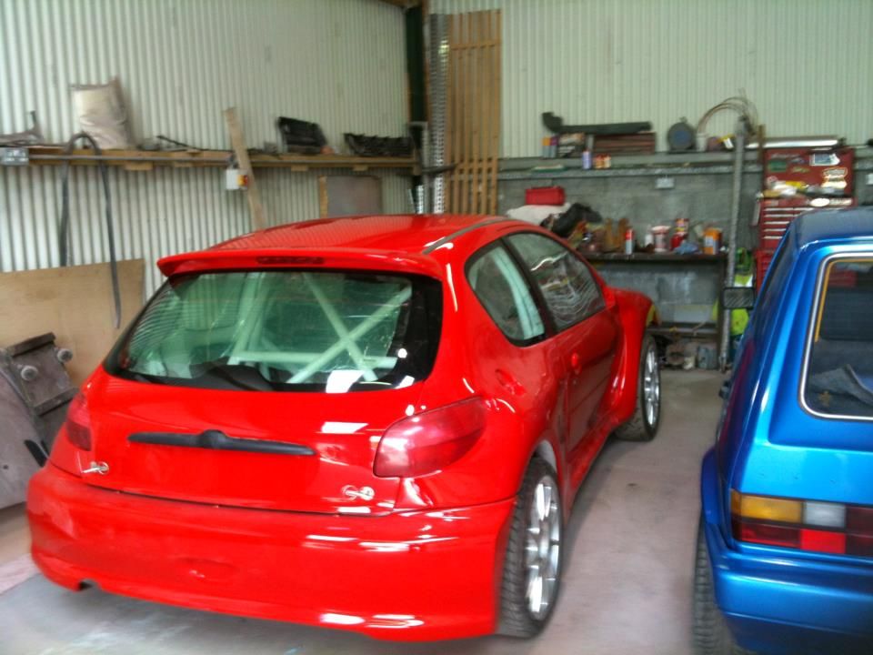

Just a small update, the eagle eyed among you may have noticed after i painted the side of car i had 2 different shades of red Sad
the orignal colour i got around 3 years ago and supplier has gone out of buisness so i needed more paint and new supplier tells me there was only 1 shade and orignal paint was wrong colour for the code.
I was never 100% happy with 1st shade as i was expecting it to be reder(if thats even a word)
anyway long story short couldnt get a match for orignal paint so ended up repainting doors,roof and boot here's a pic from today finally all the same shade of red was a bit of a setback but looks a lot better Laughing

Wow it almost looks a light candy red I'd be very happy with it now.

cheers yea happy with it now was gutted when i fitted doors n realised it was 2 diff shades
Need to get bodywork finished and on to engine & gearbox builds

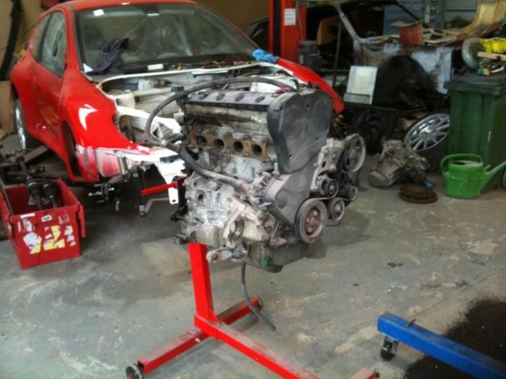

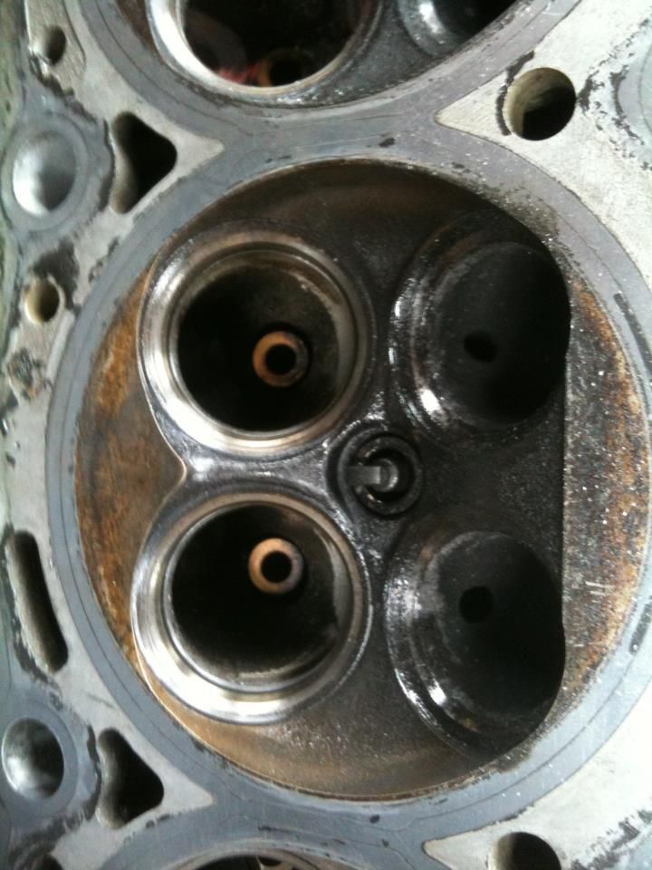

PostPosted: Sat Sep 01, 2012 4:36 pm Up
Joined: Feb 13, 2010
Posts: 89
Location: Ireland

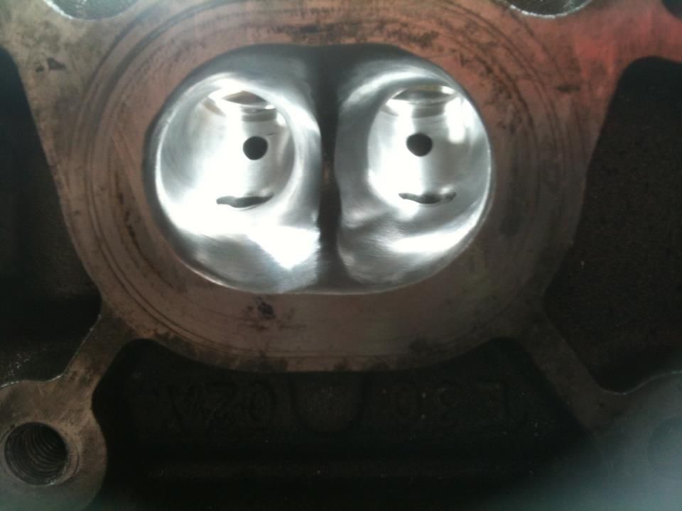

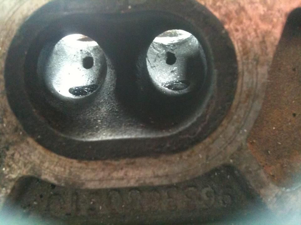

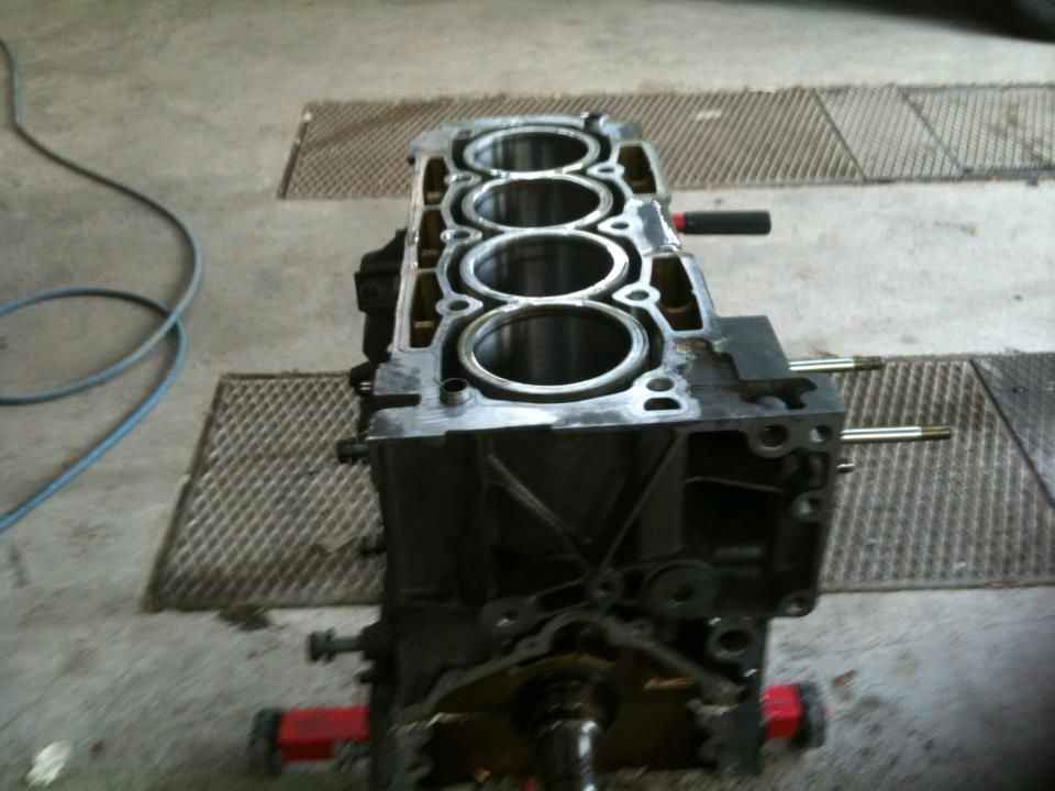

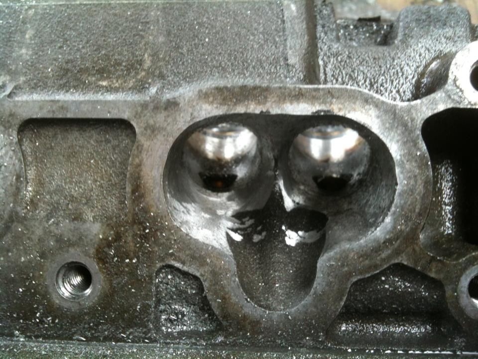

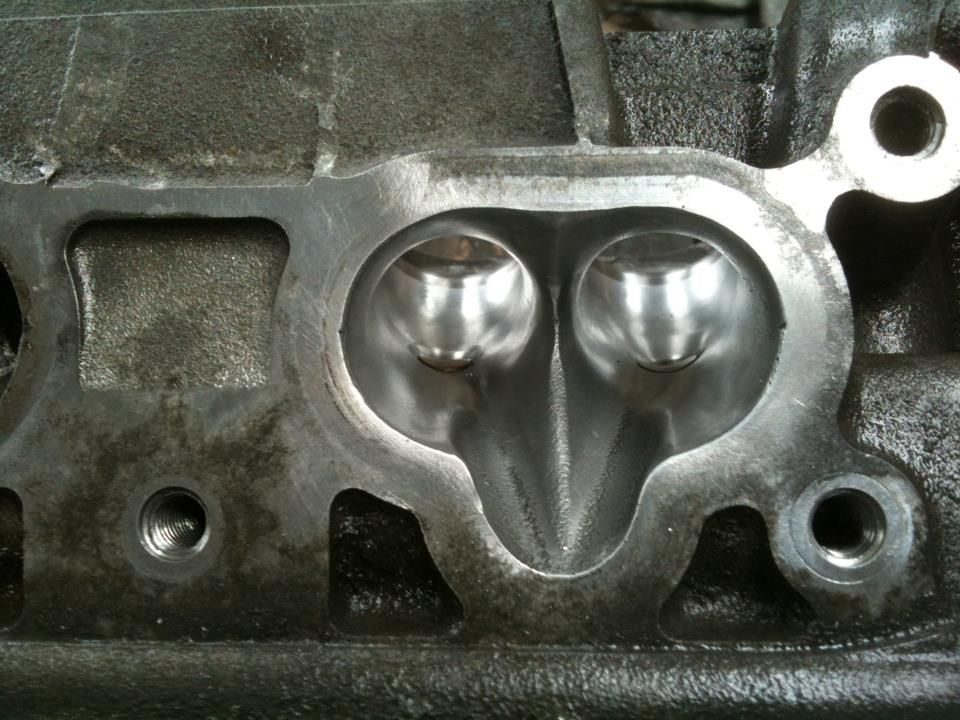

have a few days off from work so started the engine work stripped engine & started porting & polishing cyl head & manifolds its a slow process of lots of measurments but hope to have all porting finished by monday eve
Heres a few pics of progress not much to look at but bit of a update Smile

PostPosted: Sun Sep 02, 2012 3:52 pm Up
Posts: 901
Location: Istanbul / Turkey
Nice progress Brain. But your inlet ports looking small to me. Which inlet system you will use.
I think you need GTI180 inlet manifold gasket for measurement and port match.
