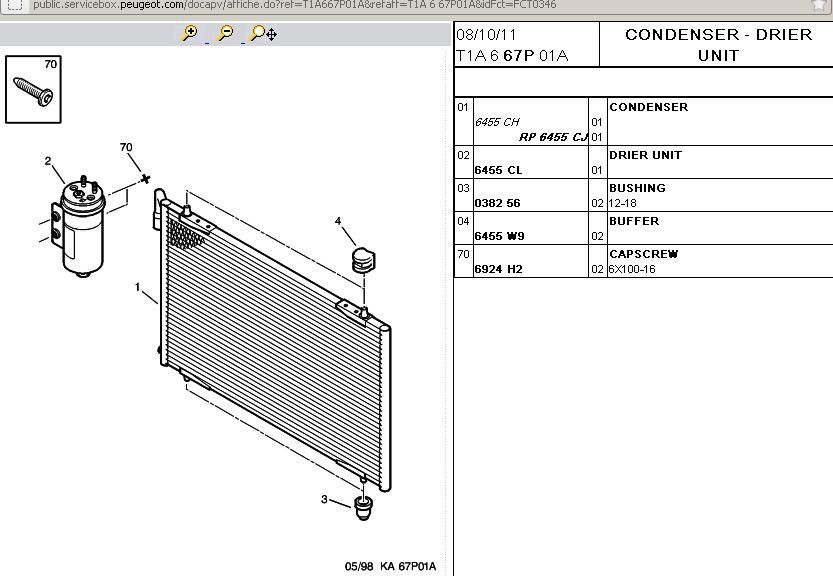

The condeser strictly-speaking is item 1 on the pic which we all call the air-con radiator.
Item 2 is the drier unit (like a cylinder) which contains desicant to absord moisture from the
gas circuit and should be replaced every 5 years in a perfect world.
In any case 500 pounds is a lot of money and I bet the technician is talking about the
compressor underneath.
