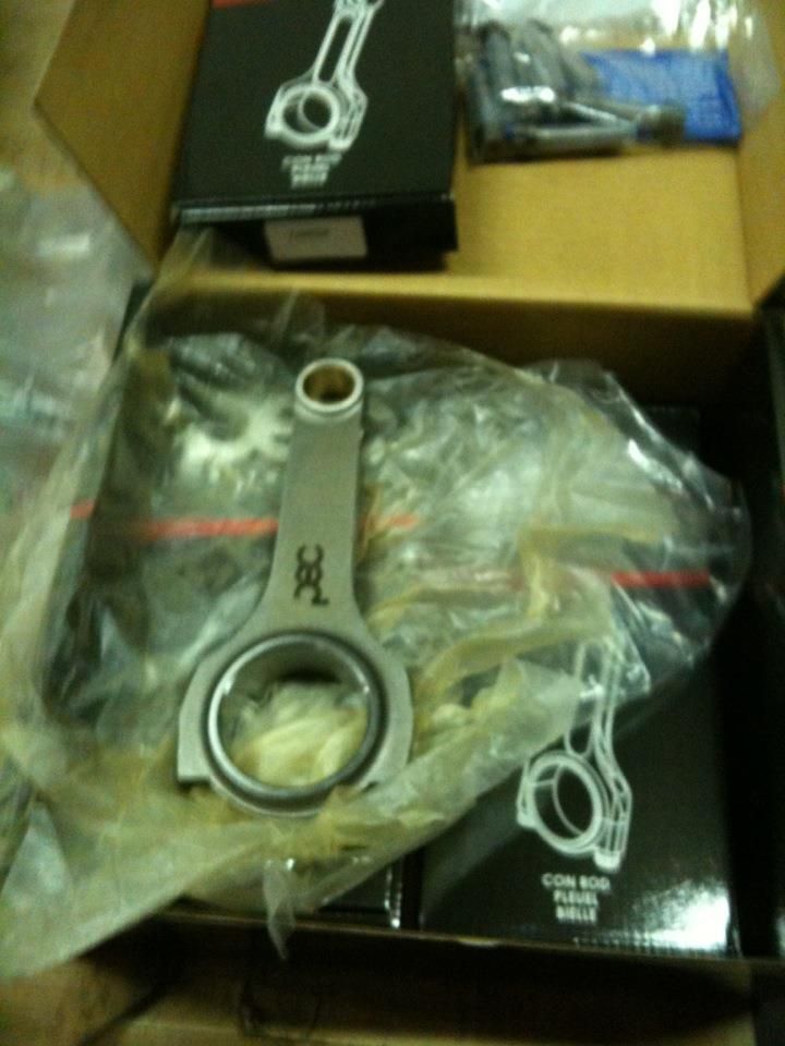

engine build is now on hold issue with my steel con rods Sad
Stupid mistake by me and took too long to get build underway

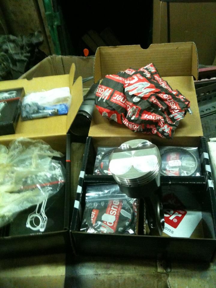

Engine built back on track Laughing

Forge bits look so sexy it's a shame you can't see them lol. Good progress lovin the work.
