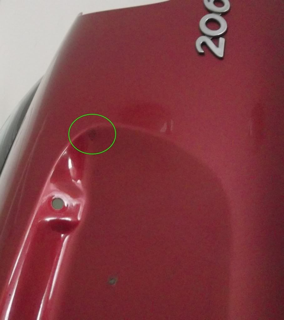

I have applied a layer of touch up paint from halfords [correct code] and it is a lot darker; anyway - never mind that.
How do I get it smooth and shiny without taking off the surrounding paint?
many thanks in advance!

wet sand with 2000 grit wet and dry paper and then machine polish it
