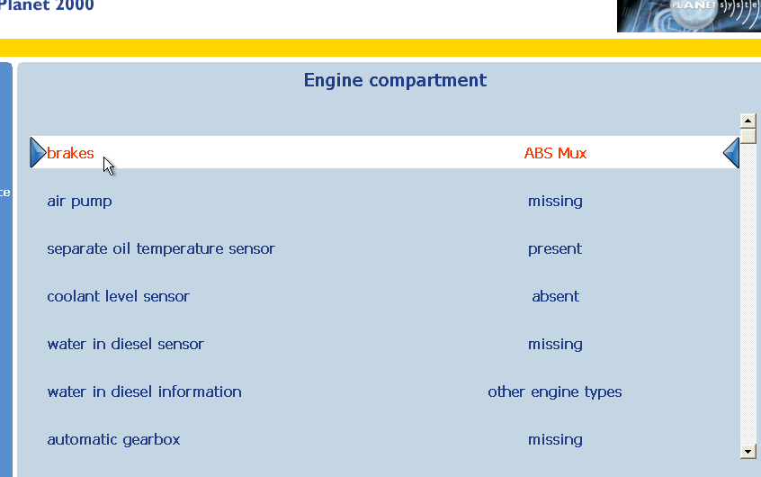

I had a look for you today but all I could find was:
separate oil temperature sensor Present
I can't find anything about the source. If you can point me in the right direction about where you found this setting i'll have another look for you.
It should be 2 lines below...
In this image (in italian) you have
oil level sensor Present
origin of "oil temperature" information BSI

This is what I have. Mine is a 2003 GTi 138 so must be different to yours.
Did you press 'arrow-down' key on the keyboard?
Looks like there could be more settings further down there to me.
Repair safely - Drive safely
pug206lx
PostPosted: Sun Oct 07, 2012 3:05 pm Up
Posts: 838
I did, it only goes down to the last option in that picture
Have you tried sliding down with your mouse pointer? There's a sliding bar on the right...

In any case oil temp sensor is connected directly to BSI module 2.
Since the BSI supplies all data to the cluster via VAN-bus anyway I don't see the issue. Unless you want to measure empiracly as Mr.BSI said and take your pick. Bear in mind, correlation on these gauges is way off, also due to the damping used, which will give wildly different readings compared to PP2000 data esp. until a value has settled for a while.
The sliding bar is misleading on that screen and if he's pressed arrow-down, that's the same thing as trying to move the slider.
