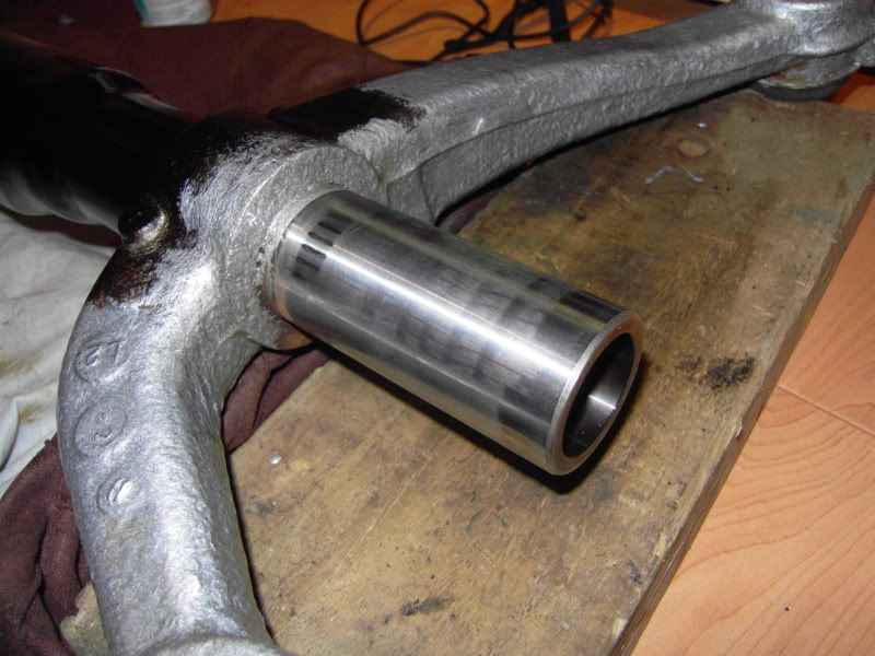

This is how bad it looked.
PostPosted: Sun Oct 21, 2012 12:34 pm Up
Posts: 7047
That is rather rusty which suggests water getting past the seals is to blame for the bearing damage.
My axle wasn't perfect on one side but doesn't show any sign of movement. Somewhat shinier than yours.

PostPosted: Sun Oct 21, 2012 12:57 pm Up
DeeTurbo wrote:
Yeah, that's true but I had already bought the bearings.
waste of time to put new bearings in

Yeah, The seal was ripped pretty bad. I should of checked and re-greased the other side while I was at it.
I'll do it this weekend when adjusting the rear.
