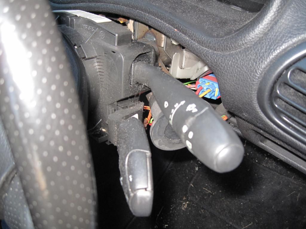

Last night i managed to somehow damage my wiper stalk. It has now gone eally loose and the wipers are now contantly on, to turn them off I have to hold the stalk in the up position. The car is a 55 model, Ive looked on ebay and there are loads for about a tenner but they look different to mine. So I need to know how I remove it and if possible which part number it is. I'm hoping I don't have to replace the whole unit.

i have the one you need £10 not sure if you can remove the wiper stalk i just have the whole comms in my shed
PostPosted: Sun Dec 23, 2012 6:35 am Up
Be a new comm2000 needed. I have heard you can split them down to repair them when the pins go faulty but could be more hassle than it's worth.
£10 for a second hand comm unit is a bargain though. £150 new from ECP.

Put drivers window down and disconnect the battery.Leave the car for at least 10 minutes for any stored energy in the airbag system to disperse. Remove the airbag and steering wheel. Take off the old unit, put new one on (plug and play unless you have ESP) Put everything everything back on.
Reconnect the battery and lean in through drivers window to turn sidelights on to allow the BSI to wake up.
If you don't want to put the window down, it's handy to have a second person sat in the car when you reconnect the battery to turn the sidelights on.

i wouldnt buy one from ebay, it might have that airbag fault the seems to happen to loads of the comms units, pop to ya local scrapy and find a 206 thats airbags have been deployed, least ya will know that that part works fine, but then again, it i remember right you can just carefully lever the stalk out of a removed comms and unplug the small plug and plug it into yours, but this is a pain as if you pull to hard the wire inside the stalk unplugs and its a right b***h to get back in.
