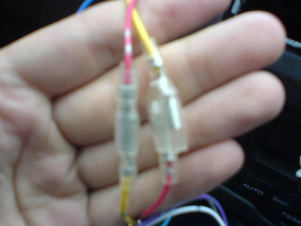

Ahhh just a sec need to find a photo
DeadEyePaul
PostPosted: Fri Dec 28, 2012 5:40 am Up
Posts: 2632
Location: Rugby,Warwickshire
Do you have a connector like this?
You need red going into yellow

reds going to red and yellow is going to yellow. swap them round?
DeadEyePaul
PostPosted: Fri Dec 28, 2012 5:42 am Up
Posts: 2632
Yep
