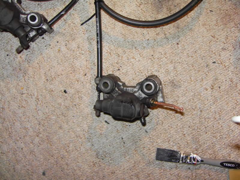

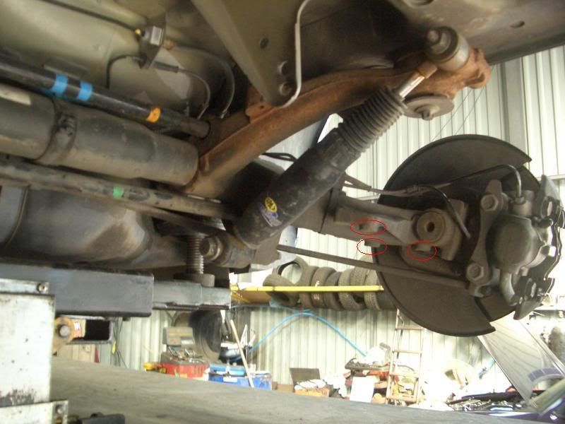

You might possibly be able to see the caliper brand here...

Don't forget, what somebody might call a Bosch caliper could be a Bendix to somebody else as the caliper has two parts.

I'll go by what is cast in the back of the caliper as per your picture.
I'm hoping ECP and CP4L have correctly identified it as a Bendix. I'll try to stick my head under the car tomorrow to see the name on my caliper but thinking about it I doubt it can be read without taking it off.

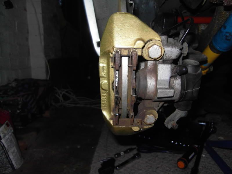

Spot the difference with the handbrake lever.

Looks like the lower picture shows a more pipe shape (circular) handbrake lever/arm.
So are you saying the calipers are the same on these 2 pictures and just the handbrake lever/arm is different ?
