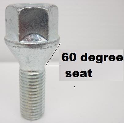

hi can someone please help me out here :/
i need a picture of what wheel bolts i need for fitting nimrods iv been told i need
www.ebay.co.uk/itm/PEU...53f400ceb2
those and someone else told me i need
ecx.images-amazon.com/...84hxQL.jpg
these

I would like to know this also, as I've just purchased a set of nimrods. I think they are the top ones mate as I've been told they need the flat washer. But I'll know this 2morrow as I'm picking them up and will try one out.

Pretty sure it's the first ones. Well when I got a set from peugeot they were the ones with a flat seat and washer.

its the first ones you need , the second one's would rip thru the alloy Wink

Yep first ones. Flat type.
