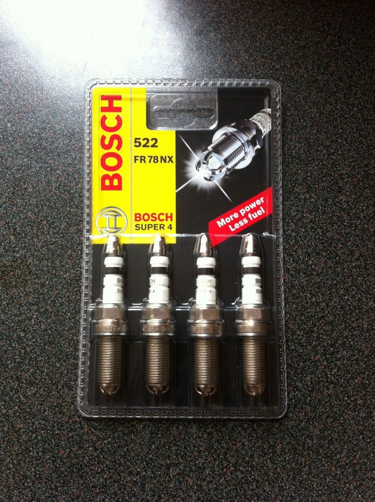

I've got a set of brand new Bosch Super 4 spark plugs from when I had the XSi and was wondering if the spark plugs are the same as the ones that are in the 180s..?
I've noticed the part numbers are the same as the XSI and GTi engines. Which is why I'm wondering if they'll work on the 180.
Ideally a part number from a 180 set so I can match them up with the XSi set would be great.
If anyone has this, please let me know Smile
Thanks

Apparently, Bosch do do (yes I said do do) a Super 4 Spark Plug for the 180... found this pic on another thread.

thats correct uz, 522 is what i used in my old 180. email them they will tell you its correct as i did the same

Thanks mate... I'm pretty sure the XSi is 522 as well. If it is, I've just saved my self 20 odd quid which I can use on other bits for the service.

Yes the 1.6 16v and both gti and 180 use the same plugs, for some strange reason bosch dont list them on there tech sheets

Just found the set I had from my XSi and match the part numbers off the picture and the spark plugs themselves and they match. Nice little saving. Happy days when I picked them up from Halfords for £5 due to clearance (old packaging).
