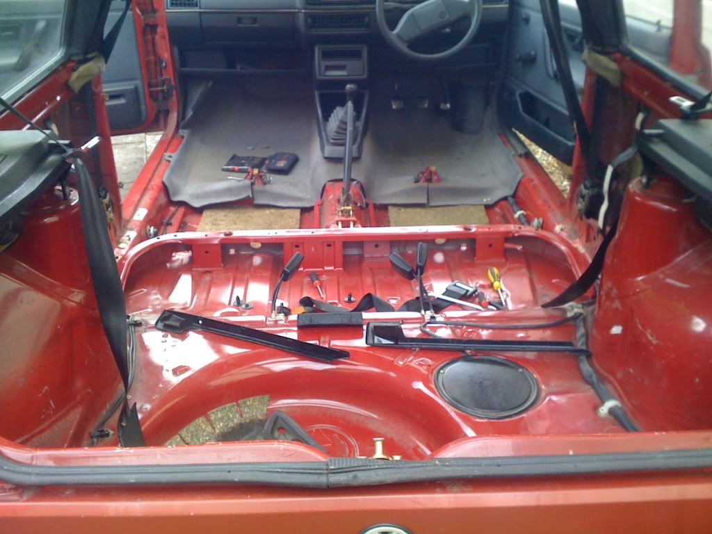

First job i decided to do was strip the car down and fully check the car over for rust/dents and generally anything to repair.
Interior Out

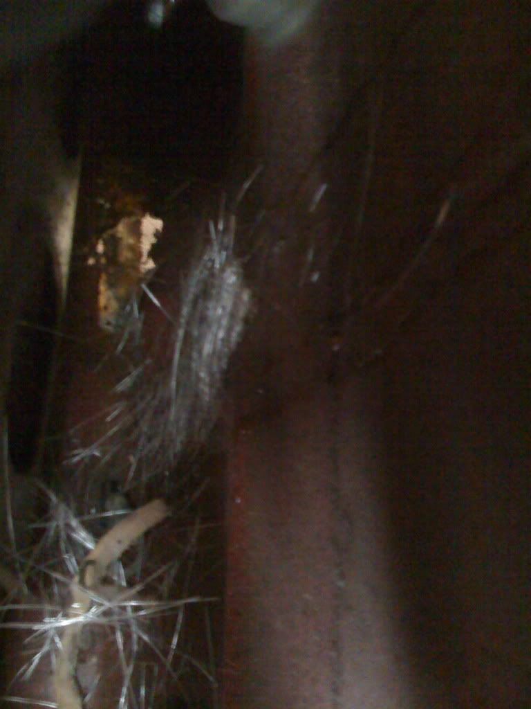

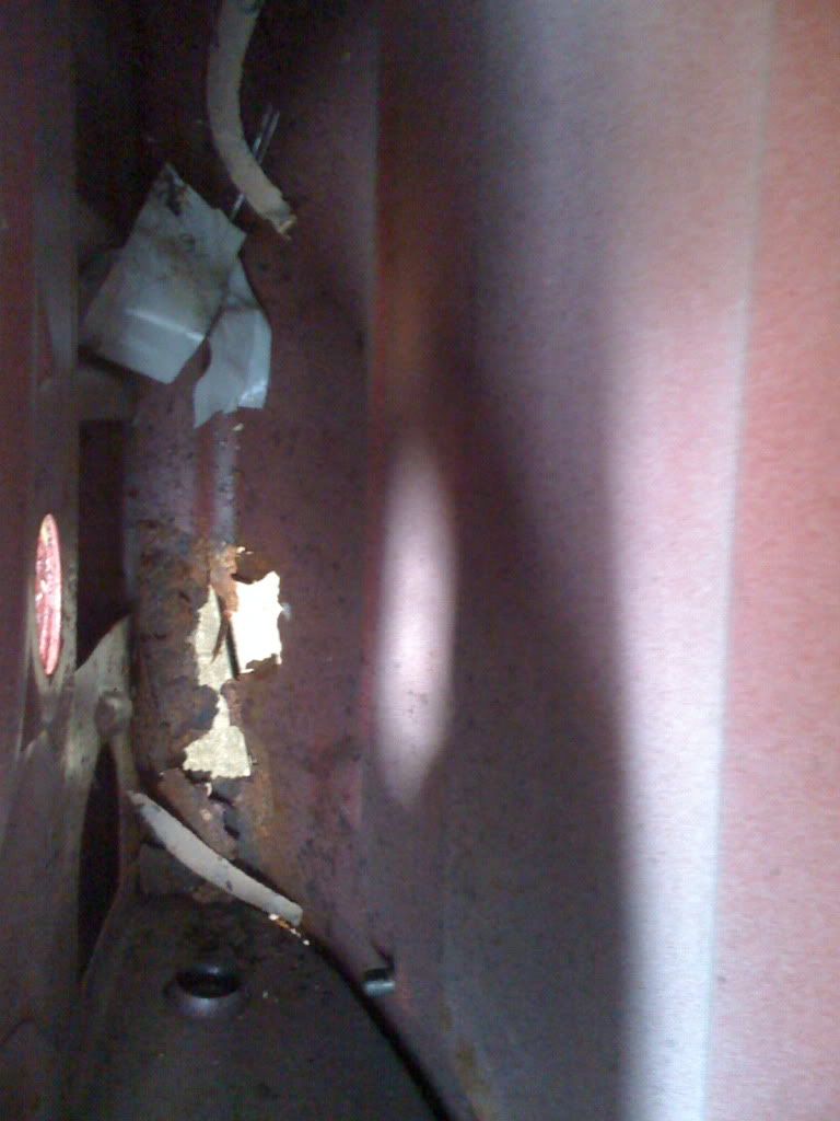

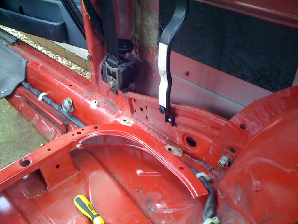

As you can see from the first photos the car is in good condition which tbh i was surprised by i was expecting to find something with the interior removed such as surface rust etc.
the only rust i have found so far is in the drivers sill and underneath on the chassis, which i will be getting welded up ASAP.

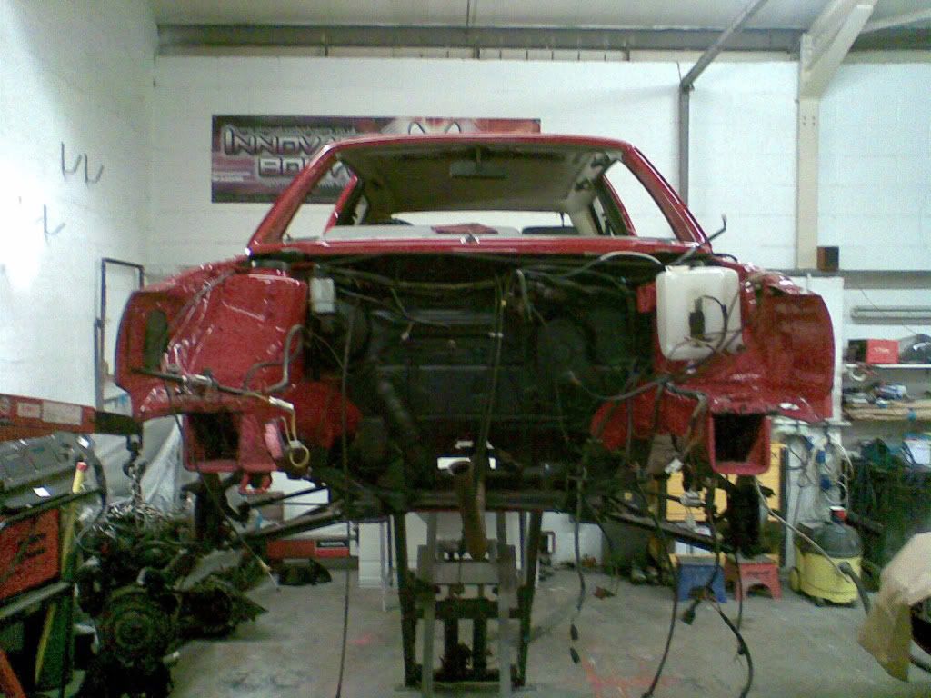

Went up to work on the golf today and sort the front & rear brakes out. However that was a nightmare as everything has ceased up pretty much thank god i purchased pretty much everything new lol.
Trying to get the bolts out is a killer and is going to take a few days including refurbing the parts i'm keeping and repainting them hammerite black.
Its also having two new wings now due to rotten arches, cheaper and easier in the long run.
Got a few photo's of the progress today below for you.

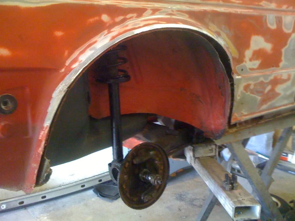

The car has the new drivers sill and drivers rear arch welded in place and the drivers rear quater/side has been attacked and all the little dents/dinks/imperfections are not far off from been compeleted. I have made some new small sheets to repair so of the small areas that have been discovered and don't require new panels which have been welded in place.
I left the car looking like the below tonight....

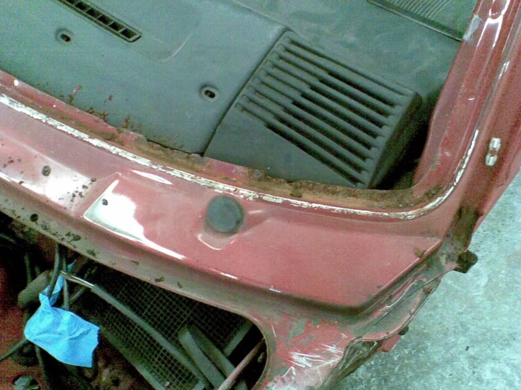

a couple more photo's of the golf now fully stripped of doors/glass/bootlid etc. you can see the extent of damage caused by the rot from the roof/door seal, this is going to be cut out and lead filled to make sure the strength is still in the A pillar. Also the front window lip needs a small amoutn of lead loading which i am glad about has been found now while all the work is being carried out.

So with that sorted and finally getting to the bodyshop to continue the build up of the golf an hour late. I speak to my mate(owner) to find out the sump p**sed oil all over the floor last night meaning the sump still leaks what an epic fail and waste of time yesterday
So i got the car turned round and back on the ramp, stole the engine hoist and got my little table/bench setup with the tools needed and set about pulling the engine back out. Now i'm getting good at this engine removal/refitting malarky Laughing so had the engine drained/disconnected and out swinging in the air within 30mins.
I set about stripping the gearbox/driveshafts which wouldn't part from the gearbox so had to come off in one. The engine is now waiting on the hoist till tomorrow morning when my new sump, gasket kit and sealer arrive for fitting. Was expecting a major bill of £100+ so half expecting to roadtrip it tonight for a GTI enigne lol. Ended up paying £45 for eveything i need.
