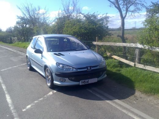

Hi last nite I was driving around and all of a sudden there was a horrible noise from front passenger side sounds like a flat tyre so pulled over it is not flat so I checked under car nothing loose I can see but alloy wheel bolts were loose any body has this or no why. The car is 206 gti y reg
