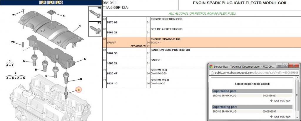

Thanks for the reply mate, I didn't think the date mattered as its the same engine (tu5jp4), this is what Service-Box has to say:
PostPosted: Mon May 27, 2013 8:25 am Up
Try Bosch number 0 242 229 797

PostPosted: Mon May 27, 2013 6:54 pm Up
Posts: 2949
Location: Athens, Greece
FR8 SC+ only.
( bosch-automotive-catal...eCountry=1 )
