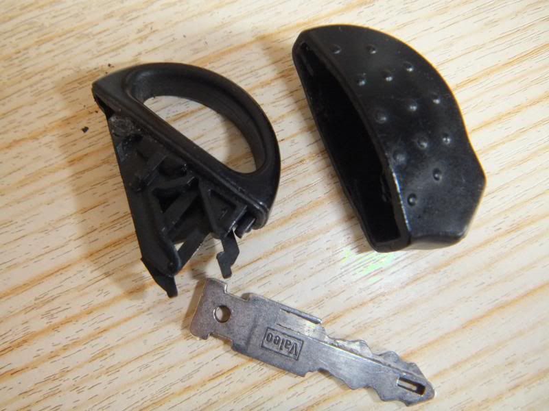

Hi all i have mssg this £60 an hour diagnostic expert asking for some money back and he sent a message back saying:
"Hi, there must be a fault with your system, otherwise I would have been able to do a fault code read and it would of told me there was a problem with the key, and also there should be a key symbol on the dash if there was a problem with the key"
So now i have photo'd the offending key if someone could please confirm the chip is not in there? and is he making excuses for not doing a 30 second manual check? thaks for the help and advice thus far
PostPosted: Mon Jul 01, 2013 12:03 pm Up
Posts: 11531
No 206 has a key warning light on the dash.
He should of checked for com's with engine ecu to check immobiliser staus.
PostPosted: Mon Jul 01, 2013 12:20 pm Up
Posts: 11531
Here a picture of the chip next to a screwdriver bit so you can see how small it is Laughing
